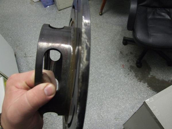

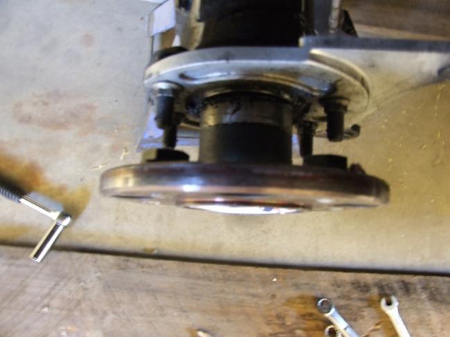

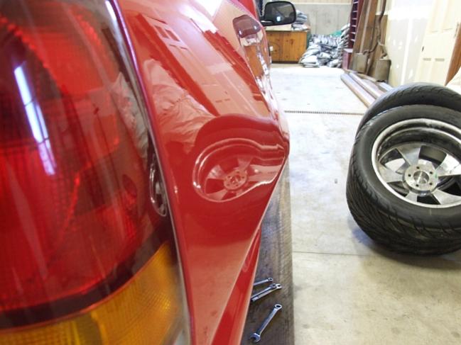

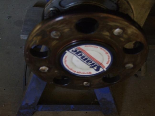

Long story short....this is what happens when you make 744rwhp, have very sticky 16" wide tires, its 90+ degrees out, you know you haven't set the shocks up yet and the crew of food networks diners, drive ins and dives wants to see a huge burn out. Wheel hop + a horribly paved road + my dumb *** =
Attached Thumbnails Project no more wheel hop!!!!!-rotor.jpg   Project no more wheel hop!!!!!-stud2.jpg   Project no more wheel hop!!!!!-studs1.jpg   Project no more wheel hop!!!!!-wheel1.jpg   Project no more wheel hop!!!!!-wheel2.jpg

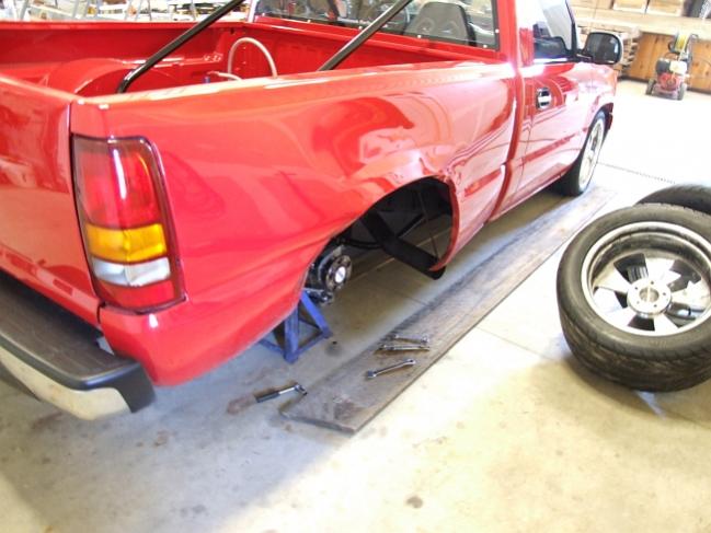

more pics
Attached Thumbnails Project no more wheel hop!!!!!-bed1.jpg   Project no more wheel hop!!!!!-bed2.jpg

man you really did a job on your bed matt sorry to see this didnt you just get the truck painted? man cant beleave you sheered those studs right off. did you ever get a chance to run it at the track with the slicks yet atleast before this happened?

As far as the fix....new 1/2" studs, one new rotor, and have DMC Racing set the load on the 4-link. As for racing, I have a 2nd pair of 40 spline axles with 5/8" inch studs so I will switch them out and run those at the track.
I really can't be pissed this happened. **** is going to happen with a truck that runs a full spool, 16" wide tires, makes over 700rwhp on its LOW tune and is driven on the street very, very, very hard.
