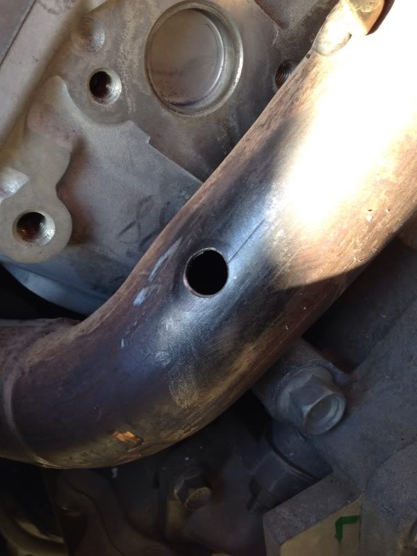

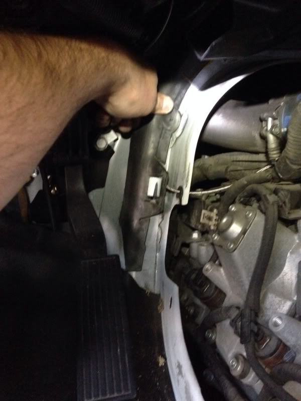

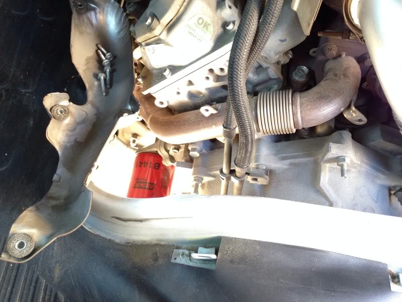

So got another thing checked off my ToDo list. Got the Pyrometer installed.

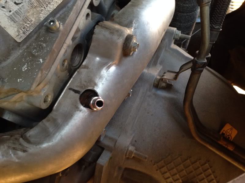

Pulled the interior and Dog-house out and decided on using the drivers side up-pipe. Options were to drill and tap the cast manifold or weld a bung on the thinner walled up-pipes. Since I was doing this at a friends house and he had a welder...up-pipe it was since it's easier to get to.

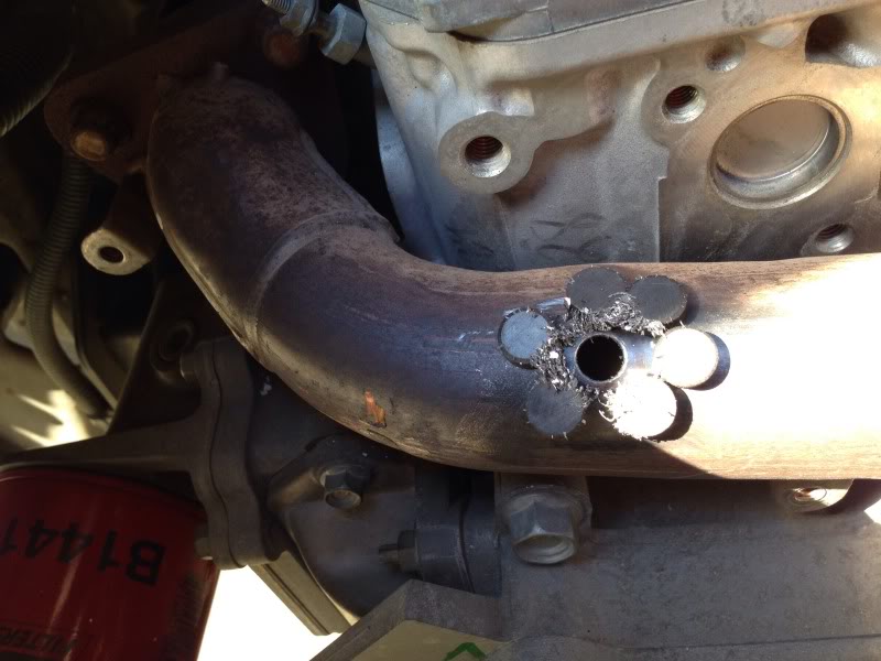

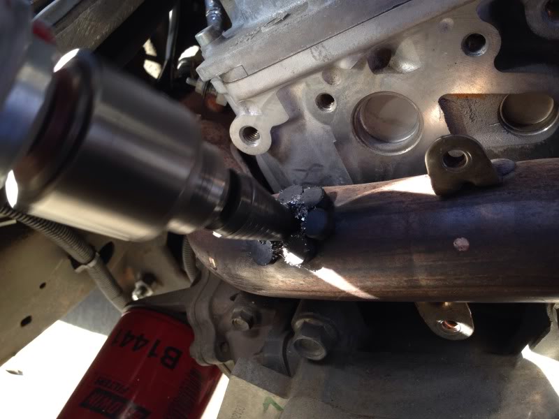

I thought of using Grease and or a Vacuum but decided on using magnets to keep as much of the shavings from dropping inside the pipe!!

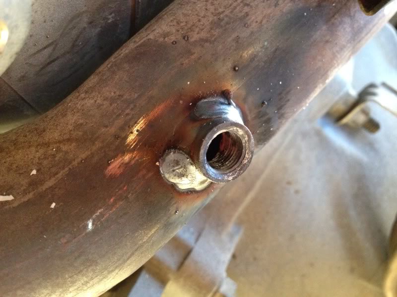

One Bung welded on...

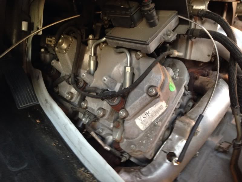

Hooked up the pyro sensor,
MacGuivered the wires into the Cab with a makeshift grommet and using exsisting bolt holes which I have no idea what they are used for...

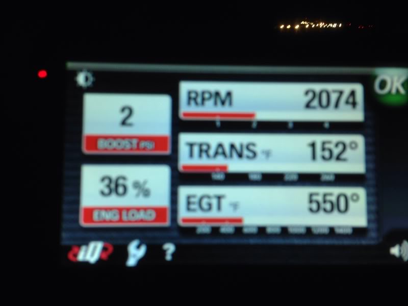

And then Voila, EGT working properly.

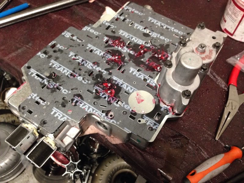

So another small update...

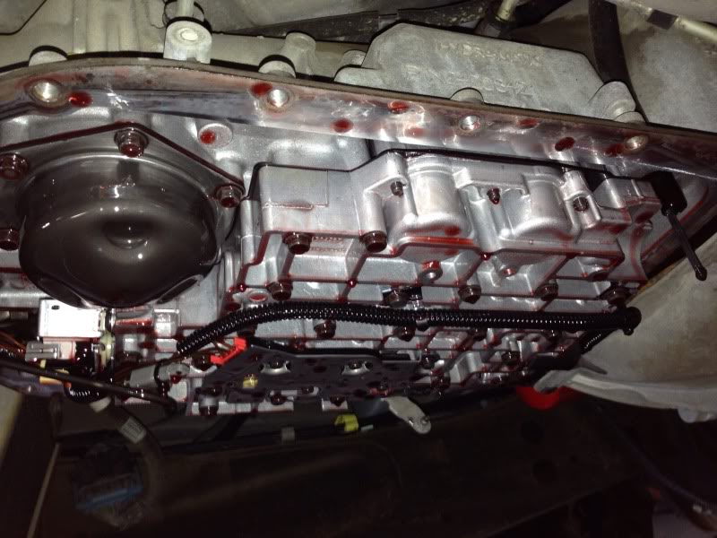

Did a shift kit with the help of a friend whose a "tranny"(the mechanical kind) expert!

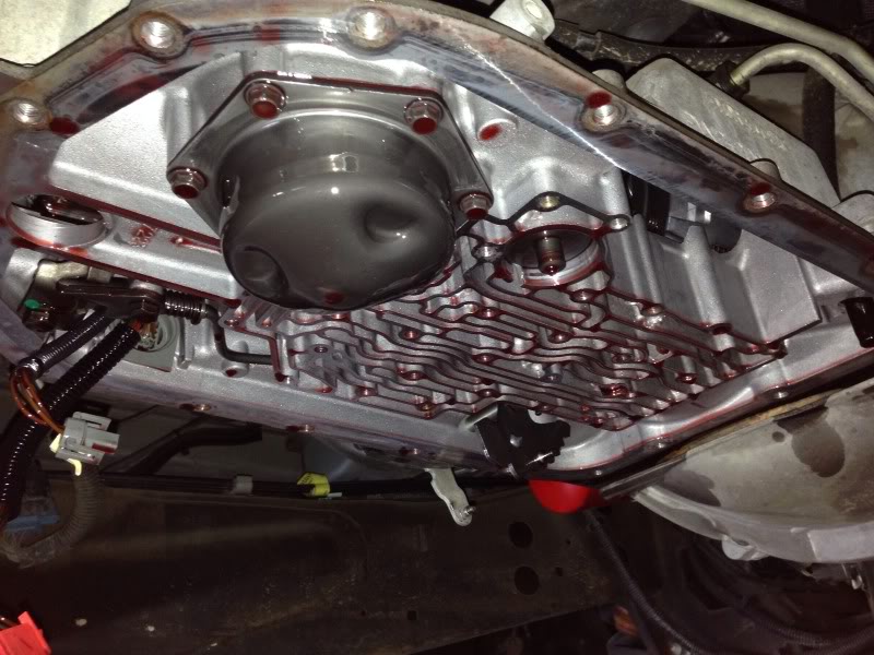

Pulled the Pan off the Transmission to get to the Valve body:
Pulled the gasket off:

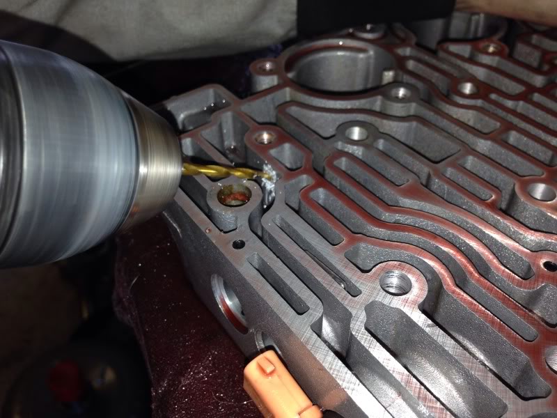

Drilled a few holes:

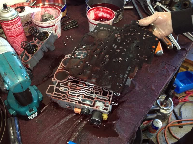

Also pulled the pump off, swapped out some springs and solenoids then threw on a new Gasket and replacing the ball bearings, well most of them:
Here's the bottom of the tranny with the valve body removed:

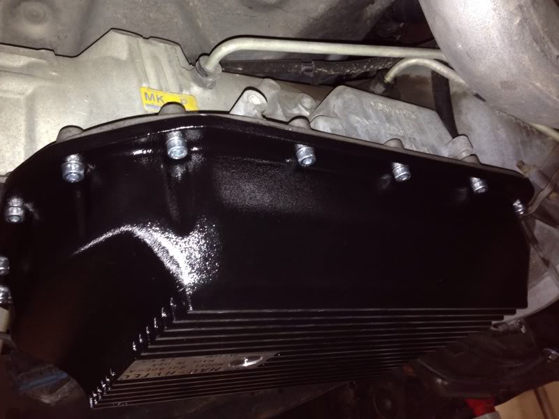

Then bolt it all back together, slap in a new deeper sump'ed pan...
And...Voila, all done.
Transmission oil looked good, I was worried that my transmission was starting to slip with the hot tune installed, but everything looked good and now with the shift kit I have a peace of mind that it will last. Reason for the deep pan was for added fluid/cooling for when I tow heavy.

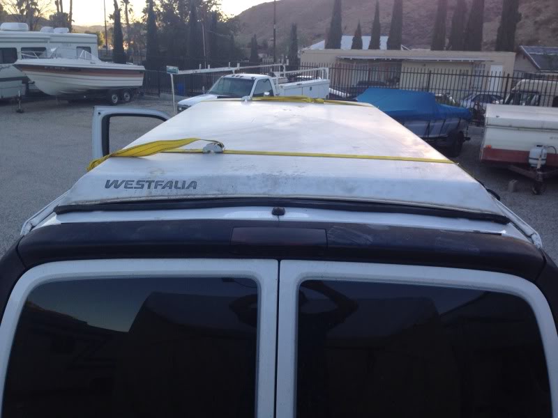

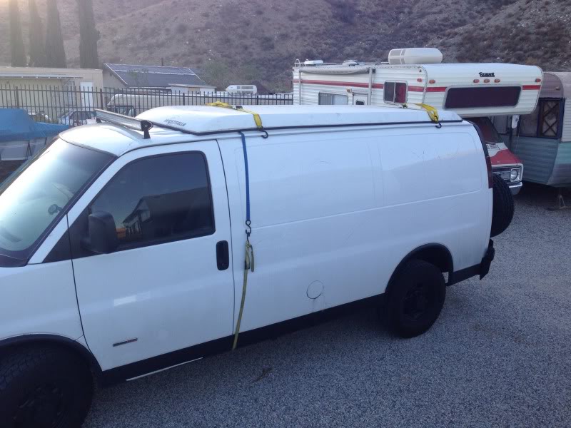

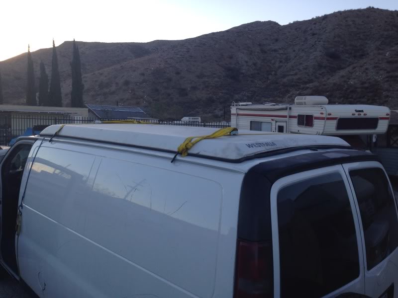

Also...I picked up a Pop top!!!
I haven't installed it yet, just picked it up(they are hard to find). I have a few things to do before I can install it and I don't think I'll get around to it for a while either.
And if your wondering what all that writing is on the side of my van, someone keyed my van a couple weeks ago. So now I have extra motivation to Line-x my van.
Anyways, pretty excited to have finally found/gotten a pop top. There aren't a lot around that are as sleek or look good. Will be sweet when I can stand up in my Van!!
