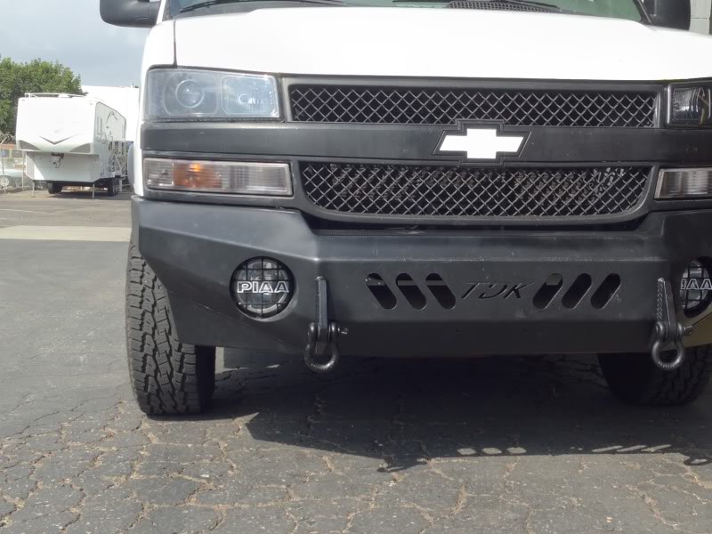

Got a few updates.

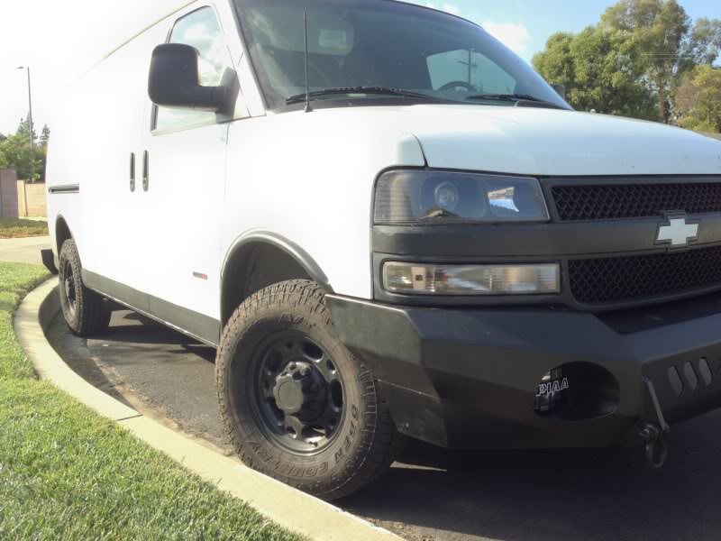

Got the bumper finished, wasn't able to get many good shots of it but here's what I got...
Cut 4" off the bottom and added some side skirts:
I really like it, a lot better than the previous version that had such a large overhang and large approach angles. It woulda looked different if I had 35" tires and lifted but I'm not and so it just looked weird. So new look is a big improvement.

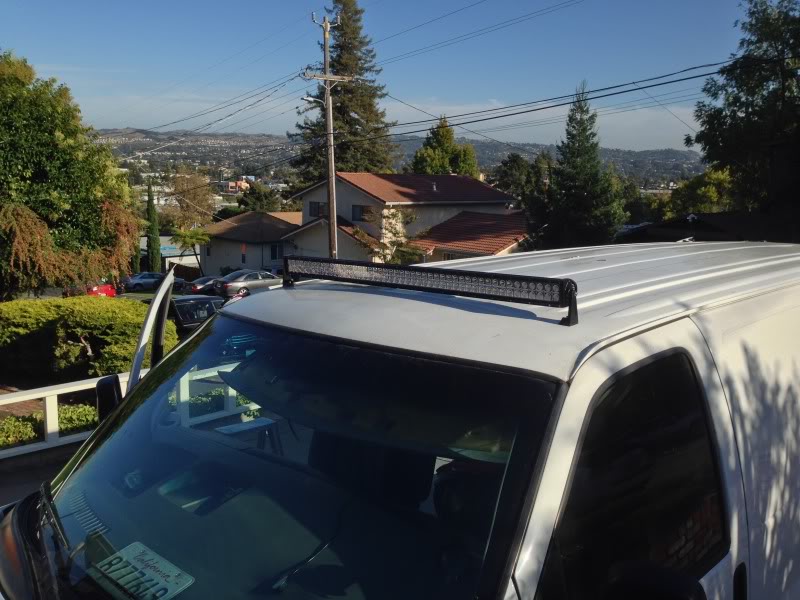

Next up was a LED Light Bar. It's a 50" Double row with what I believe are 5Watt LED's, but it could be 3Watt LED's. Either way it's really bright! Lol

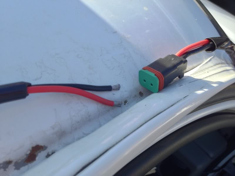

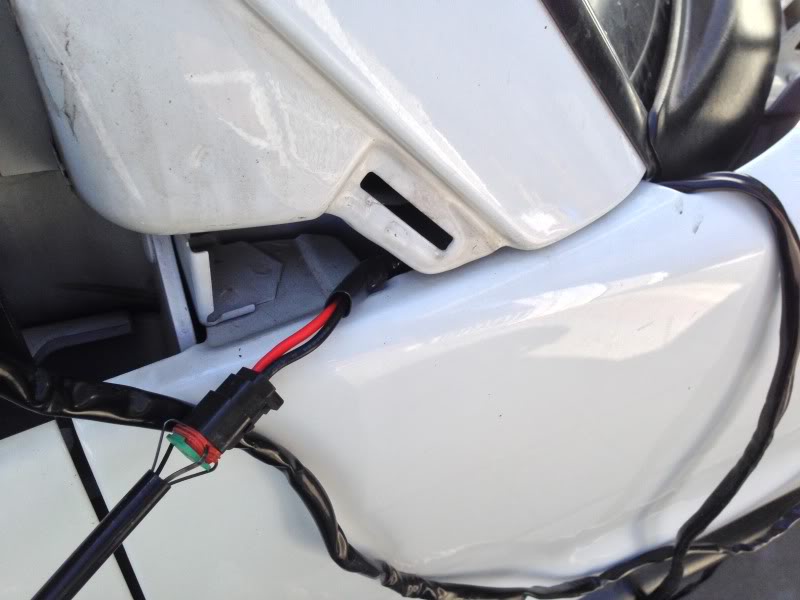

So first up was running the wiring, I was thinking of drilling a hole into the roof and sealing it with some grommets and Silicone but after playing with it for a while I was able to instead run the wires between the door seal and the window seal. There's a space in there where it worked well and didn't impede at all the functionality of either.

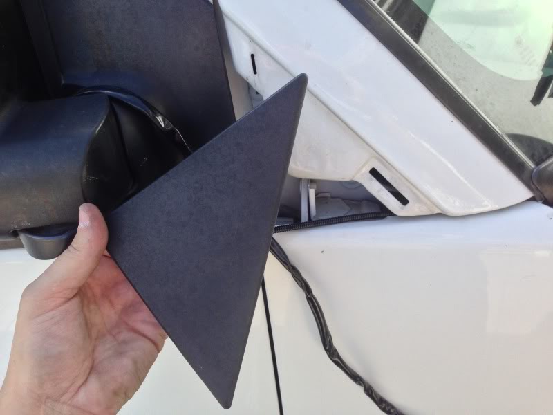

I had to pop off this plastic trim piece

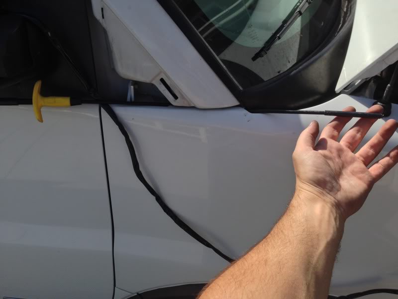

And then run a grabber from one side of the A-Pillar into the engine bay
Fed the wire through

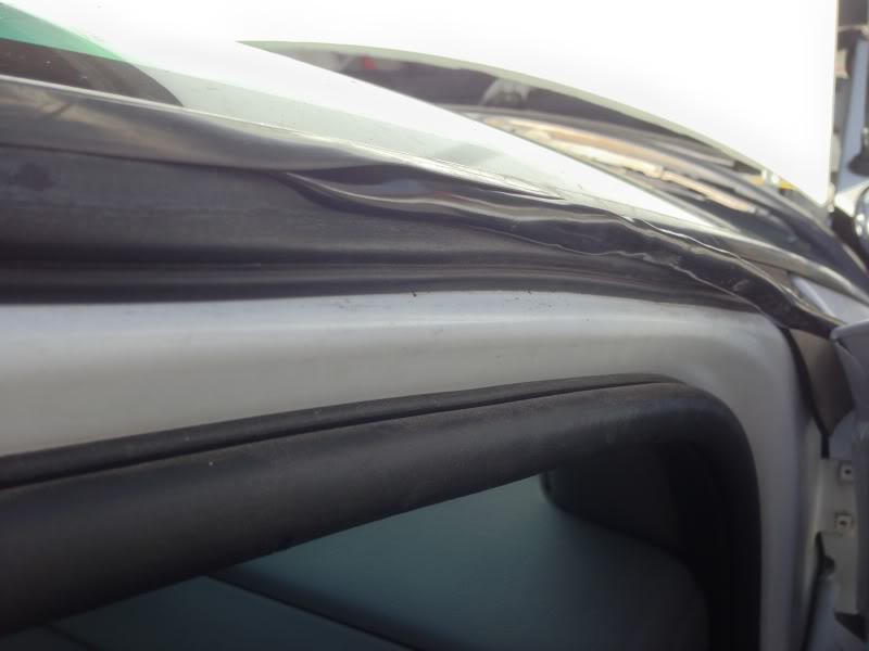

And then up between the rubber seals to the roof

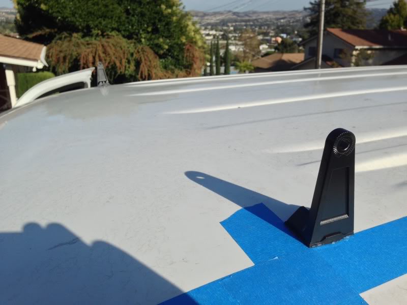

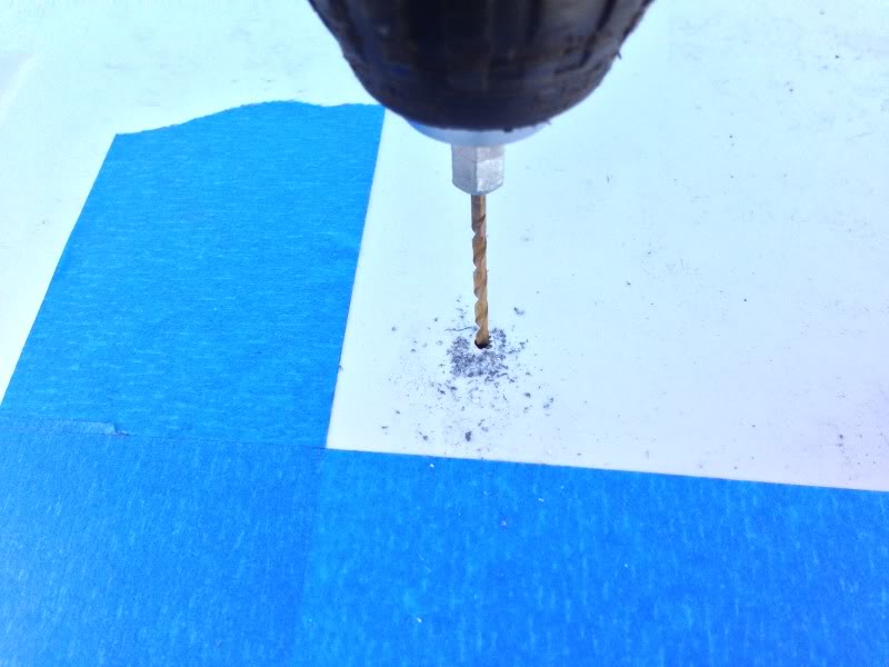

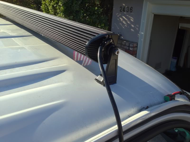

Next up was lining up the brackets
No going back now

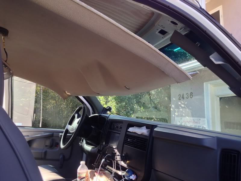

Pulled the headliner down so I could scoop up the shavings and get access to the underside to affix the nut to the bolt

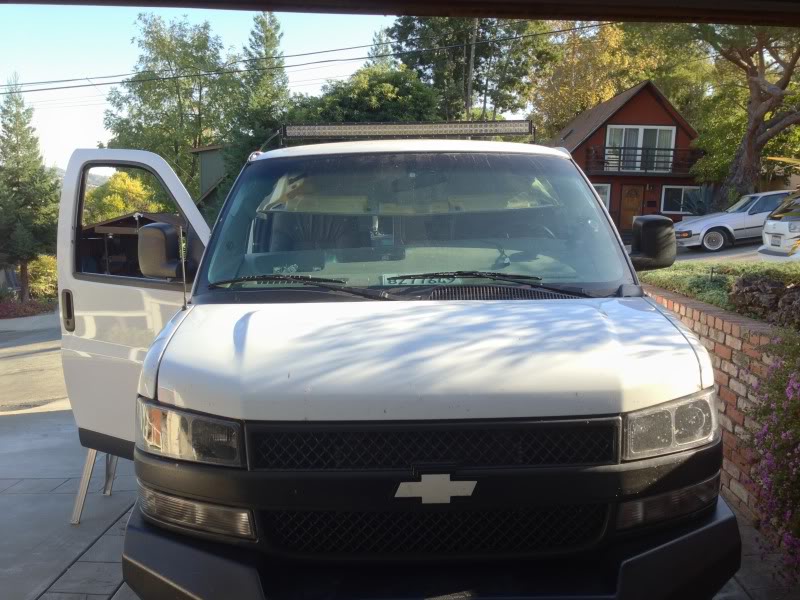

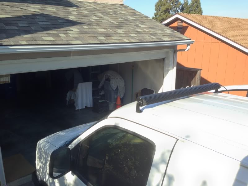

And here it is mounted but not wired up...
For those wondering about sealing, the kit came with a rubber pad, and I added a lot silicone to it to ensure no leaking
Kinda hard to see the silicone but it's there
This is the wiring that I was left with, and it didn't work. The leads from the light were 12 gauge and the pins for the harness were 16 gauge

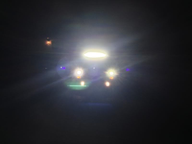

Anyways, had to wait till morning till the hardware store openedI bought some bullett connectors and made it work. After it got dark I lit it up and WOW!!
Just the Lightbar and the Fogs
W/ HID's

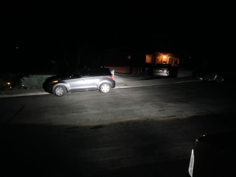

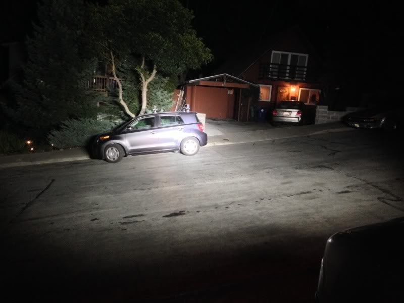

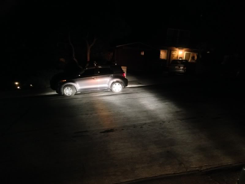

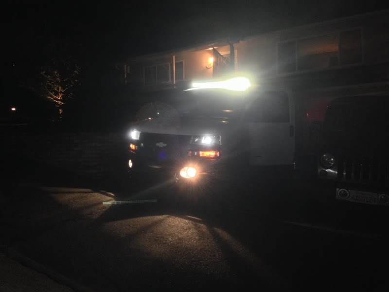

So here is a Comparo of the light emissions...
Here are the Fog's (somewhat bright but very focused)
Here is the HID's (Bright and Wide with a nice cut-off line to not blind motorists

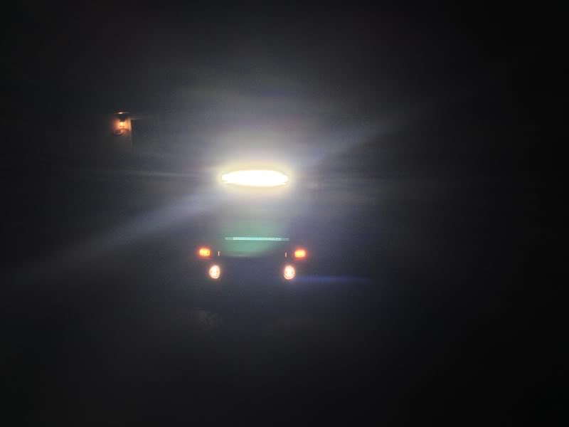

and here is just the LED Light bar (Brightest, and all over the place and just plain awesome!!)

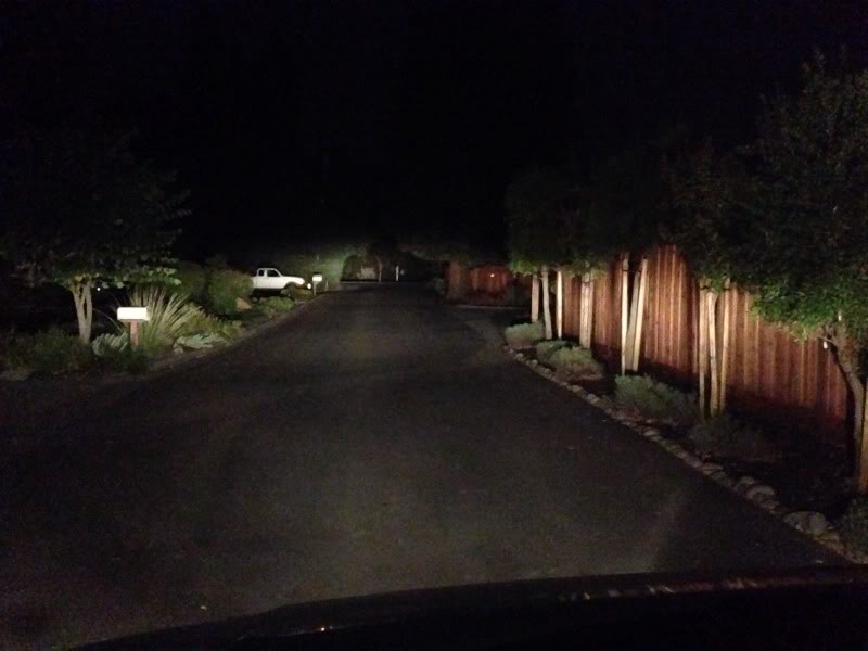

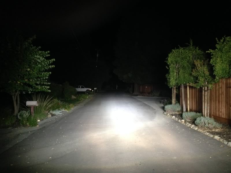

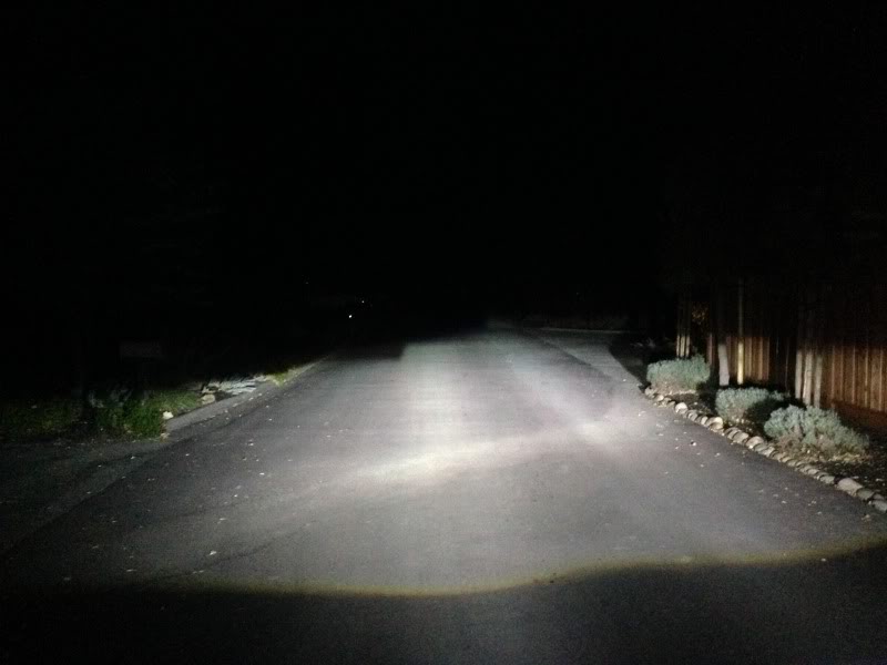

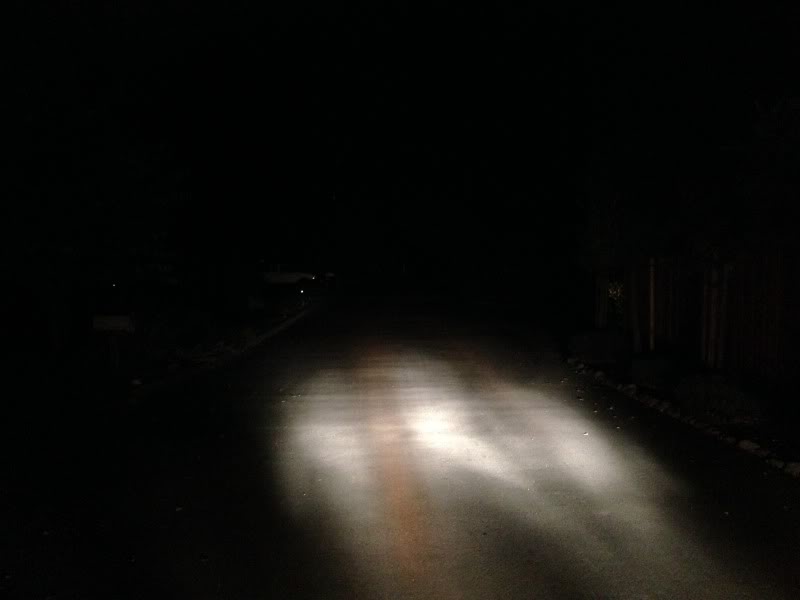

Took some better comparo's..
Here's just the Fog's
Here's just the HID's
And then with the Light bar!!
I have to point them up a bit too, no sense in them overlapping the HID's like they are. Should project further.

Tonight I grabbed another pic with my High Beams...
i don't use my HB much anymore since my HID's work so well but they don't work too bad. I think the Light bar would show much better if I angled it up a bit. In all these pictures it's pointed down and covers the same ground as my HID's, but oh well.
