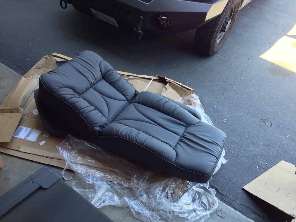

However I just had shoulder surgery and won't be able to install them for a little while. However I did get some new seats and for those I couldn't wait to install them so I did that today...

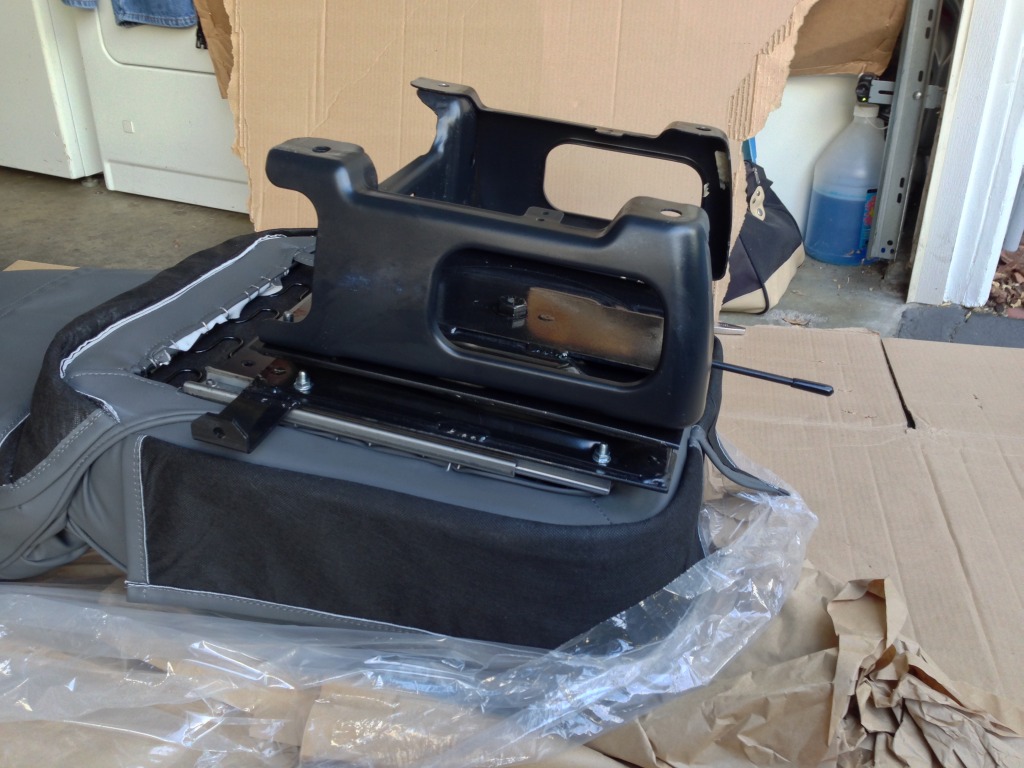

Here are the two seat bases...
One on the left is for the drivers-side and the one on the right is passenger with 360 swivel.
Drivers seat:

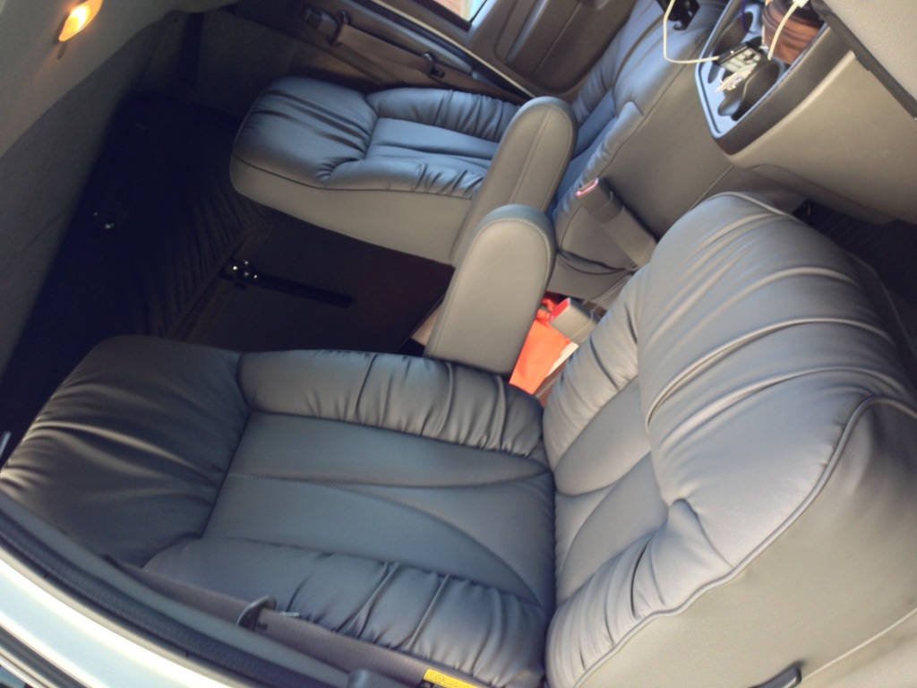

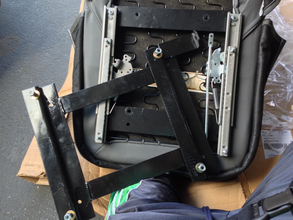

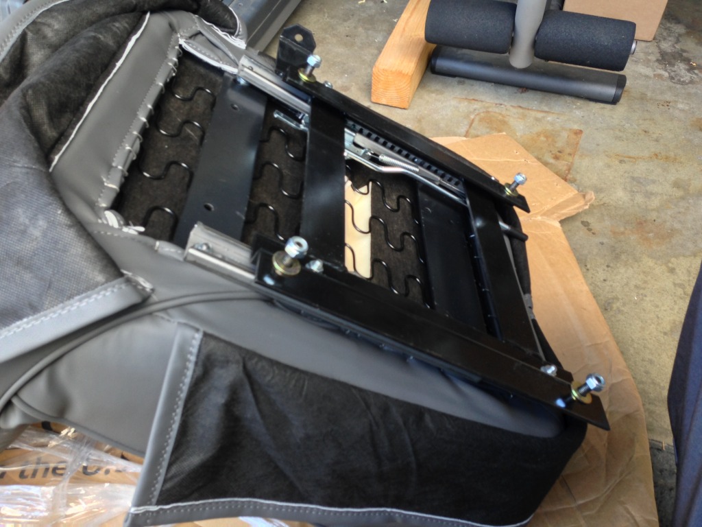

Here's where the adapter plate bolts onto the seat base...
Size:  208.2 KBName:  null_zps6304322b.jpg
And then the seat pedestal that I swapped off the stock seats. It's needed to clear the airbag sensors that are underneath the drivers seat, passenger seat not such a big deal but you would be riding low without it!! Lol

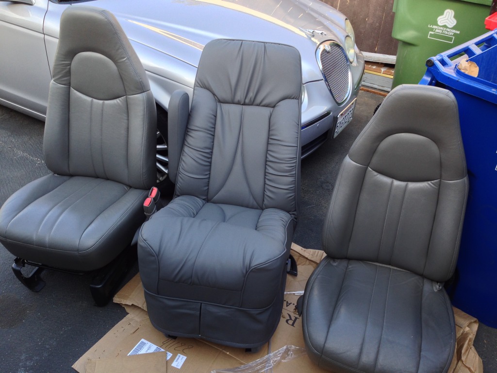

Side by side comparo of the seats:

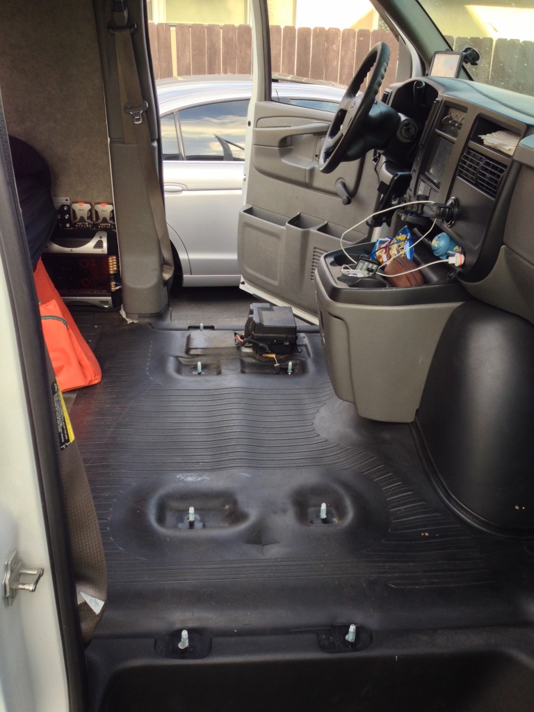

Quick view of the front with the seat pulled, you can see the sensors underneath the drivers seats as well as the seat belt sensor. Which reminds me I had to swap those over onto the new seats. No biggie, pretty simple.

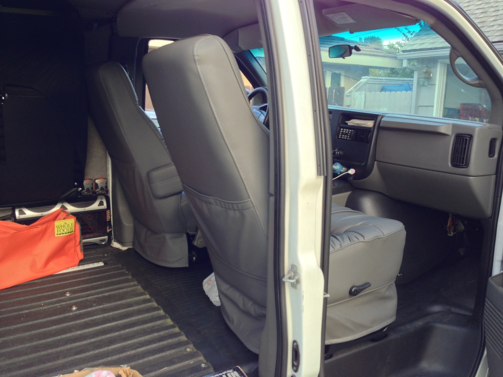

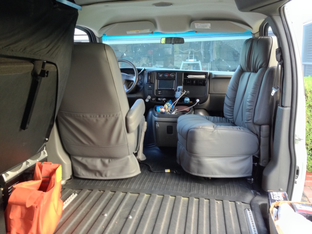

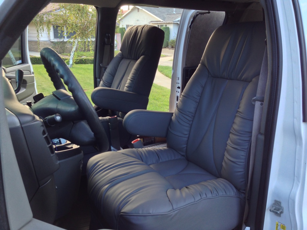

And here's with both seats in and hooked up:

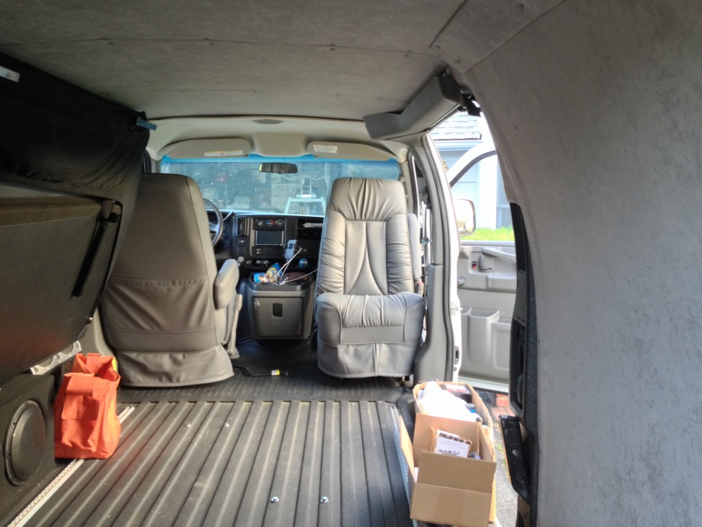

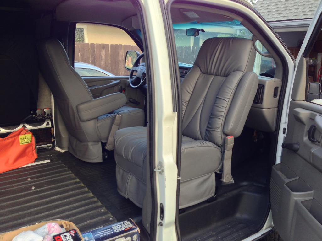

Passenger seat turned 180 and at a 120 to face the driver. I can spin the seats ok but its easier to do it with the passenger door open so doing so while moving won't be possible.
I haven't used them much but so far they are super super comfortable and the arm-rest is real nice after having driven so long without one!
Anyways, that's it for now.
