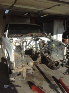

Took out the old and busted 350 just the other day (which was quite possibly done on the hottest day of the "fricking" year) and set the old beast aside. I disassembled the whole front end since she is 25 years old and could use some cleaning up and fresh coats of paint. Not too mention its so much easier working at it from this direction instead of an angle.
I am gonna be a photo junkie a bit and post some pictures of the progress for those who would like to see, here you go!
