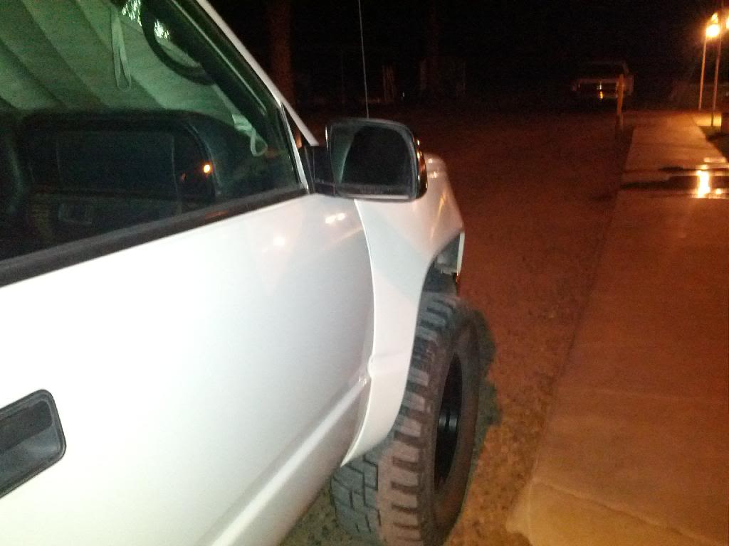

Bit better shot of the prerunner fenders here. It just doesn't look as rugged with the 90 gmc bumper. Soon to be replaced by a custom fabbed pair front and rear. 50" radius light bar up top, and a prerunner roof rack (gas cans spare tires, hi lift jack and all that jazz.)

okay... from the earlier pics in here, it just looked like another Tahoe with a fancy lift.

Yeah, that's why I'm switching to glass worx fenders. These look stock from all angles but front lol. The glass worx have a bit more of an aggressive rise too them and more wheel well opening, so from the side you KNOW it's a prerunner. These will be for sale soon along with my entire front suspension setup. Going big. 5.5 or 6 over offset I beams from AZDirtworx. As it sits my uniballs and hiems are larger and stronger than that used on pro4 and pro2 trucks. Since It weighs so much more I didn't want to take any chances.
