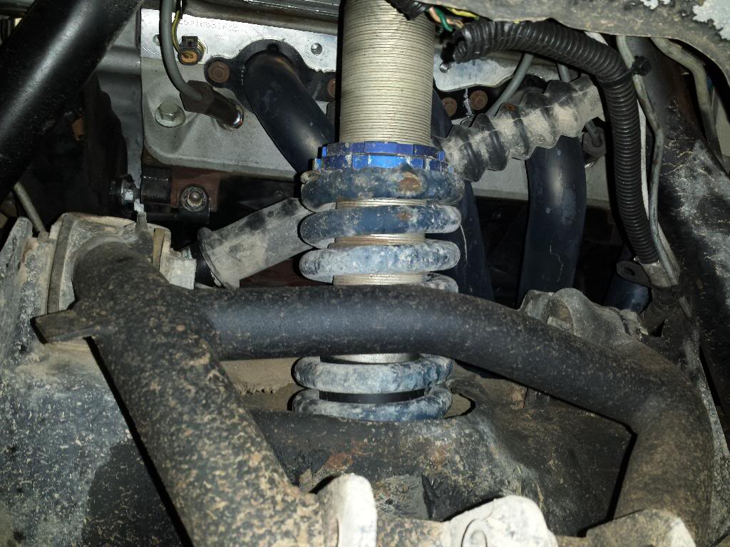

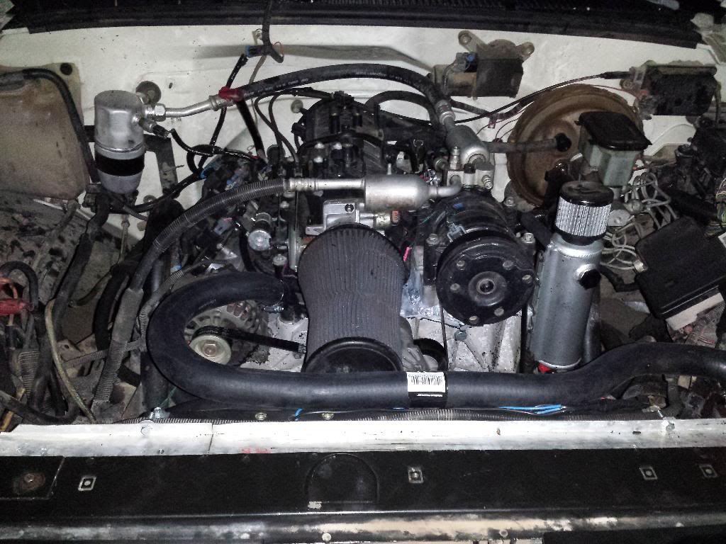

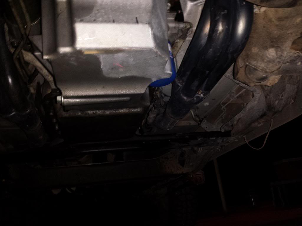

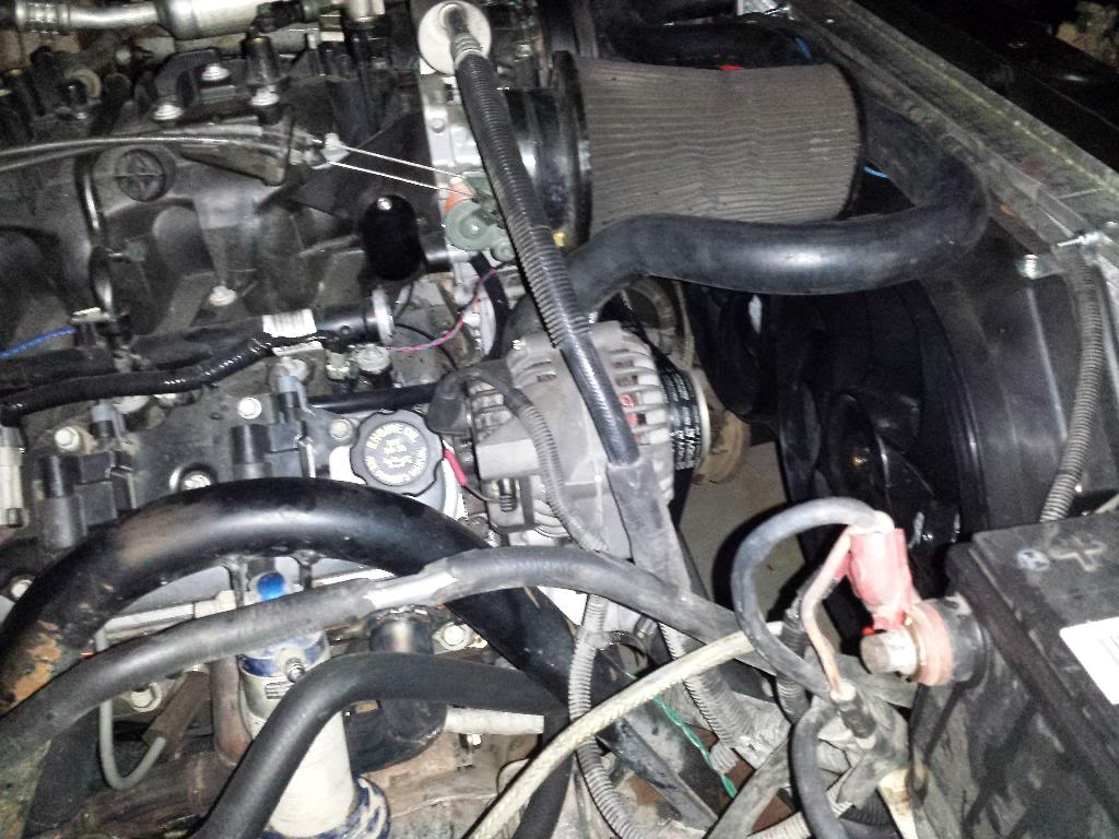

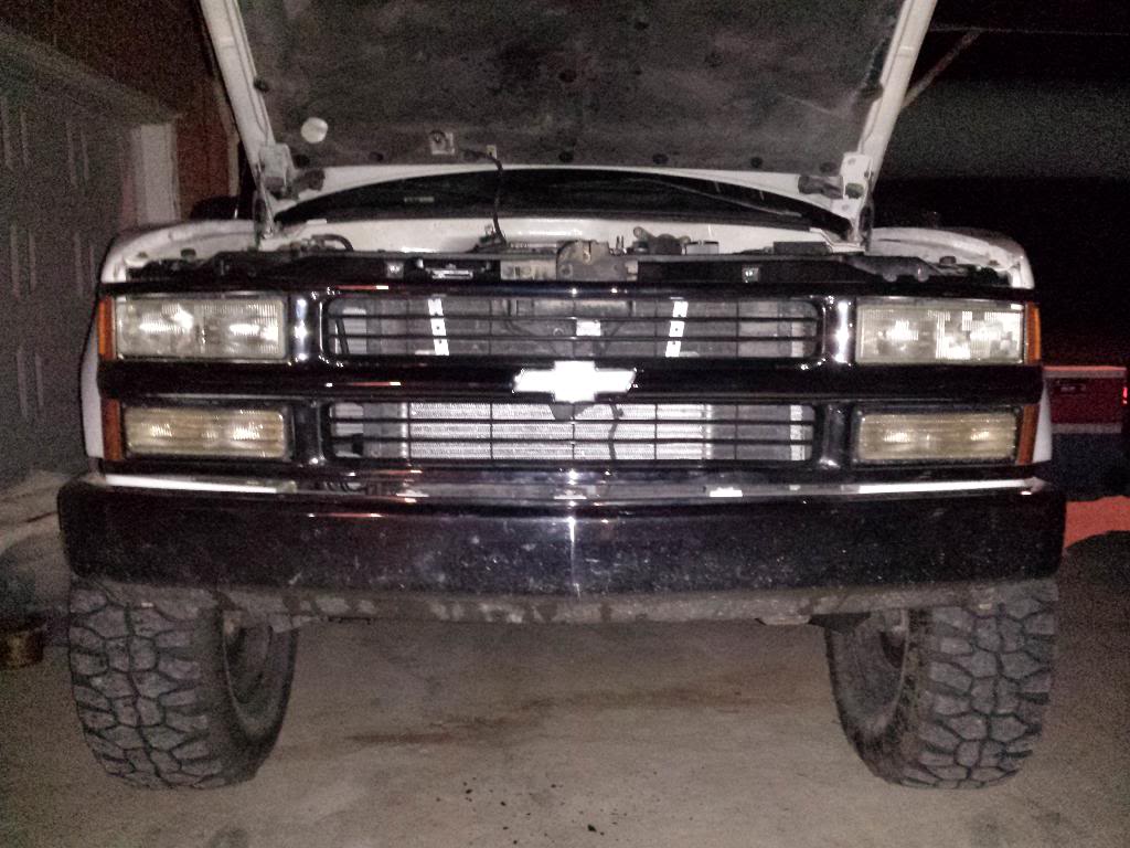

She's done!
Here's some photos.
Quick video. More photos once I upload them to the bucket.

Ecu was retained in the stock location. Speed density tuned. Respectable numbers, she put down 330/340 through a build 4l65e on 35" tires.
