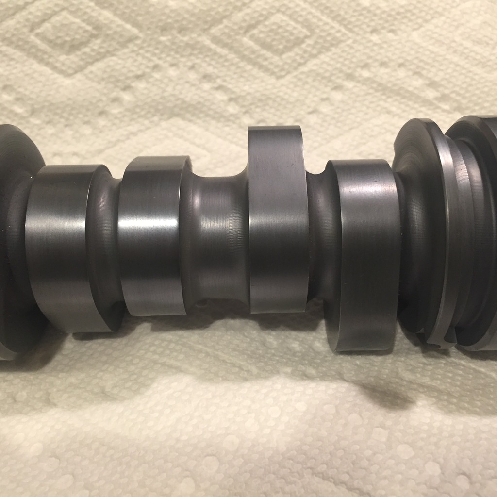

Etched and coated the cam today...tomorrow I'll burnish it with the 0000 steel wool and next week after it's fully cured I'll buff/polish the coating.

Interesting. i hope this never causes any lifter issues for you.
I know they're buried in here somewhere... what are cam specs?

I am really curious to see if all this polishing and coating works out well, or if you trash a $10,000 motor because you had too much free time on your hands

235/242. .621/.615 118+5

Me as well

Which heads? Interesting cam choice for a blower...
