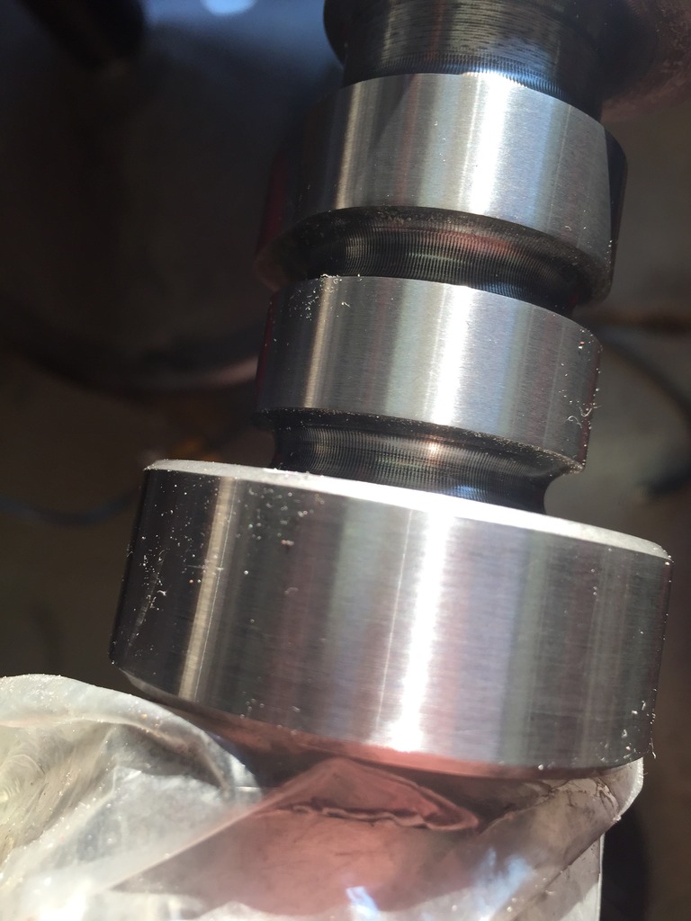

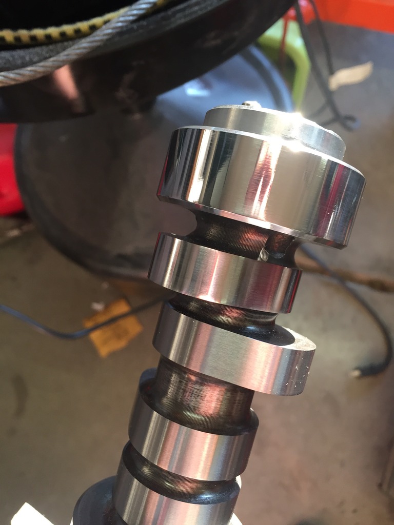

Old May 17, 2017 | 09:39 AM
  #284
Petraszewsky's Avatar
iTrader: (28)
Joined: Oct 2008
Posts: 1,137
Likes: 22
From: USA
Flame away!!!
Before:
After:

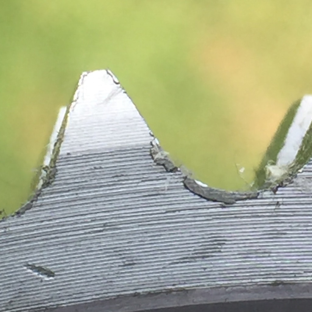

And some more viewing pleasure
Timing gear before: notice all the burrs and laid over metal
After: Just a quick buff with black emery jewelers rogue and a spiral wheel on buffer

Who made that timing gear? I would be careful on the cam journal. Did you mic it to see how much it changed?
Old May 17, 2017 | 01:05 PM
  #287
iTrader: (28)
Joined: Oct 2008
Posts: 1,137
Likes: 22
From: USA
No mic as I don't have one...anything billet is going to have burrs and stuff but it's a Comp billet timing set.

Timing gear looks much better. The journal concerns me, I may be completely wrong in my concern by the way.

This is my thought process on the cam:
If you look closely at the after pic you can still see valleys/grooves which will still retain oil. My thought process was that polishing will remove the burrs and turn the "V waves" from grinding into "square waves" creating more surface area while still maintaining the valleys for oil retention. Plus with it just being cloth buffing wheel and jewelers rogue only a tiny bit of material is removed. It more like burnishing than anything. If it eats itself then it's my fault.
Old May 17, 2017 | 03:48 PM
  #290
arthursc2's Avatar
Joined: Jan 2014
Posts: 4,341
Likes: 1,517
I doubt the cam polishing is a bad thing. If you had a mic, it would have to be a super mic, because I doubt more than .0001" was removed
