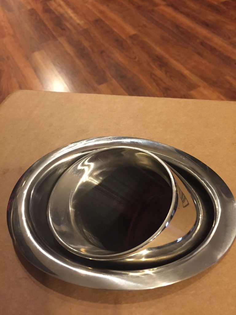

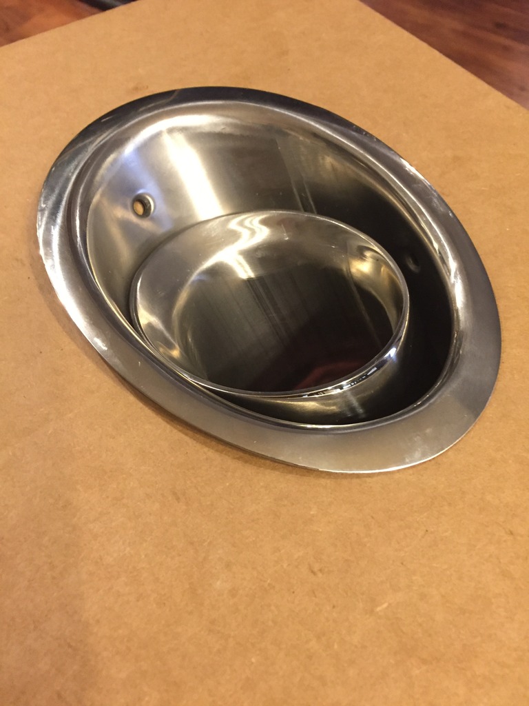

I knew I wanted the exhaust tip to exit down low through the body panel in front of the rear tire but didn't want a tip just poking through a hole. I brainstormed and came up with using a 64-66 Corvette exhaust bezel that 3.5" in diameter and 3" double wall tips. I plan to coat the bezel matte black with something like Cerakote to keep the abs plastic panel from melting. Which version looks better?
#2 I can weld the screw hole up and smooth it out so don't worry about that.

I like #2

I like #2
I wish I could find a double wall tip with the same angle as the bezel but that wouldn't be easy.

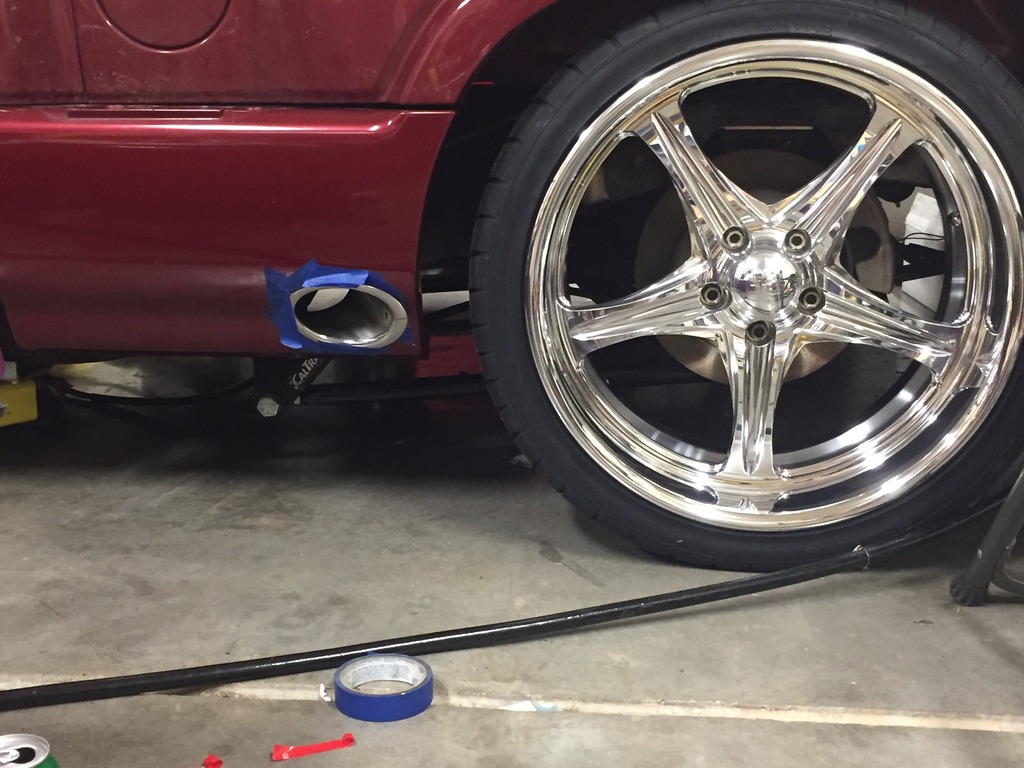

Very careful measure and cut well within the lines. Still have plenty of sanding to do in order to make it fit nice and tight. But overall I'm pleased with it even though it's a loose test fit.

I like the second one as well, and wow I didnt know you had that much room in the garage

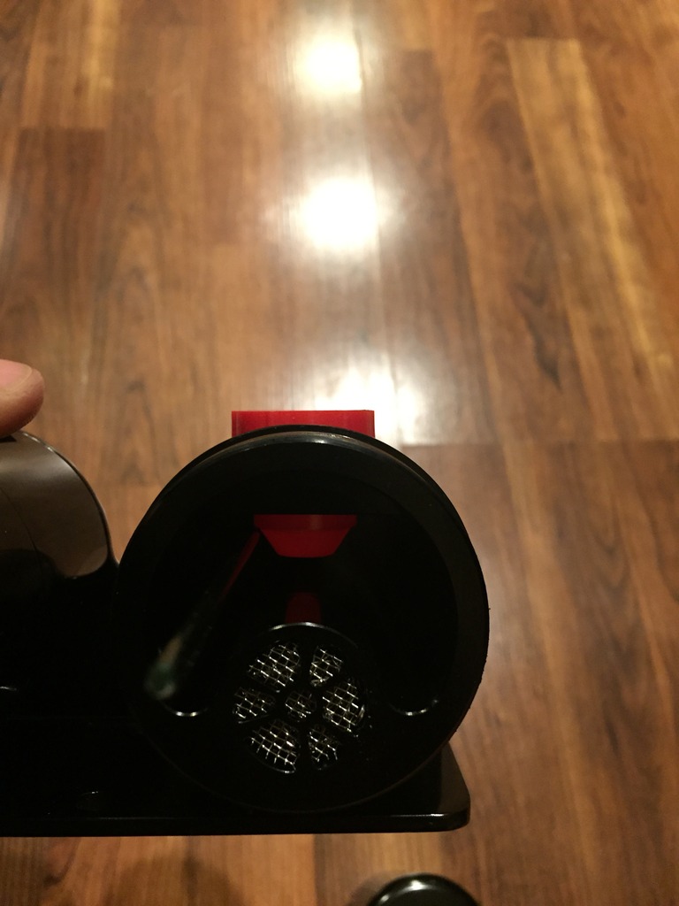

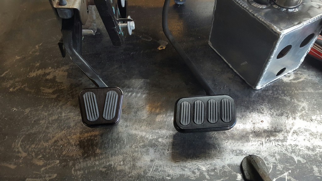

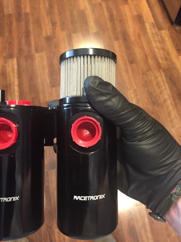

The other catch can didn't fit like I thought it would where I wanted it to so I got a different one. This one has -10an ORB fittings, stainless steel media packed baffle, o-ring sealed screw on canister, dipsticks, and -4an drains. The breather filter is a Aeroflow -8an screw on with stainless steel filter media. The one with the -10an fitting was too large of a diameter and would've looked weird on the catch cans. I also got Atomic to custom mount the Lokar pedals I've had laying around forever.
