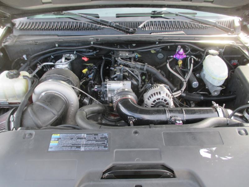

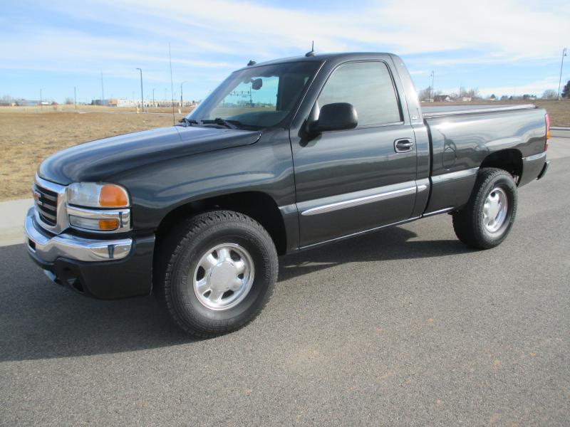

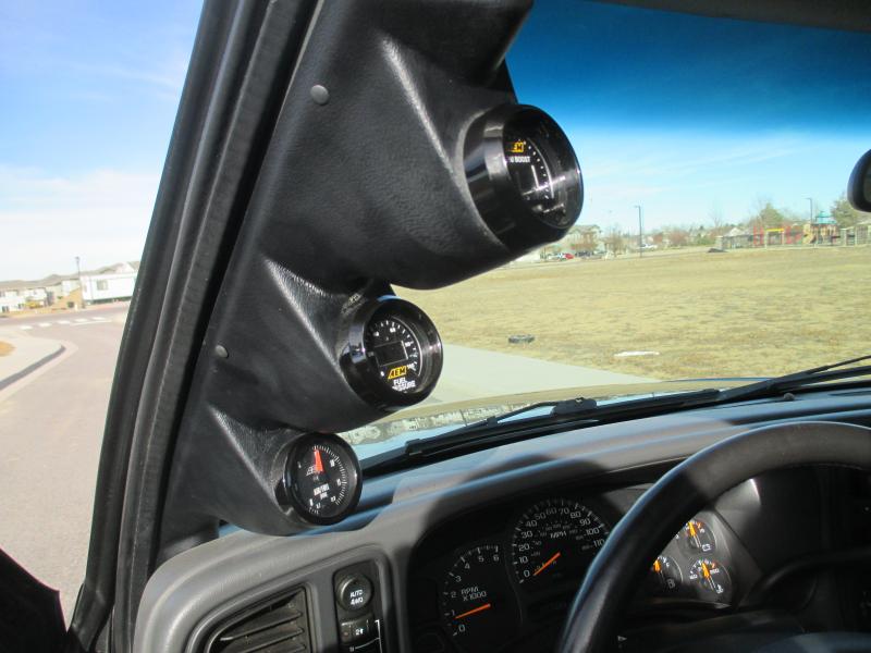

Both videos suck.. I need to get a go pro.. That 0-60 was at about 80-90% throttle. I am still having problems getting the truck dialed in.

Old Jan 25, 2015 | 08:16 PM
  #260
GMCtrk's Avatar
iTrader: (27)
Posts: 12,275
Likes: 19
From: Dallas
Looks killer.
