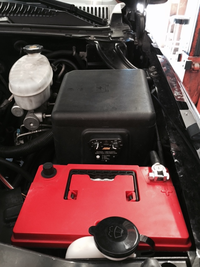

Sorry bud, I just saw this. Today I made a harness for my controller. Everything is tucked away and hidden so there really isn't anything to post up and show. It came out really nice IMO. My controller varies the voltage to the pump. I'm not exactly sure how to hotwire the pump with my set up. I don't know if I run a parallel wire from the alt to the pump or what. I did however run the main power wire in the controller to the alt so maybe I already "hotwired" it??
Anyways, today was the first day I've had time to work on it in about a week. So I got the harness made and installed. I mounted the controller on the fuse block condom by the battery so it is not intrusive and I can still easily get to it. I really like how the entire install turned out and I'm anxious to get it running. I was going to do some tuning tonight but screwed myself since I didn't get an 1/8" NPT fitting for my vacuum block to the controller. So tomorrow I'll get the hose barb fitting and be ready to roll. I can't decide on how I want to pull fuel for the meth... My math tells me methanol will be 20% of my WOT fueling. I'll be targeting 0.75 lambda and I think I'll just pull fuel from the VE verses the PE/BE. Any suggestions?

I wired my controller from the alternator with a relay.I was planning on removing fuel from the VE table. Looks like a clean install Oakley.
