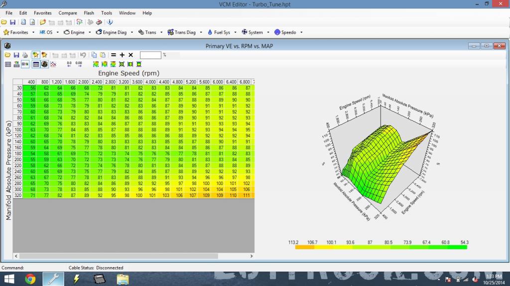

Thanks guys. So do all you meth addicts VE tables look like this?? I took 20% out of the VE where my controller is set to spray and I am still about 5% rich. So looks like my flow calculations where off a bit. I'm going to reflash and do some highway tuning tonight. I'm at 16* of timing and it ran really well even with it being so rich. Should be able to get 18*-20* at my boost level safely.

I'm running strait meth. Apparently the truck is making more power. I just did a highway pull from 65-105 and it broke the tires loose around 70mph. Kind of scared me. I probably need to get the drag radials on ASAP. I should have done that before I left the shop today.
I didn't really like how the tuning was going with pulling fuel from the VE like I was. Plus the VE looking like that made me crazy. I'm going to go back to the VE I was using before I installed the meth and then pull fuel from the BE table. We'll see how that goes. Kind of funny that my IDC is only at 35% now

Not necessarily easier but its a cleaner way to do it IMO. I'm going to give it a try and see if I like it. You just have to know exactly how much you are spraying in order to take it out of the BE.
