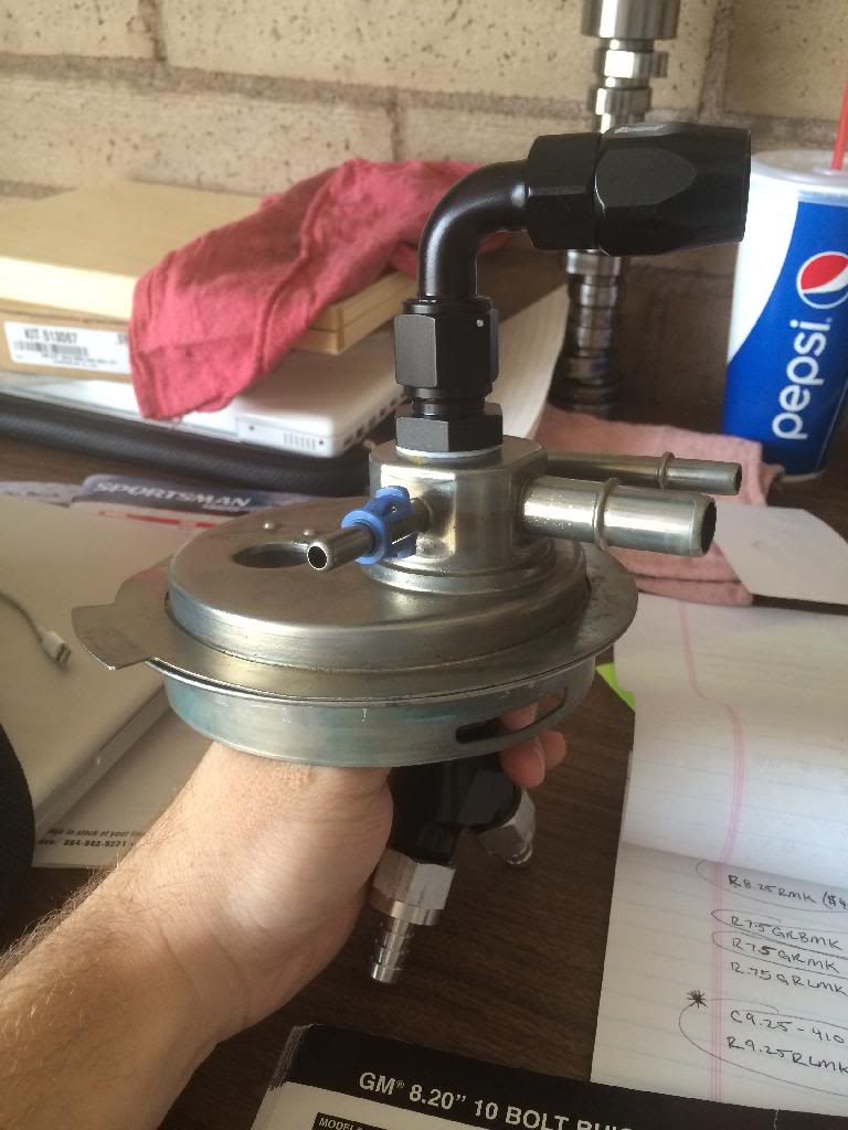

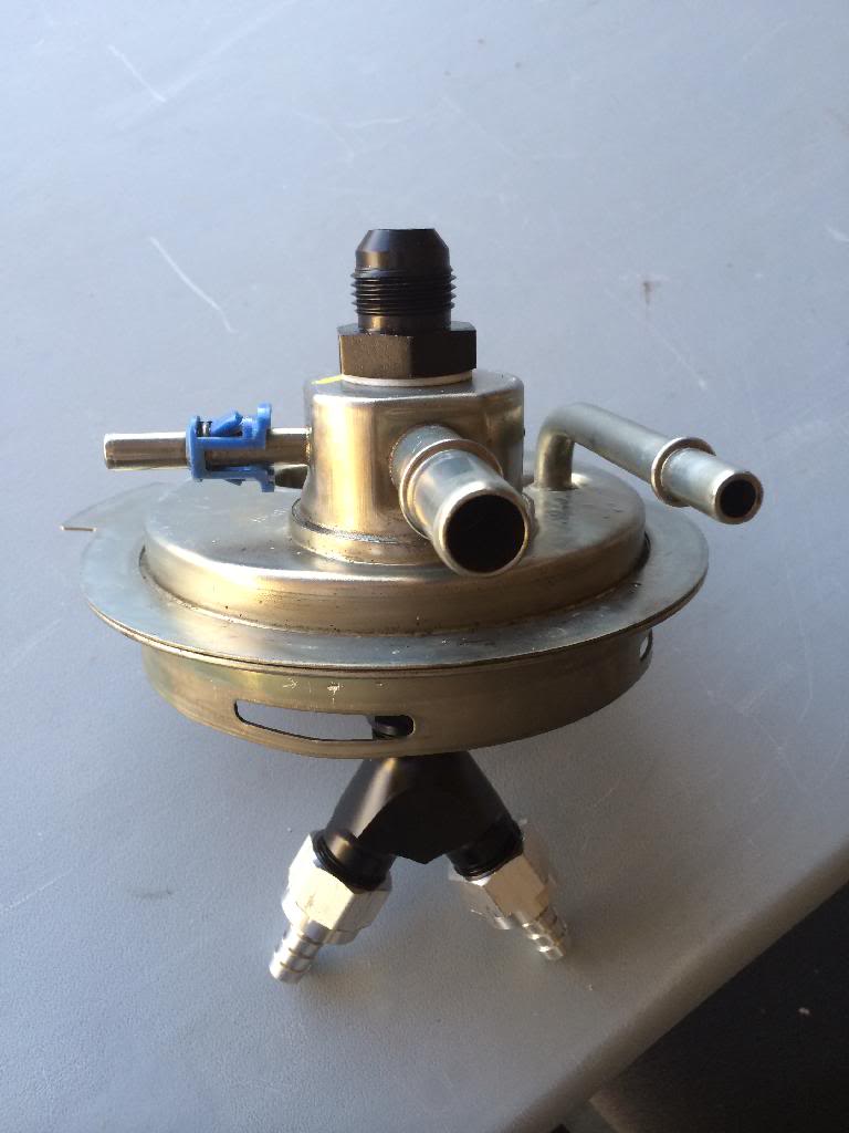

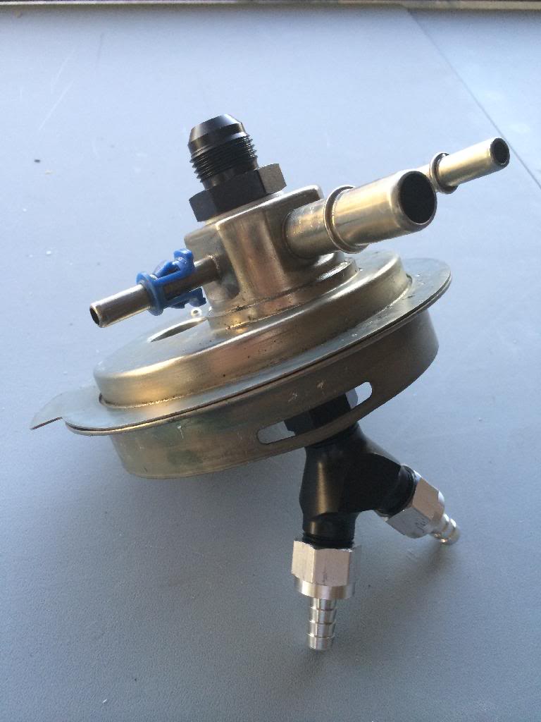

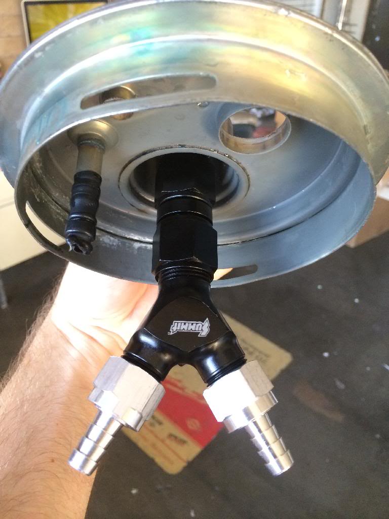

Races are on Friday. Hopefully 11's this time out. Today I got my fuel Y's in from Summit so I tore the fuel bucket apart to see if my routing idea will work. -10 bulk head to two 3/8 barb fittings to the pumps. Let me know what you guys think

I would think it'd work fine. Looks pretty cool too. What year is that bucket top because mine looks nothing like that...

I think you are going to have a problem with it being too tall without modifying the bed...
I agree.

Yep figured it would be close. Wasn't sure how close to the bed that EVAP extrusion sat. You guys think it will still be close with a 90* bulkhead?

It wi be alot better with the 90* bulkhead but still may too tall.

Hmm I guess all I can do is try it. If anyone has there truck up on a lift a lot, can you try to measure that clearance for me. I don't have a tank yet.
Maybe I'll just machine a new hat. That would simplify things a lot

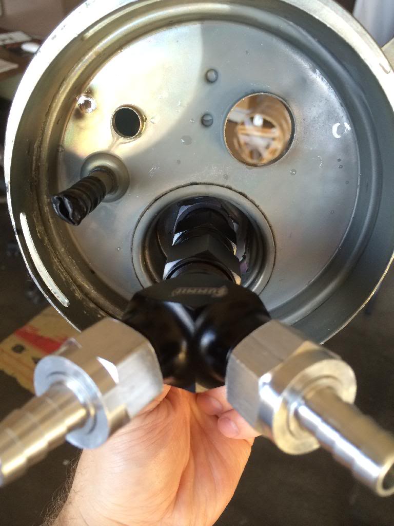

Plenty of room guys
