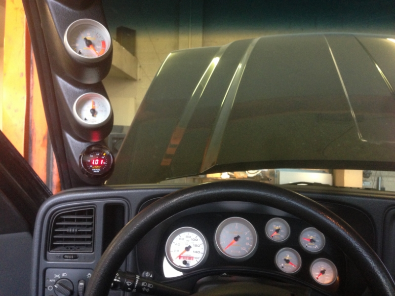

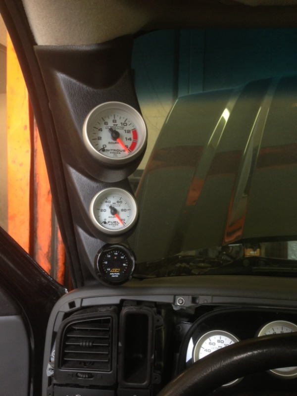

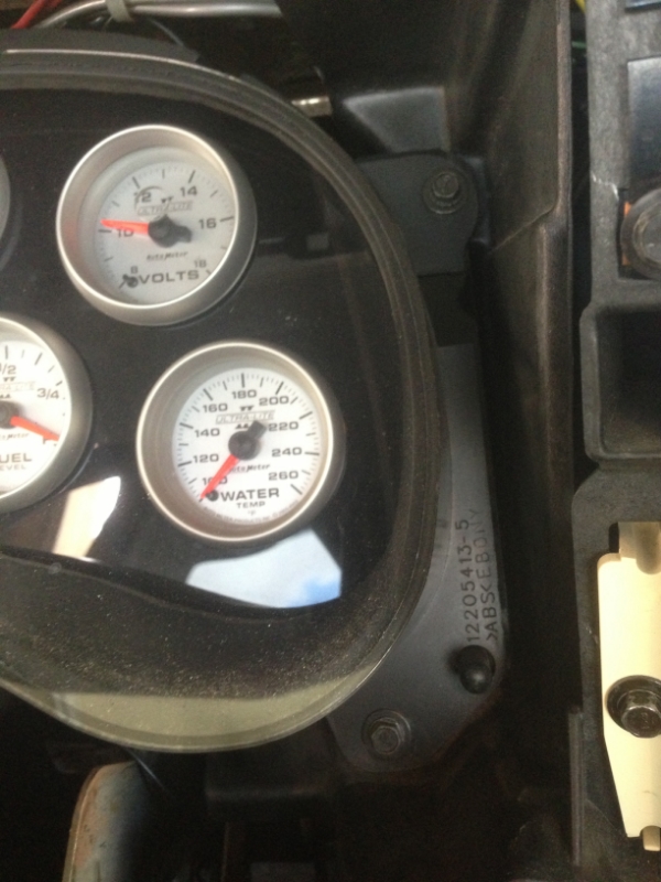

Got the gauges wired, mounted, and working. Just need to get wire loom sometime soon to hide the signal wires in the engine bay. I don't have a nitrous system yet but hopefully that comes next

Here you can see a close up of how I built the cluster. Stock plastic cover stacked on top of 1/4" plex.

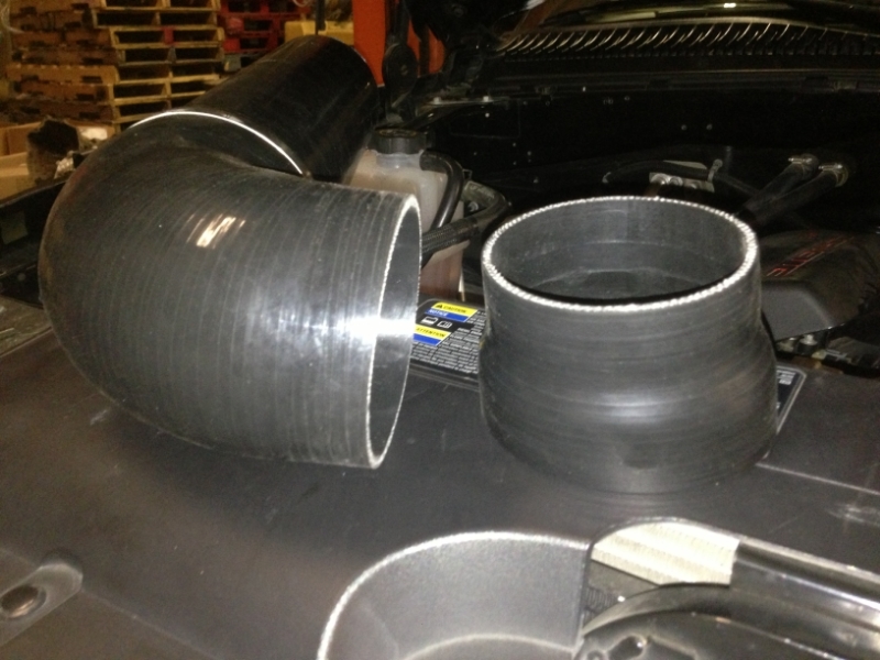

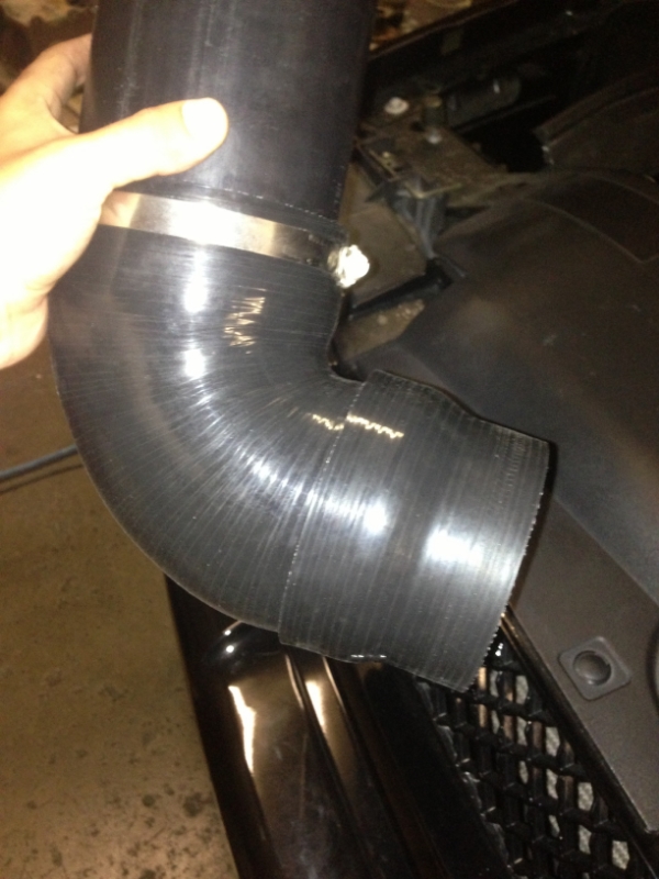

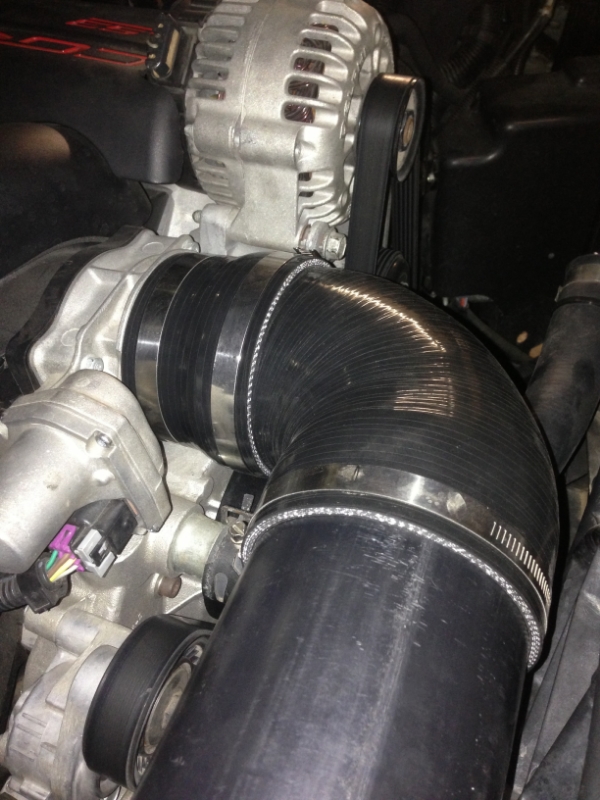

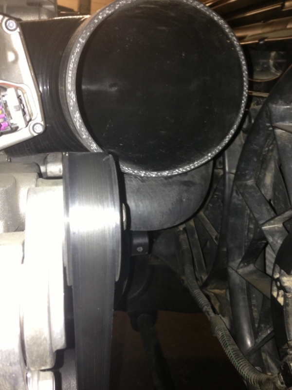

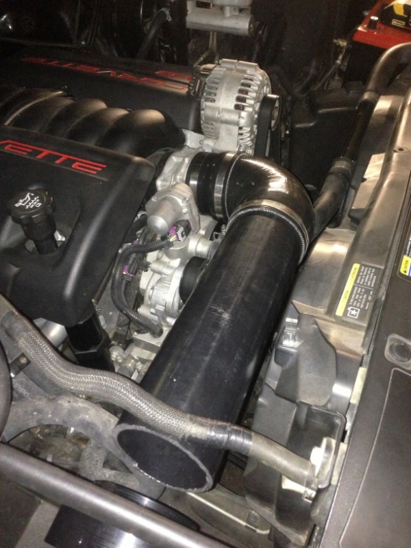

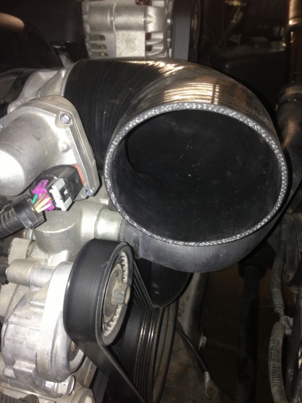

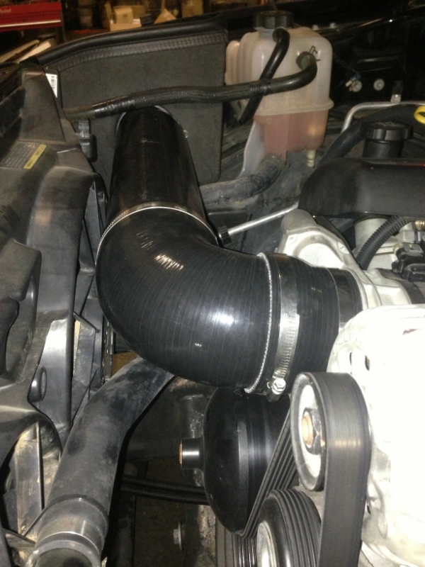

I need your guys opinion on my CAI I'm putting together. I bought a 90* silicone bend but it doesn't stick out far enough to clear the belt tensioner. Here are some pics:

So I found a 4.5" to 4" strait reducer that gives me the extra clearance needed. This truck is N/A so I'm thinking I can slip the reducer over the 90* bend and it will work fine..? Do you guys think it will leak at all?
