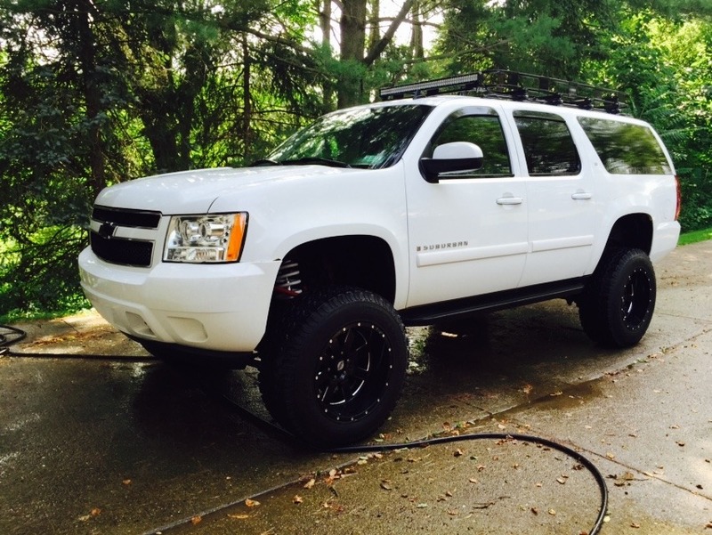

Trans finally went on me.
Anyone running a performabuilt black edition level 3 4L65e/70e?
I'm not really wanting to do the 80e swap, but know it's likely going to be my best bet for reliability.
and whats a thread without pictures....
new tires
