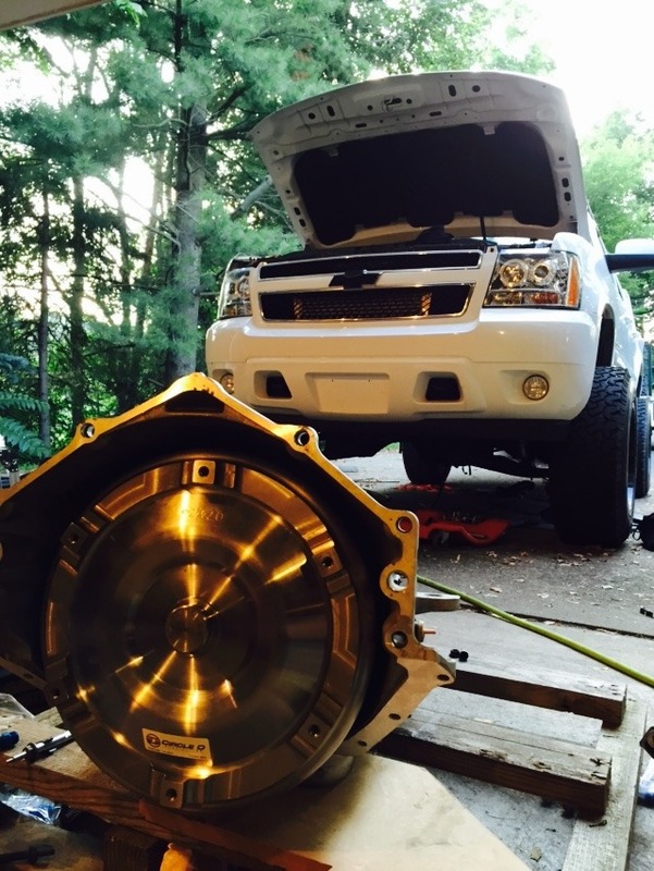

Update:
Converter came in. Should have everything!
Got the 60e out. Got the 80e in.
For some reason, my truck has the 2nd gen T-Case, even though that change didnt happen until 2010 or 2011, and my truck is an 07? Someone has deff be in there before because not only is that T-case from a newer vehicle, the top bolt of the transmission was never put back...
Anyways, long story short the damn T-case is in a bunch of pieces still because the new input shaft was 3 teeth too big on the outer gear.

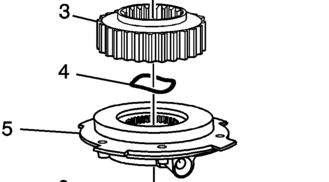

Looks like we took apart more than we needed too. And now that it's been more than a week I cant remember exactly were this goes?
Is it part #27 on the diagram below?
Attached Thumbnails NNBS Lifted Burbn' Turbo Project-exploded-tcase.jpg   NNBS Lifted Burbn' Turbo Project-ring.jpg

Looks like it was the "oil pump wave washer." Moved it last night, T_case is back together.
