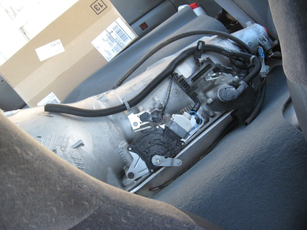

Old Oct 9, 2010 | 03:17 AM
smokeshow's Avatar
Mod with training wheels
Joined: Feb 2009
Posts: 7,741
Likes: 207
From: Detroit
THAT just happened.
Dragged the 80e out of there in a Geo Metro. haha
Also just snagged that crossmember from 53RUSSELL while I was up in Phoenix, hope it fits!
Will probably be pulling the 60e in the morning, 80e will go in next weekend (assuming all goes as planned) and the driveshaft will be specced out as well. Lot of work to do...
