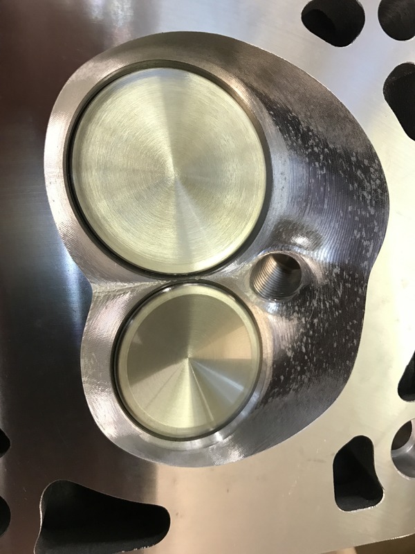

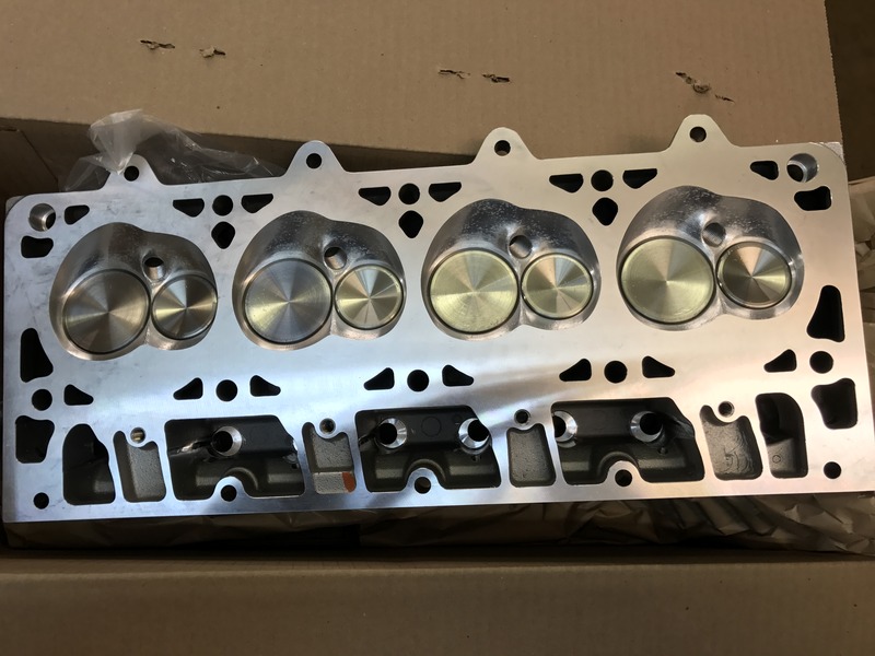

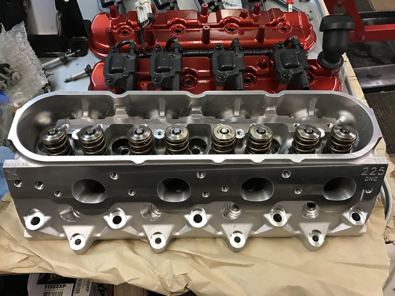

Old Feb 2, 2017 | 05:39 PM
  #124
MikeGyver's Avatar
Joined: Jun 2005
Posts: 4,515
Likes: 242
From: Suburban Chicago
You're going to have a hard time keeping the spent exhaust gas in your cylinders with those ports! I see why they would be better for N2O

Gotta measure the rest of my pushrods, so far I am right at 7.590 and my lifters call for .030-.040 preload so 7.625 should be perfect if the rest fall close to where the first 3 holes did. I'll check PTV tomorrow.
Old Feb 3, 2017 | 07:48 PM
  #126
03sierraslt's Avatar
Posts: 19,007
Likes: 221
From: Western PA
PTV is greater then .25 so that's not an issue. Also free drop at TDC is right around .48
All kinds of room.

Just noticed there are too many bolt holes in those headsZ what do the extra holes bolt down to?
Old Feb 4, 2017 | 06:44 AM
  #128
Posts: 19,007
Likes: 221
From: Western PA
Nothing at this time. Someday they may bolt to a Dart block.

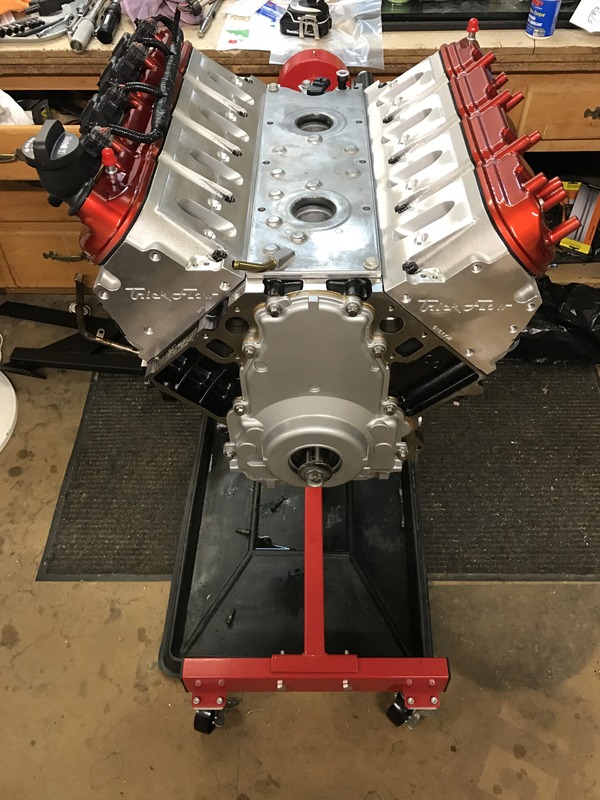

LS6 valley cover just to cover the valley till blower goes on.
Old Feb 4, 2017 | 07:13 PM
  #130
MikeGyver's Avatar
Joined: Jun 2005
Posts: 4,515
Likes: 242
I would like my aluminum parts to be the color of your heads and timing cover in this pic. Is that paint, or just the lighting?
