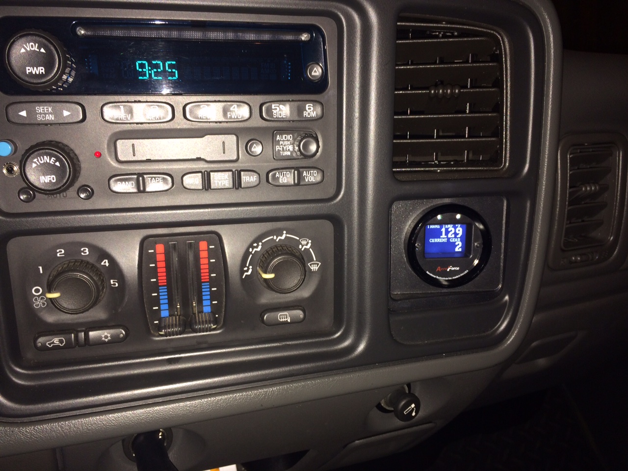

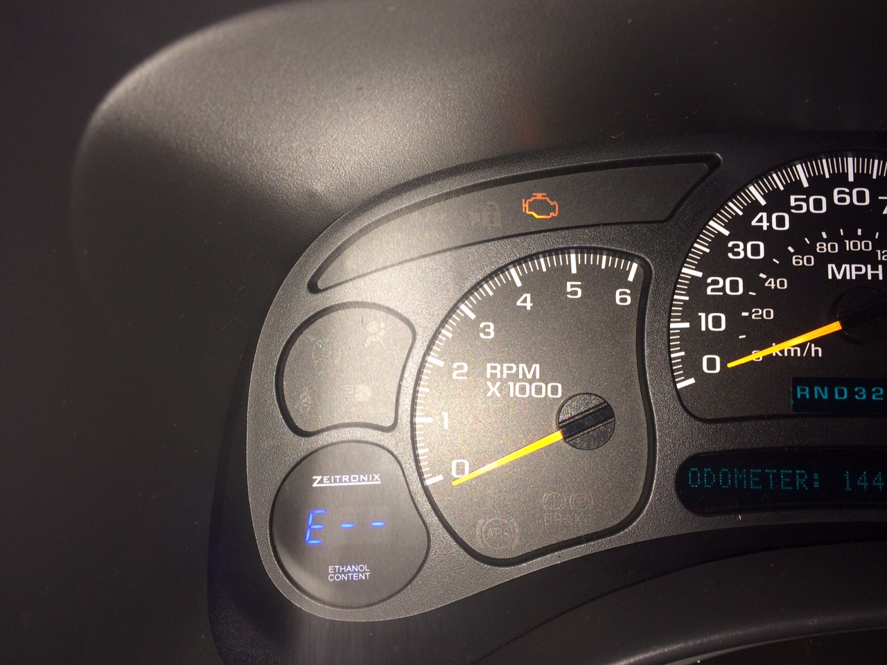

I did a small project tonight, I finished up mounting my Zeitronix ethanol content gauge where the empty gauge space is in the stock cluster. Lot of work getting that to fit right I'll tell ya! Looks bitchin in there. I also have my Aeroforce scan gauge to monitor trans temp / tcc slip or some other vital and I plan to mount a 2nd Aeroforce somewhere stealth for boost/ afr / fuel pressure. Haven't decided where yet.
