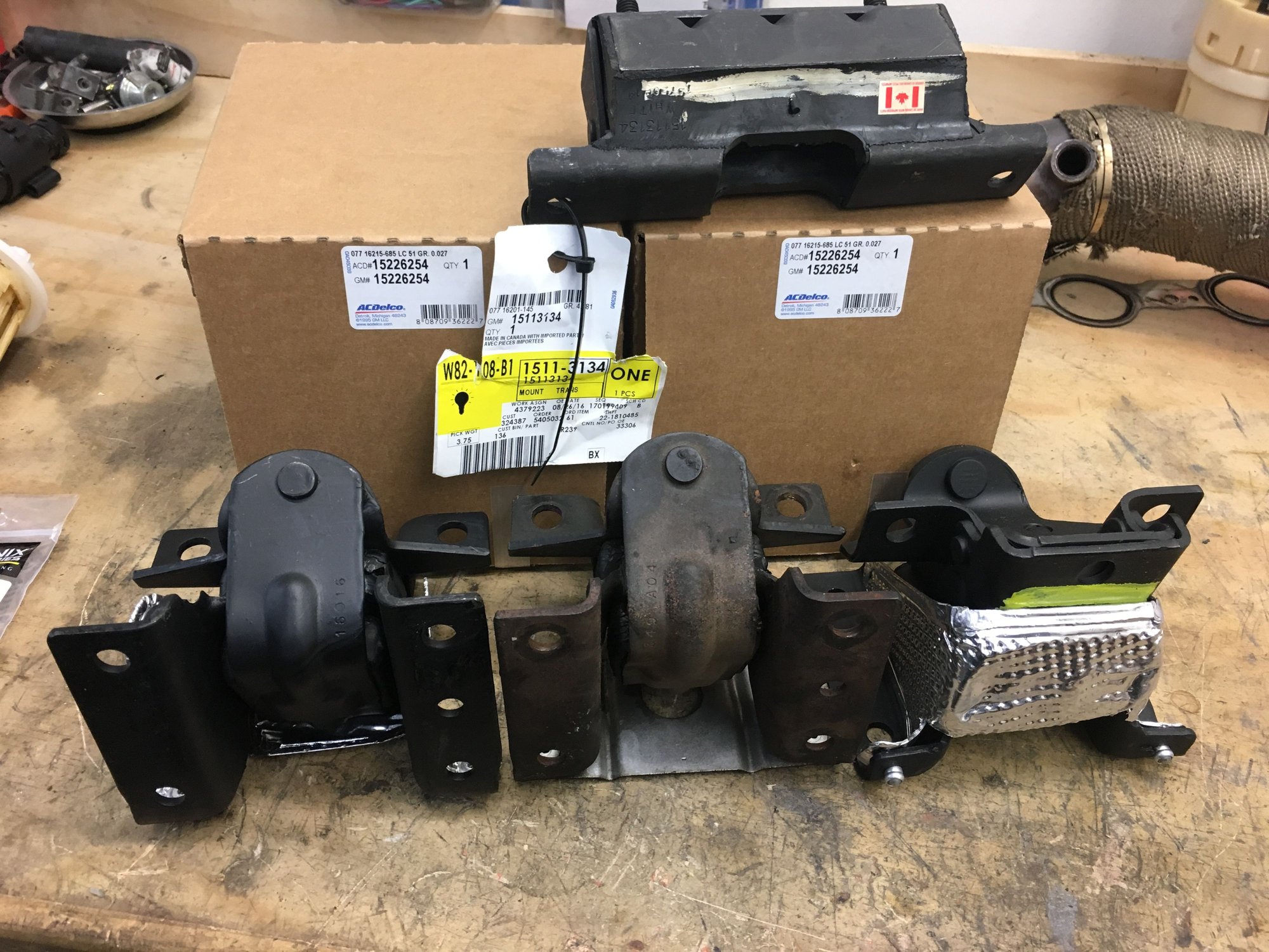

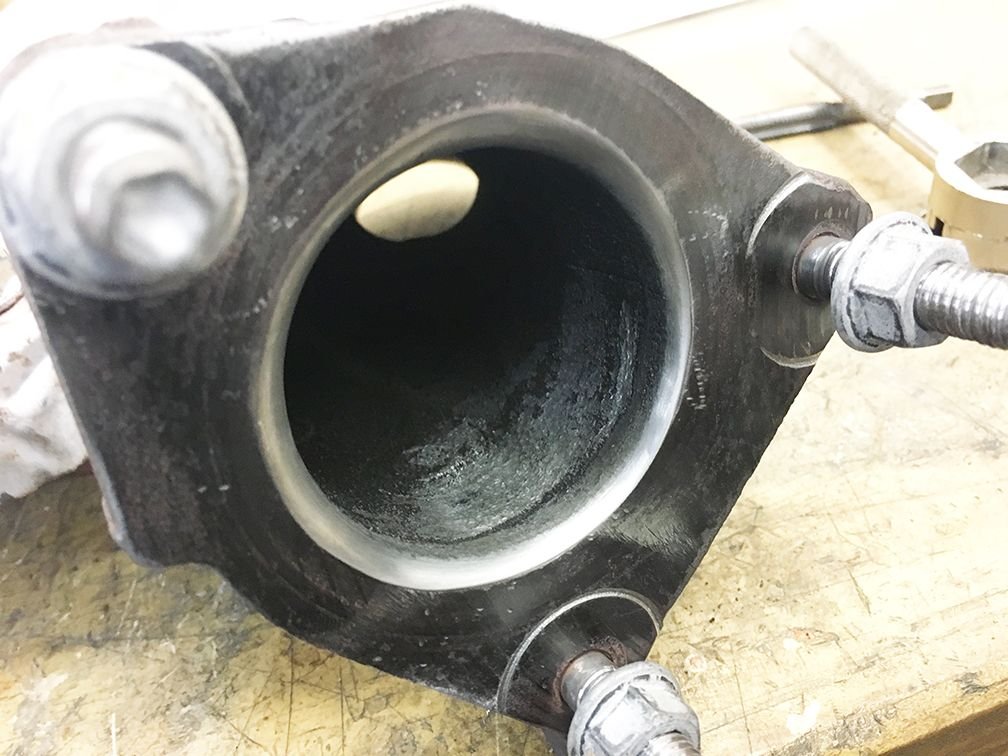

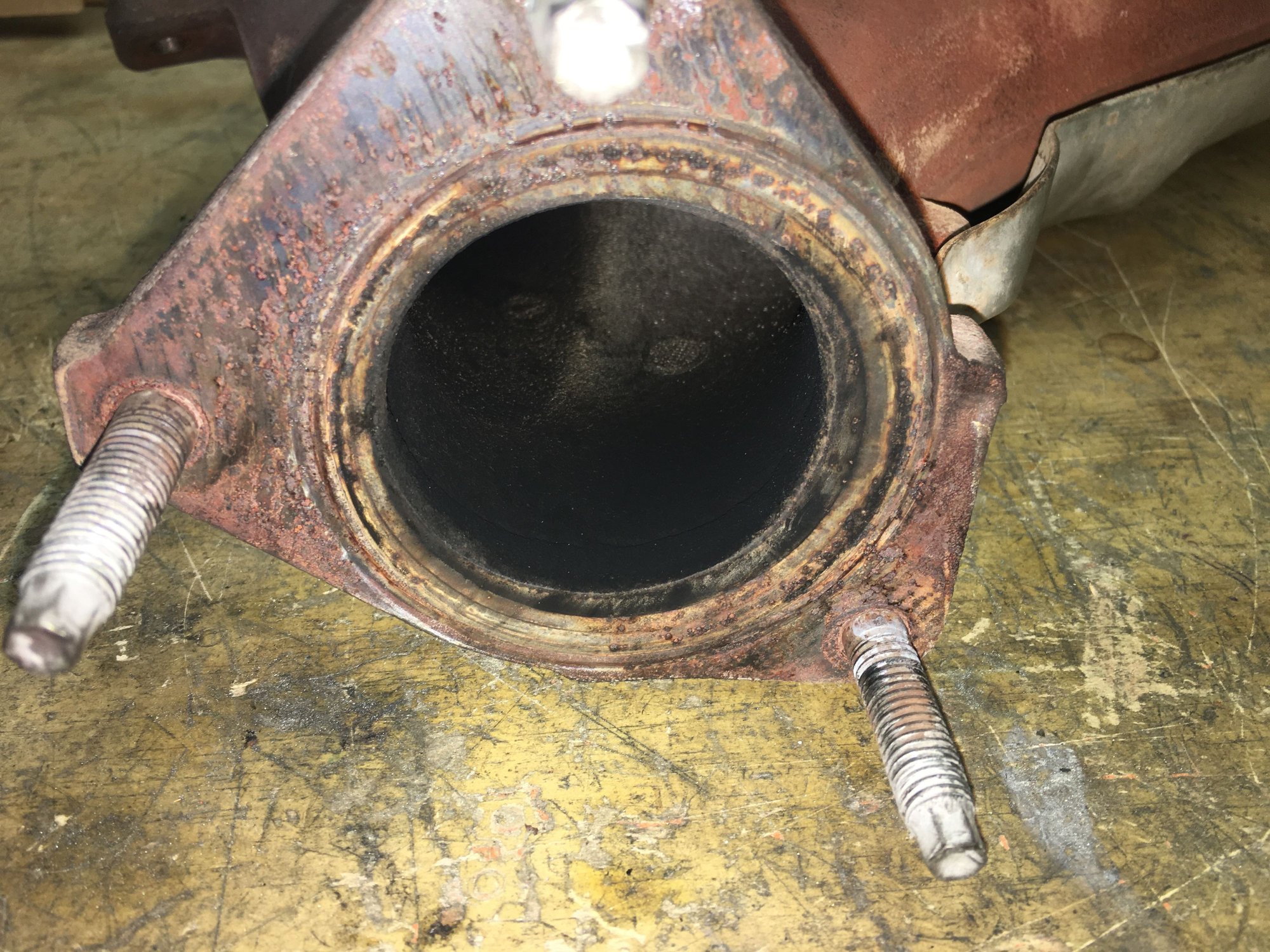

Recently I noticed that the front most bolt head on the turbo manifold had broken off, and I could see a little soot around the #2 cylinder port, so I decided to rip it all apart and take care of a few other things at the same time. New AC Delco motor and trans mounts, ARP exhaust manifold studs, AC Delco manifold gaskets. No significant changes but I might weld my wastegate flange directly to the manifold as no matter what I do I see soot at that junction after a few months of driving. I also took a few minutes to "port match" the driver's side manifold to the Trick crossover. I don't think it will be worth any power, but it was bugging me so I did it anyways.

Manifold after:

OEM motor mount next to AC Delco. Heat shield is a little different. Stock was still pretty stiff. I'm actually wondering if I even needed to replace these. And for what GM charges for these, I probably wouldn't have. Highway robbery. Motor mounts are probably made in Ching Chong but hey at least the trans mount is made in Canada!

Manifold was definitely leaking a little bit:
