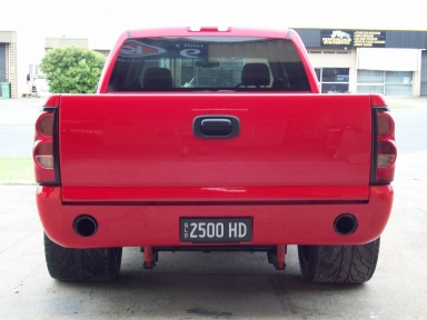

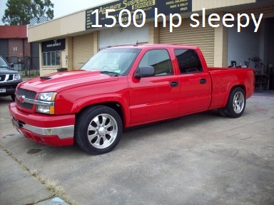

i dont think he was being a dick. i think he is questioning why put this drivetrain in a big *** 3/4 ton truck and why not a more performance oriented lighter weight single cab truck or something along that line. this is definetley a unique build and one that i would love to follow and see complete!!
I understand but there are a few differences with me I guess. One is Im a GM Truck Nut so it has to go into a truck, period. I have had a few RCs over the years, some fairly quick street ones 65, 71, 84, 98, 02, 03, 06, 09 amongst others and they have all been fun. I still have an 03 EC with a strong 632 in it, BUT I love dropped Duallys and dropped Crewcabs. They make smick cruisers in my eyes. I have had some tuff Street CCs and nothing like cruising out to the track doing a few runs and cruising home. Nothing like pulling up beside some guy in a Ricer in a 3 and a half ton truck and blowing his **** off. Sure I could go quicker with it in a half ton, but it will go ok and still make it interesting for most that will pull it on, be the street or track. Here is a pic of my 04 that had a 572 Steve Morris engine that went 1531 on 93 octane and 1673 on C16. Was a nice ride
