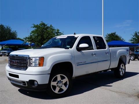

Just starting another Street registered build. Mainly a Saturday night Special and a few T&Ts a year. Just a bit of fun. Here is the truck. 2012 2500 Denali

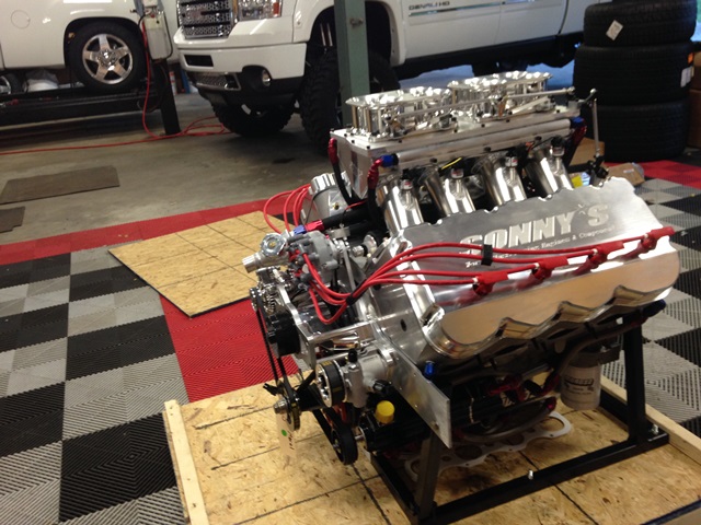

This is the engine 805 ci Sonny Leonard

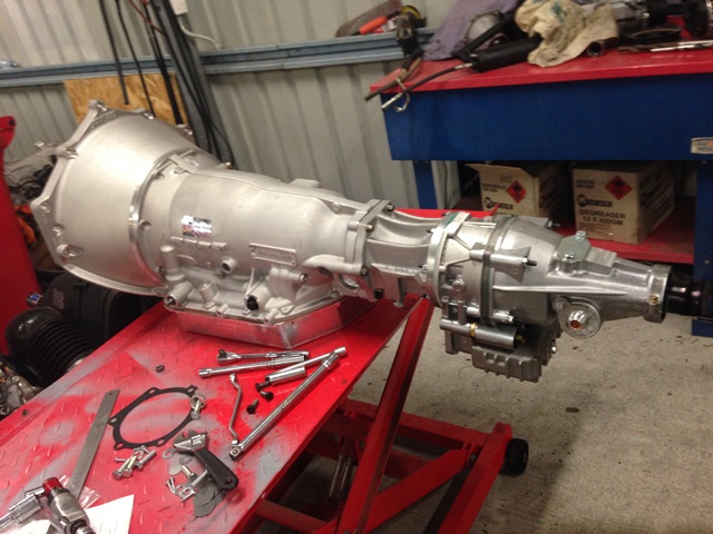

This is the trans. Protrans 400 with GV Overdrive with Reid Case

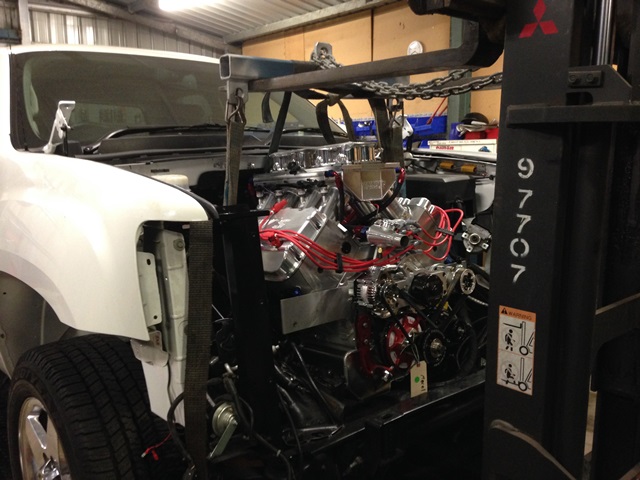

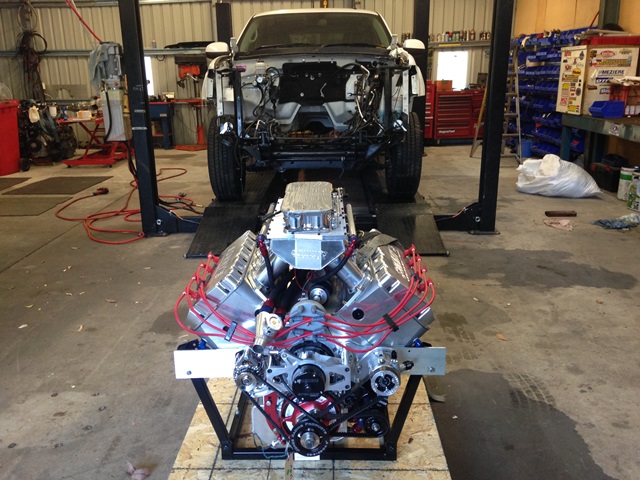

Rear end is 4 linked inside chassis rails. This is where Im up to last night
Attached Thumbnails My new Street Project-img_2390.jpg   My new Street Project-img_2407.jpg

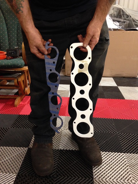

Going to be some fairly big head pipes. These gaskets are beside the ones off my old Steve Morris Procharged 572

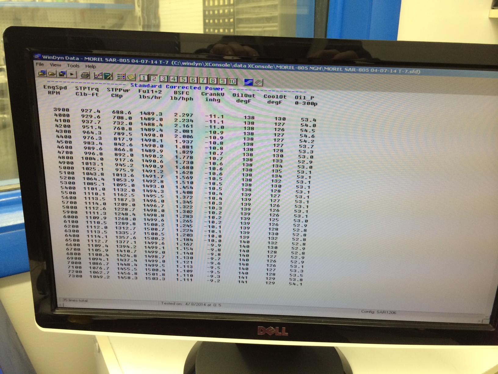

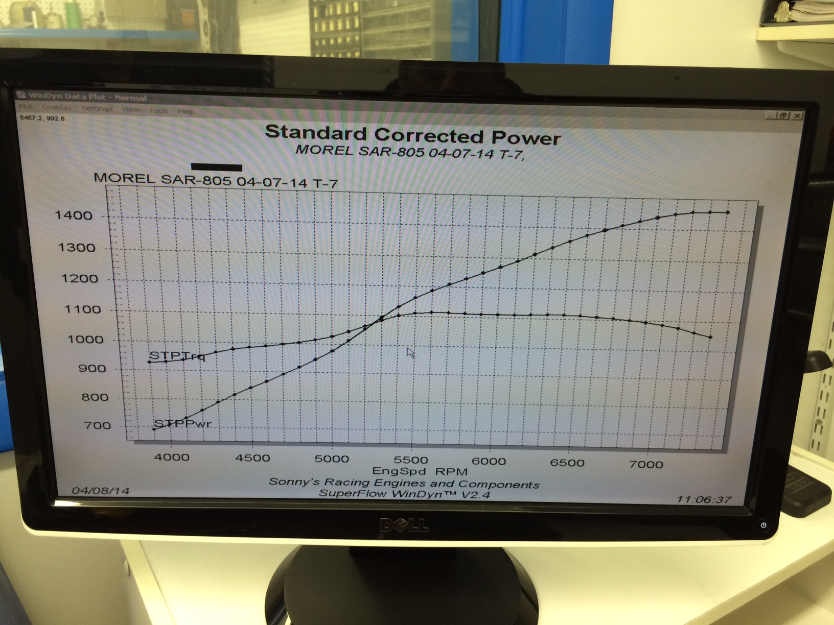

Not much. Looking forward to going n/a though. Havent been there for a while over 1000
Attached Thumbnails My new Street Project-cid_1_2718550595%40web164503_mail_gq1_yahoo.jpg   My new Street Project-cid_2_2718550595%40web164503_mail_gq1_yahoo.jpg
