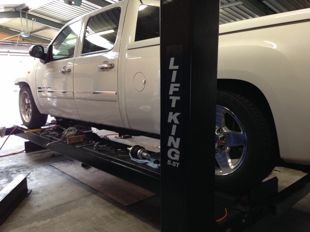

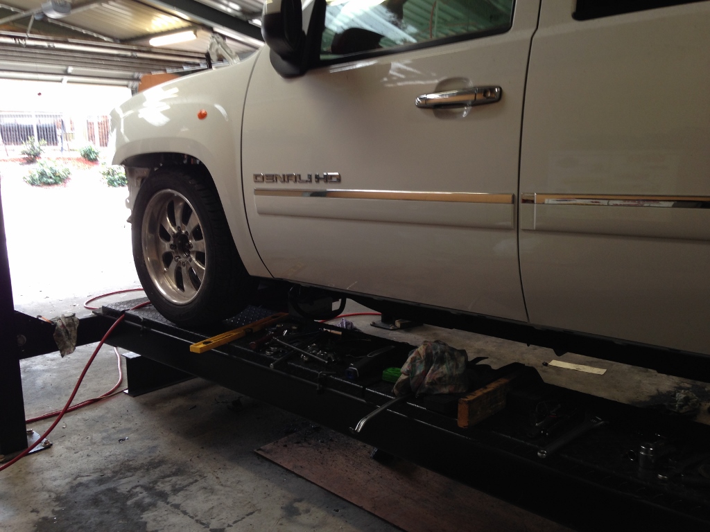

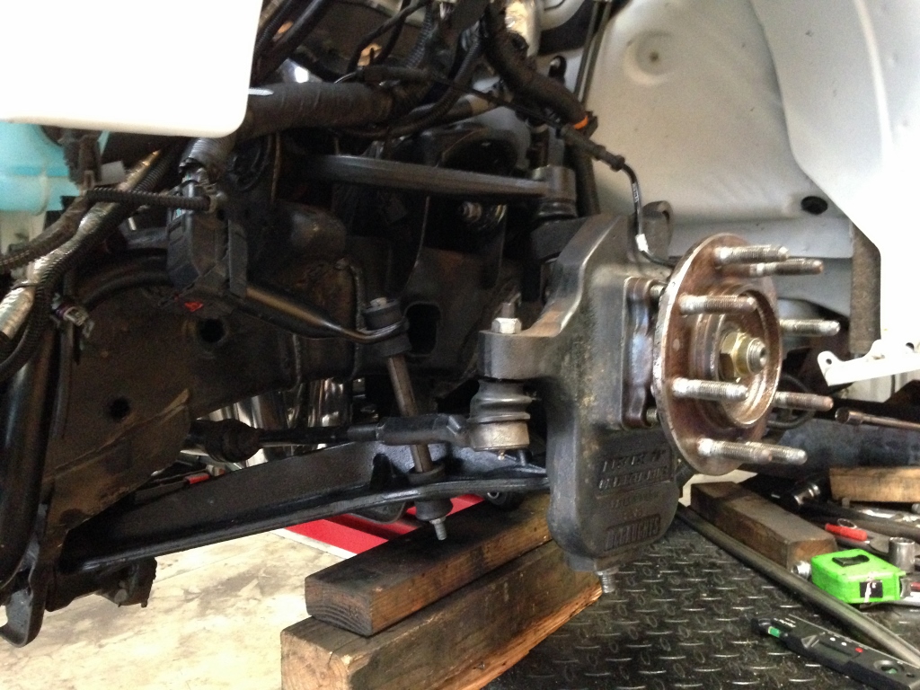

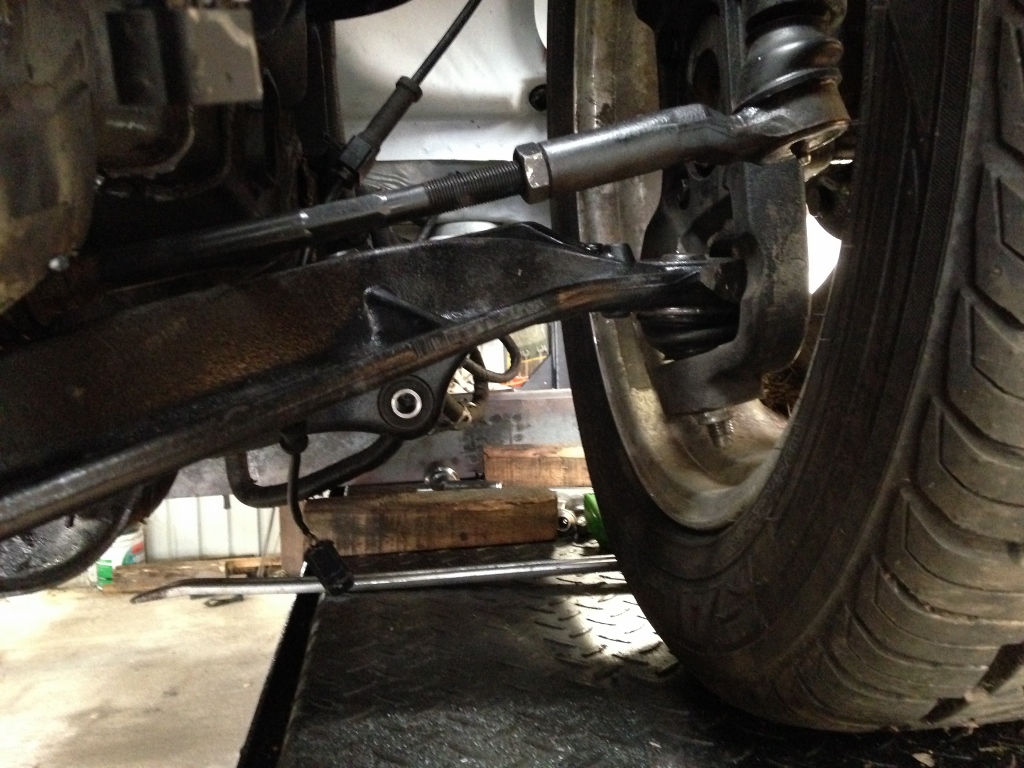

Got the ride height where I want. McGaughys 2" dropped Spindles off 2004 2500 with 165 x 8 studs. The Spindles are app 4" shorter than the 2012 Stock Spindles. I turned the 2012 LCAs upside down and put on opposite sides and put the 04 Balljoint in (Had to turn up bushes as hole in LCAs are slightly larger) When turned upside down and on opposite sides the height difference is app 4" so I have ended up with about a 4" drop and my Balljoints at app 87 degrees, so works good and wheels stand at 90 degrees being right in the centre of the Camber adjustment. I have about 4" of suspension travel which is all I need. Just have to make up the Air Spring Brackets now and clean up some other bracket removals.The Brembo Brakes arrive Thursday that will bolt straight onto the 04 Hubs. So I end up with 2012 GMC 2500 lowered 4" with good geometry and ride and being able to run 15" 6 Spot Brembos. This is what I was after.

Wow...props for making that work! You may still get some bump steer from the tie rod angles.

Yea I was thinking the same. I will try and if its too much I have a couple of options for that to get them on a flatter plane
