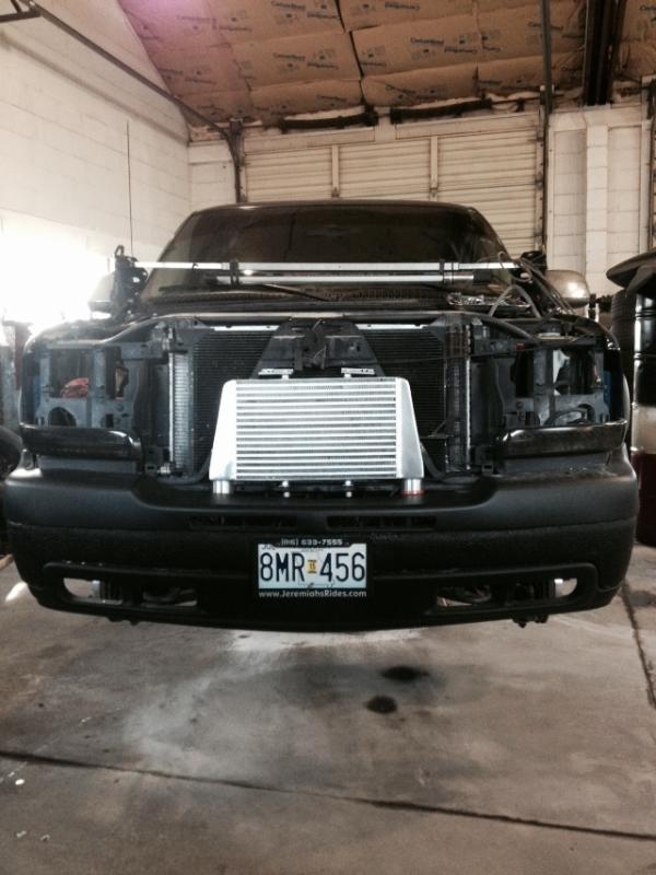

Was board and installed the intercooler

Question how much bigger of a trans cooler is needed for this set up I removed the factory one the issue I really don't want to put it in front of the intercooler would it still cool ok if i put it in between the radiator and condenser?

Get a tru cool 40k. Don't you have room in front of the condenser?

Looking into the tru cool and no there is no room im thinking of moving the intercooler out and squeeze it between there

What intercooler is that? Which turbo also?

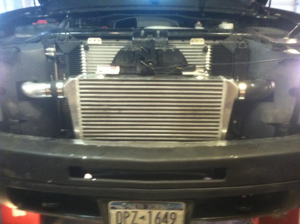

I put my 40k behind my front mount and it works great. I mounted it as high up, just about flush w the top of the rad, as I could to keep air flow through it as much as possible.

Interesting I wonder if something is bent on mine i'm not finding, because my condenser is almost touching the hood latch frame
