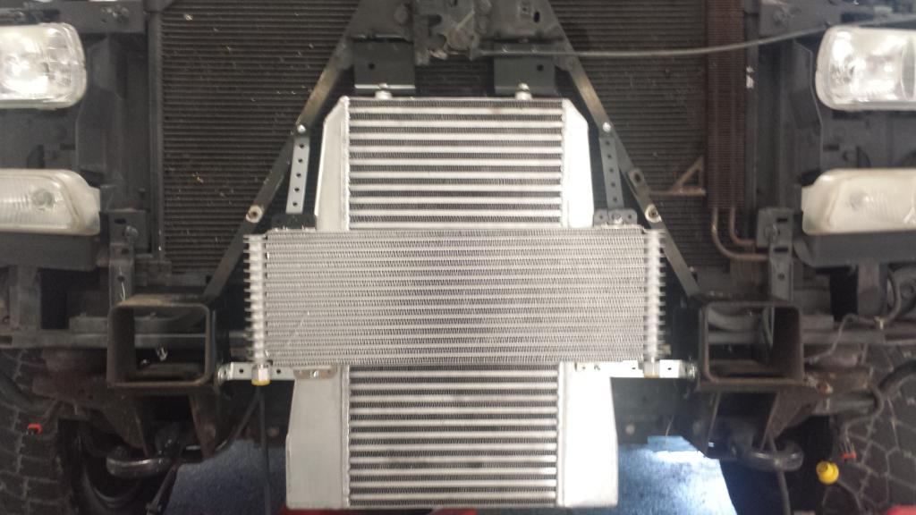

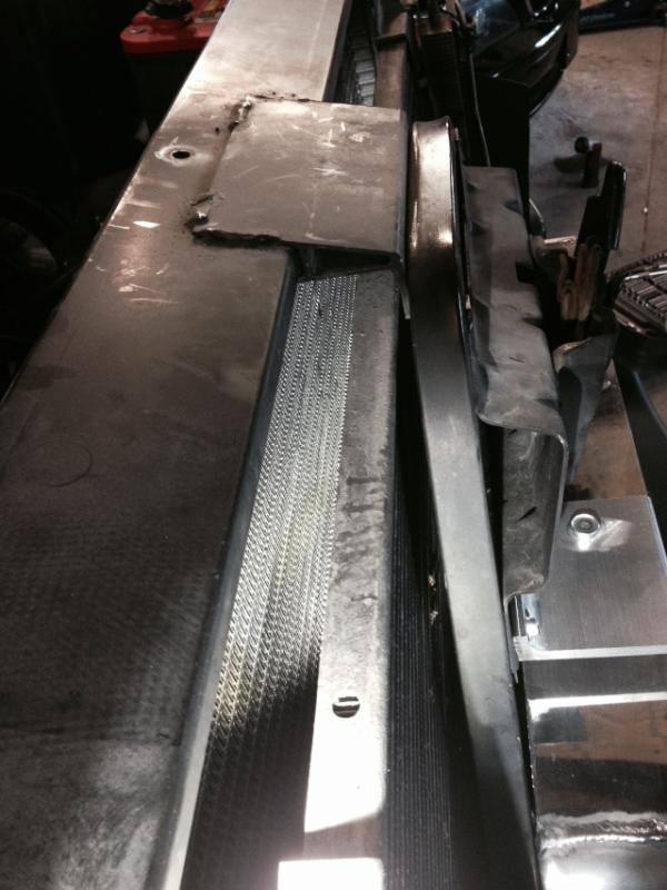

Here a pic showing about half a quarter of room
There is tons of room between the radiator and condenser anyone think this would cause a problem if i put it there

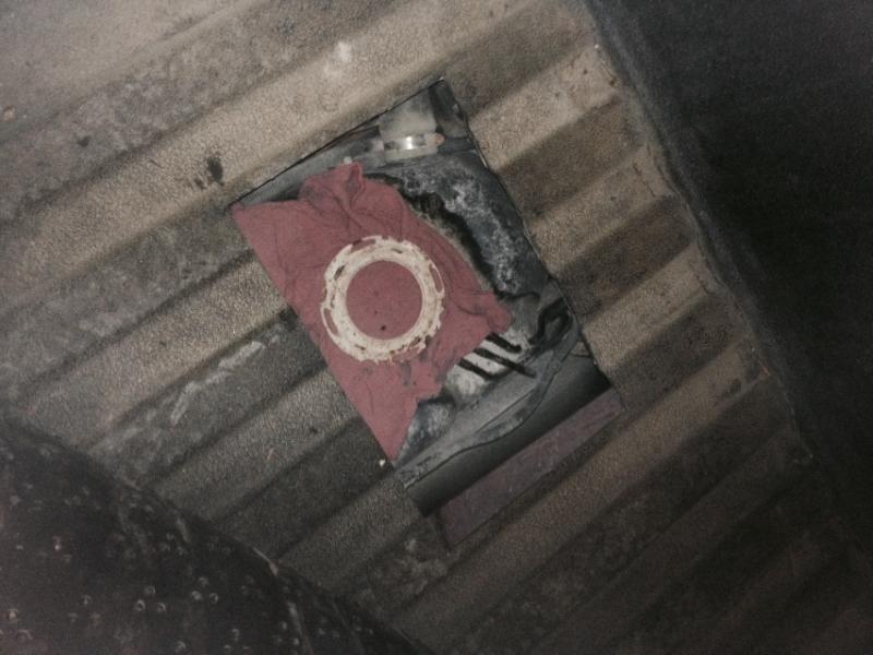

Little update cut hole in bed to easily remove sending unit I have a old wrecked bed im going to cut for a block off plate

Originally Posted by zaathur151
Interesting I wonder if something is bent on mine i'm not finding, because my condenser is almost touching the hood latch frame
different body style trucks too. Mine is a 09 which is NNBS

Could possibly mount it down in the bumper vent...
although if you do mount it in that gap between condenser and radiator it may possibly increase the efficiency of your fans. I could be wrong though.

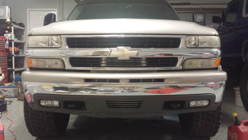

I have the same front end on my Suburban and this is how I mounted mine.

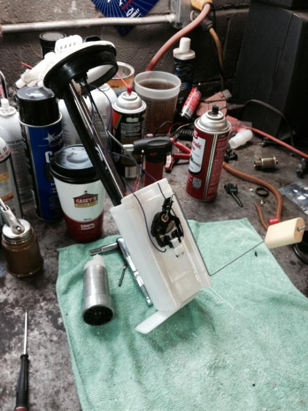

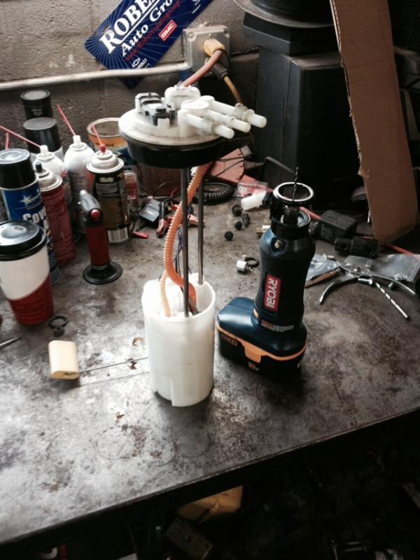

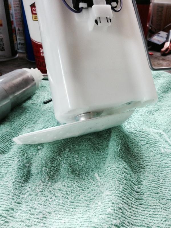

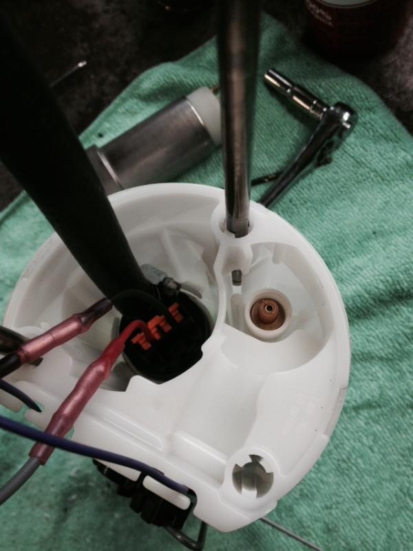

another little update walbro 255 fuel pump is done pretty easy
