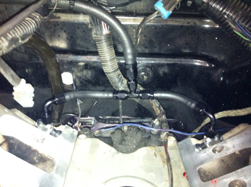

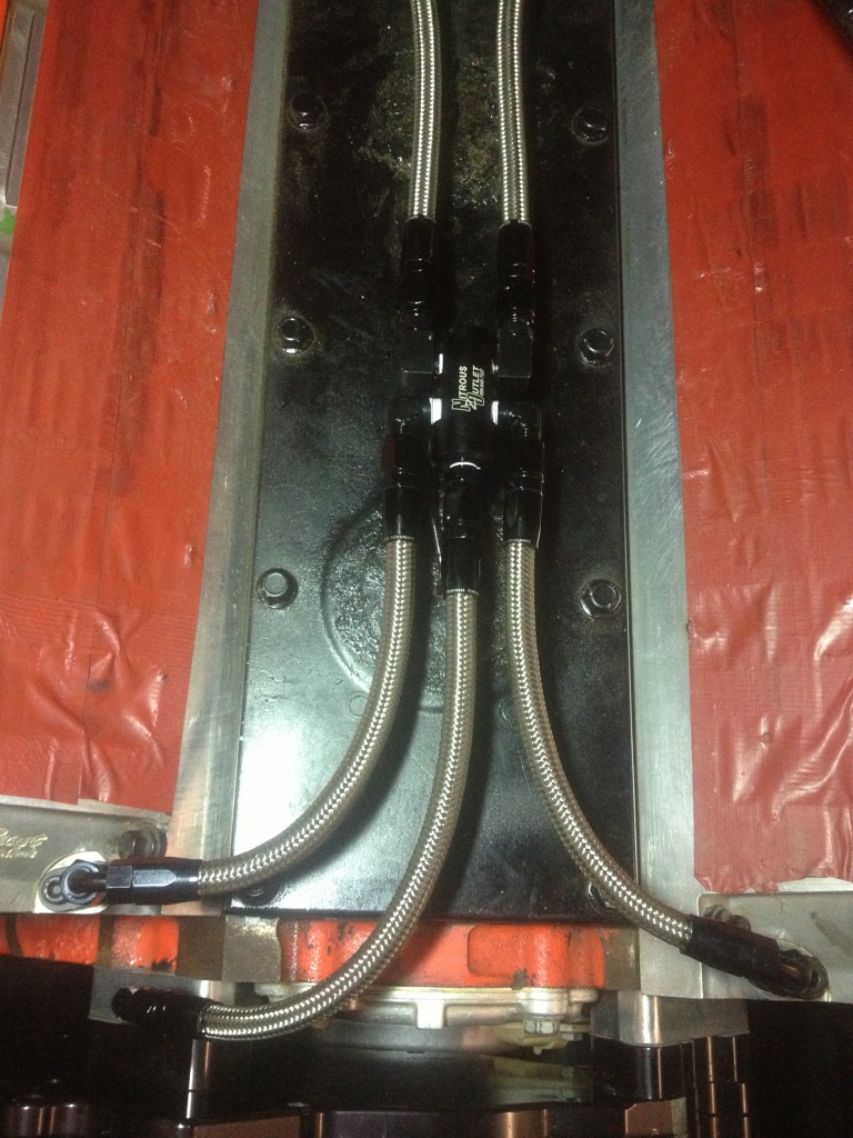

Yea here is my current setup
Back returns to coolant tank
Front goes to radiator

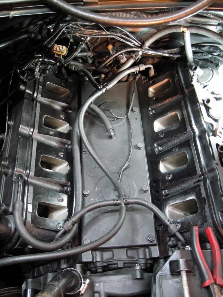

From: DFW, Texas
This is how I ran mine.

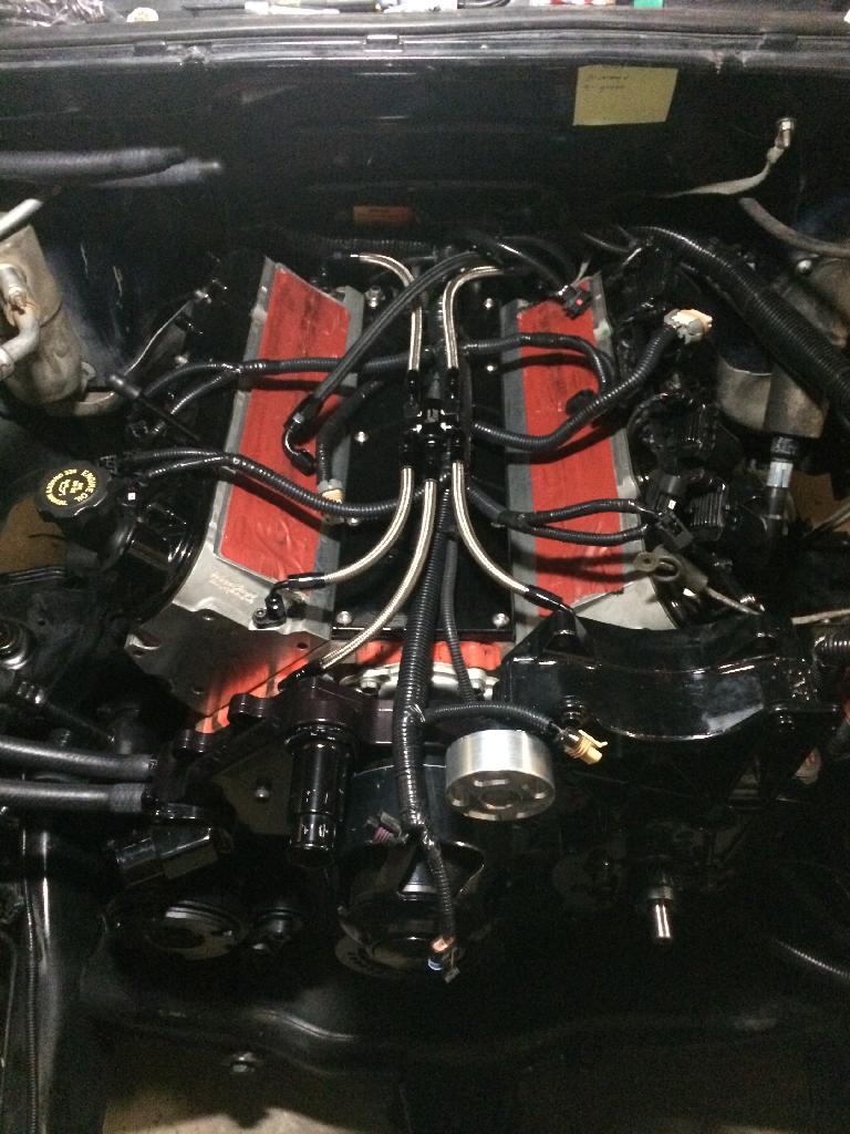

Just redid mine to this:
