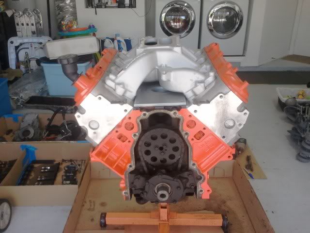

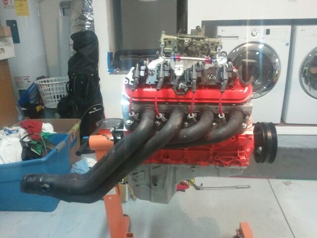

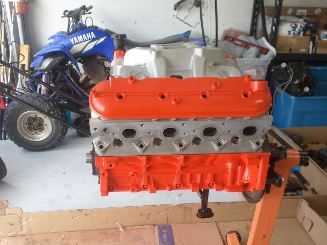

Did a little mock up to see where I need to paint more

Looks good. Makes me want to paint my motor!!

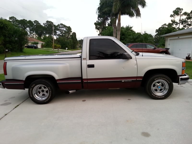

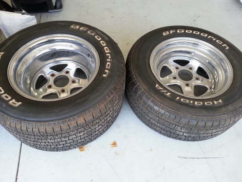

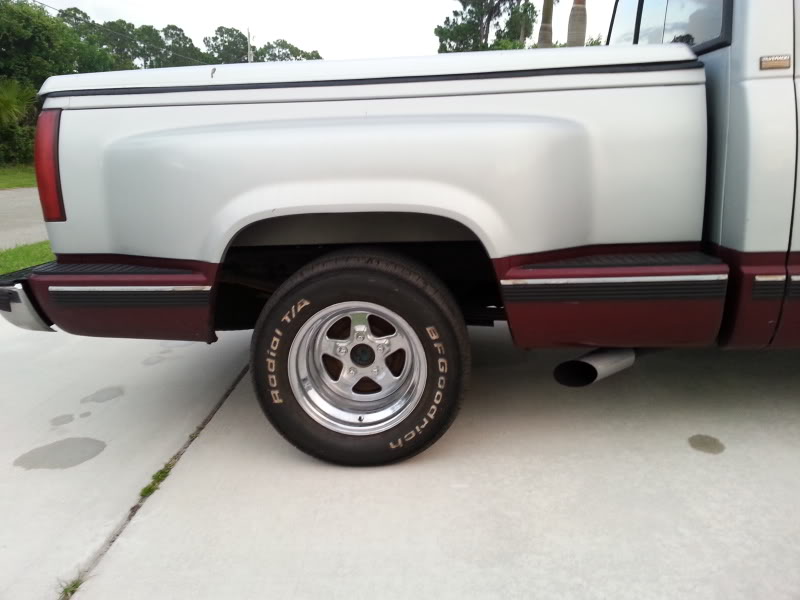

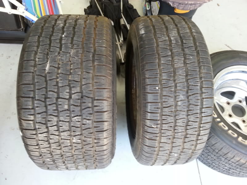

Some updated info and pics:
A little update, I just ordered a PerformaBuilt Level 2 Pro race 700R4. I can't wait to get it in and installed. I also got some new rims and tires. Weld Street Stars with BF Goodwrench Radial T/A's 15x10 in the rear with 295/502/15's and 15x8 in the front with 245/60/15's. It's starting to come together. Even with the wider tires it will go sideways at 40mph. I need some slicks and weight in the back.

Old Jun 26, 2013 | 12:36 PM
RabidStreetRacer's Avatar
Joined: Jun 2006
Posts: 462
From: Florida
My mistake, they are the Cragar street stars, not Weld Racing rims.

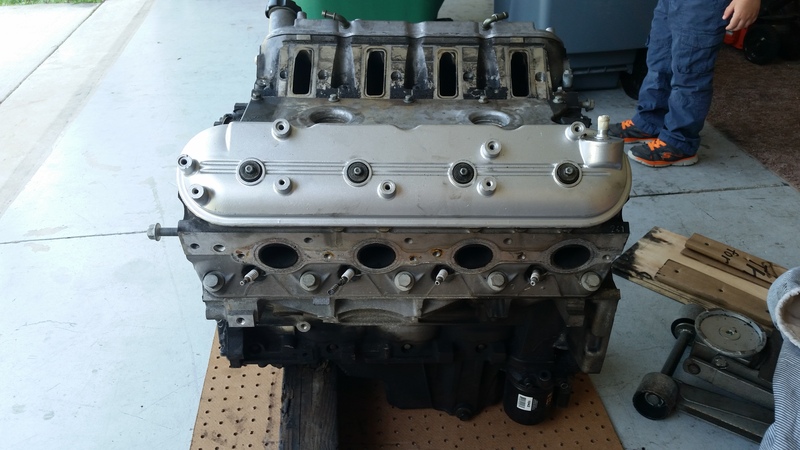

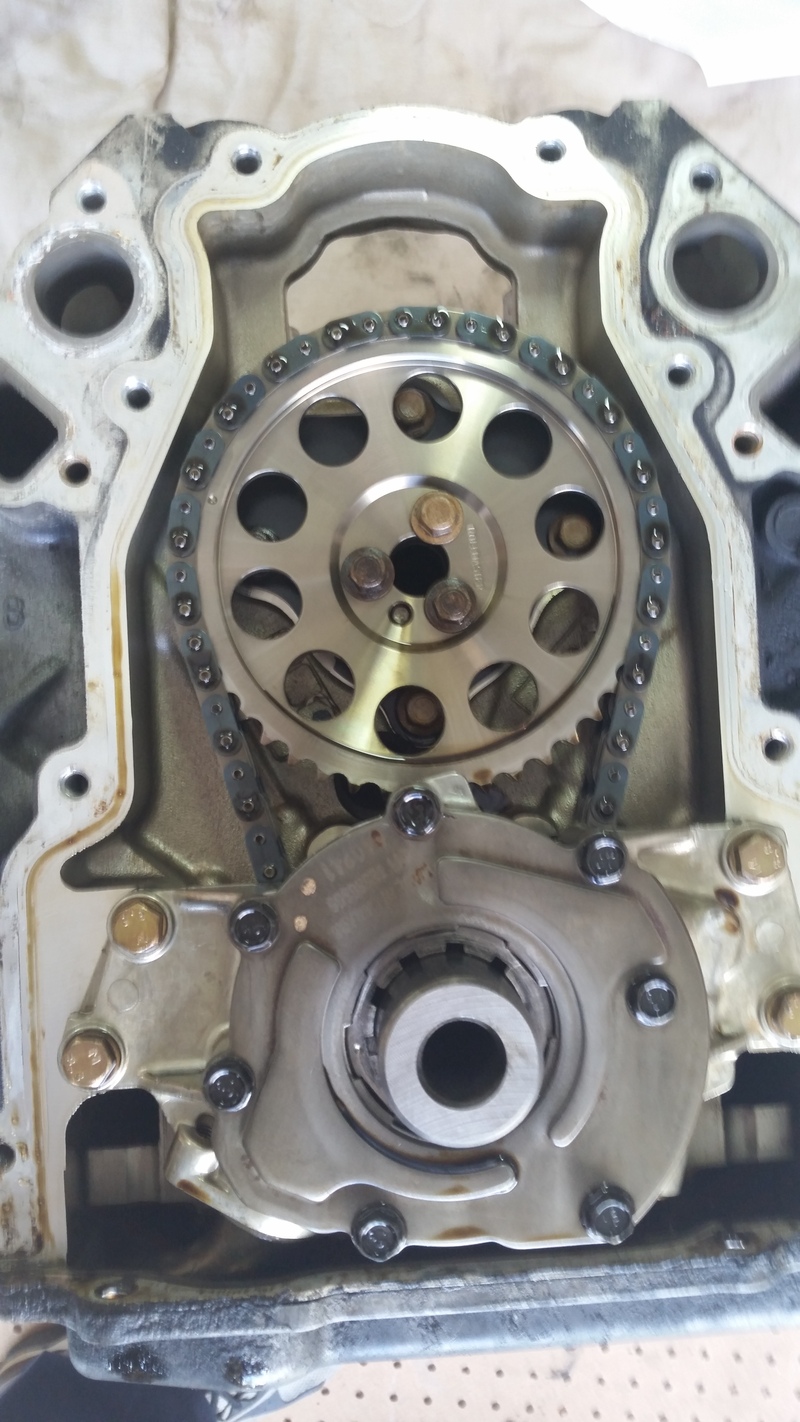

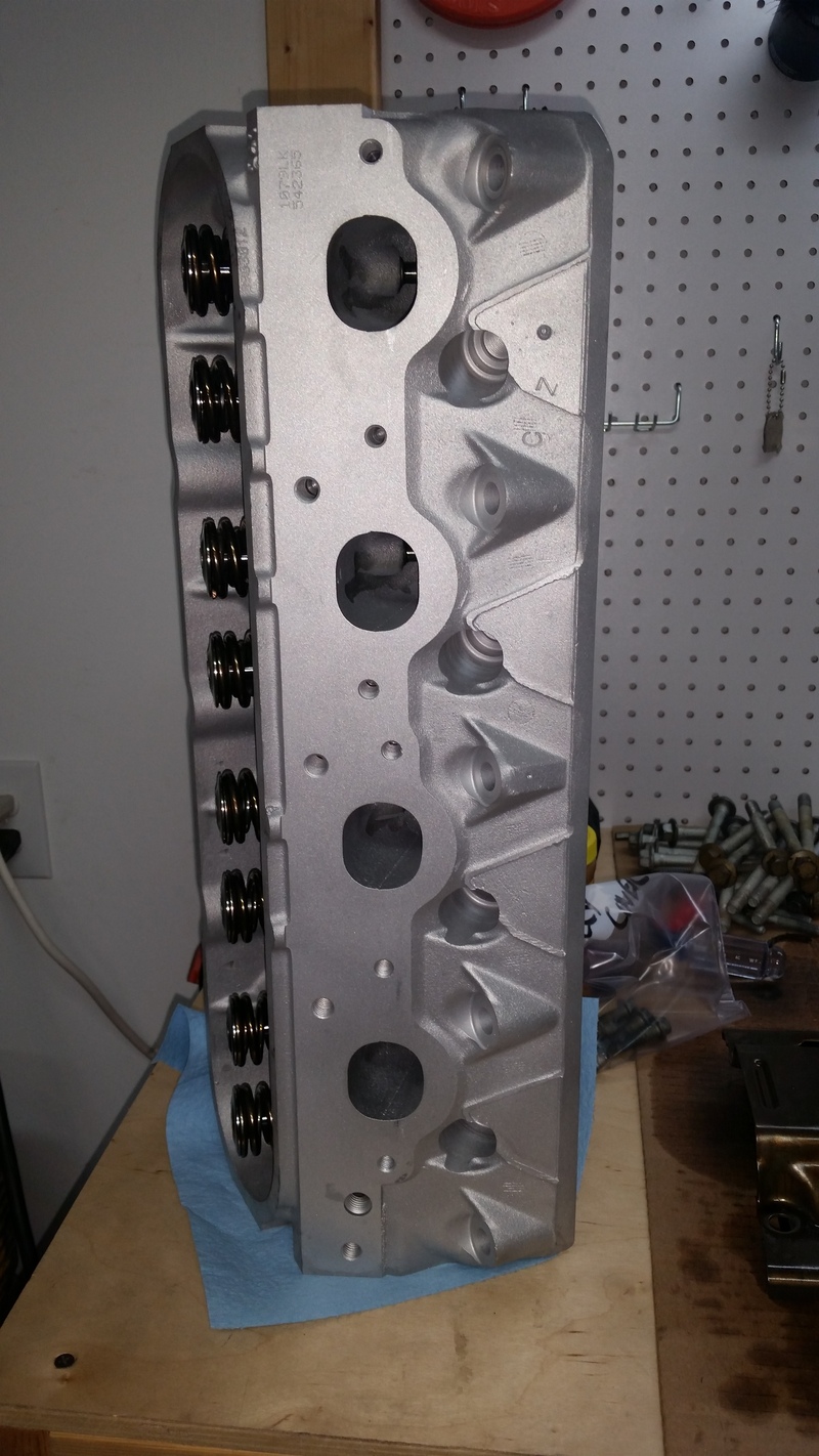

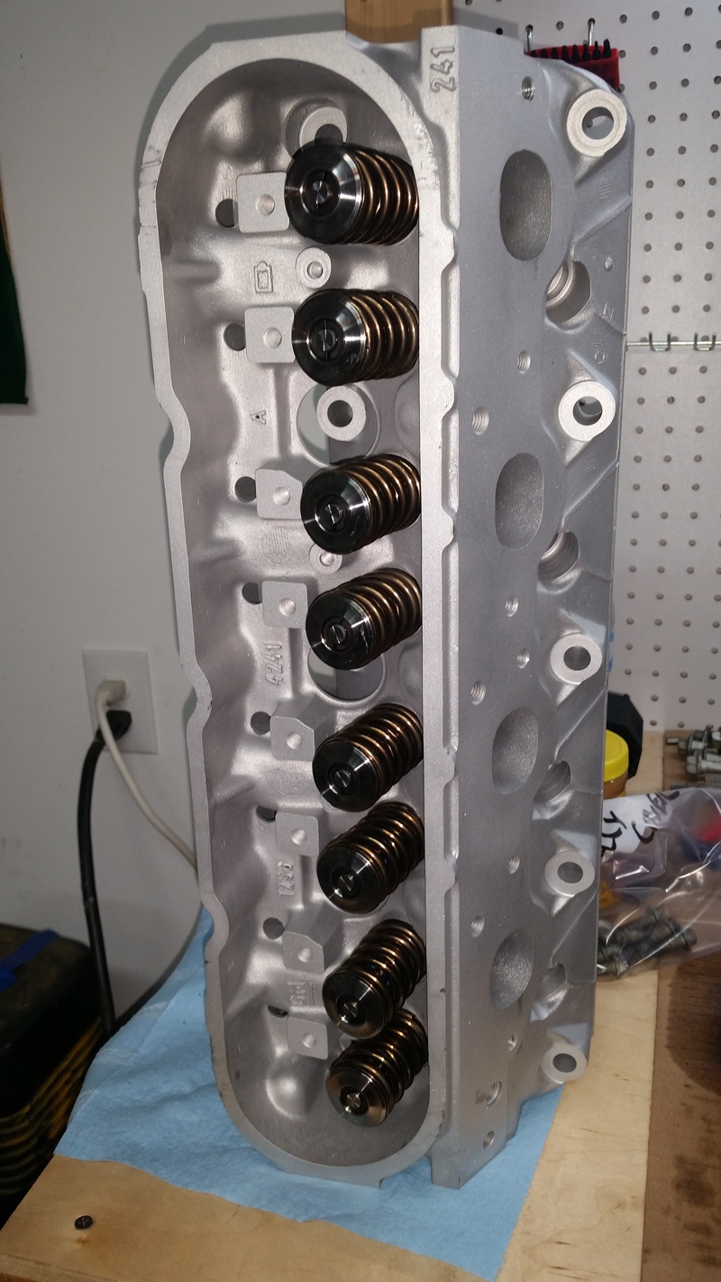

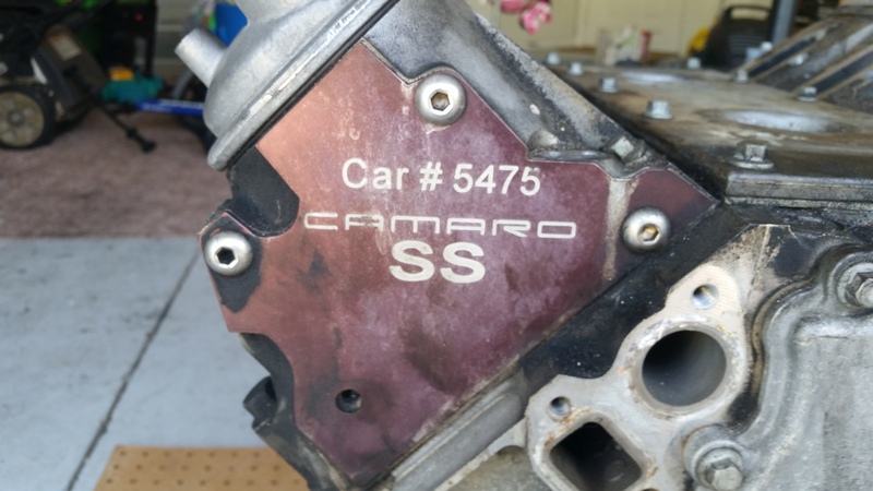

Update.

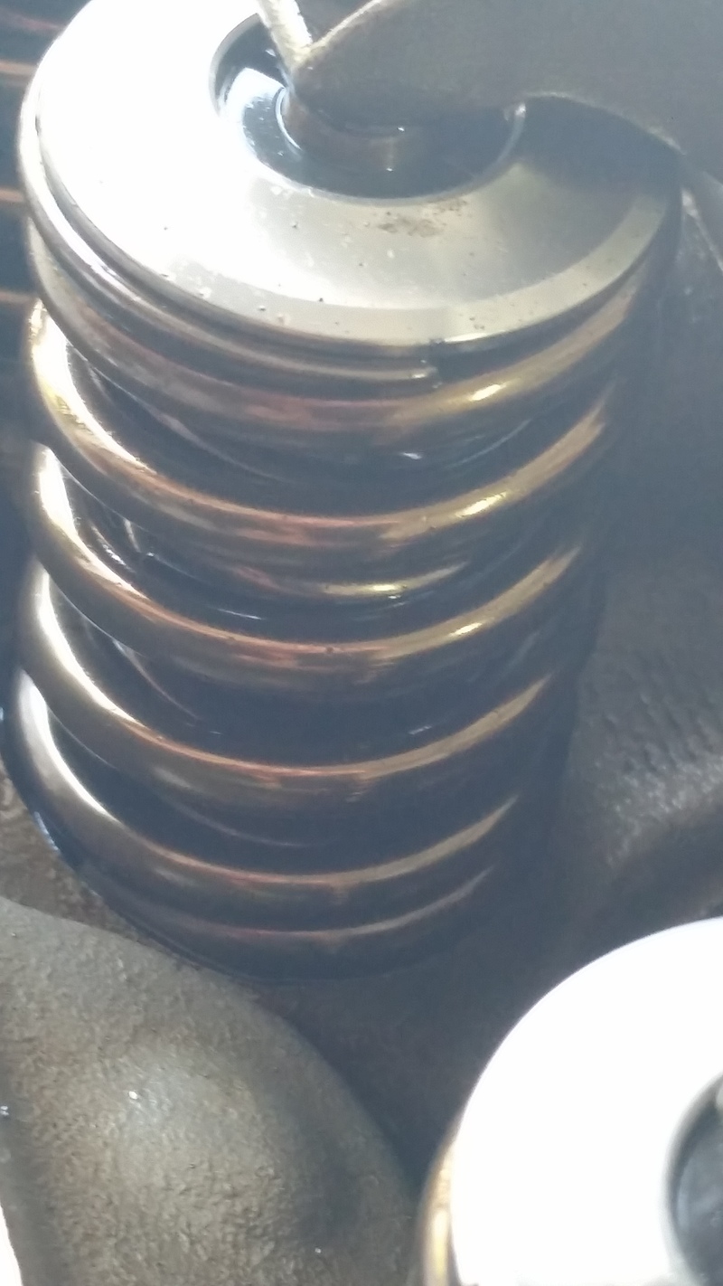

Got the Detroit Truetrac diff, 4.30 motive gears and monster stage 4 clutch kit installed. Truck was running awesome until I broke something in the short block. I was anticipating the bottom end to fail. This vid is the first time I got on it after breaking the gears and diff in. It hit the 6,800 rpm rev limiter faster than I thought it would.
In the next two weeks I will be installing a 2001 LS1 out of a Camaro SS. Has 68,000 miles on it.
241 heads with a valve job and milled 0.020.
Cometic 0.040 head gaskets to have a CR of about 10.8 to 1.
Comp Thumpr Cam
Edelbrock Performer RPM intake
Holley 750cfm carb
2" Primary Long tubes
New lifters
other small goodies
If I don't break into the 11's with this setup I am gonna throw a 150 shot of Nitrous at it.
