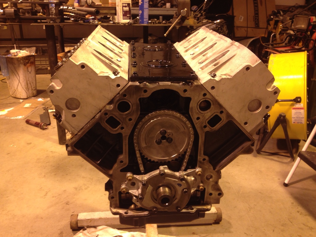

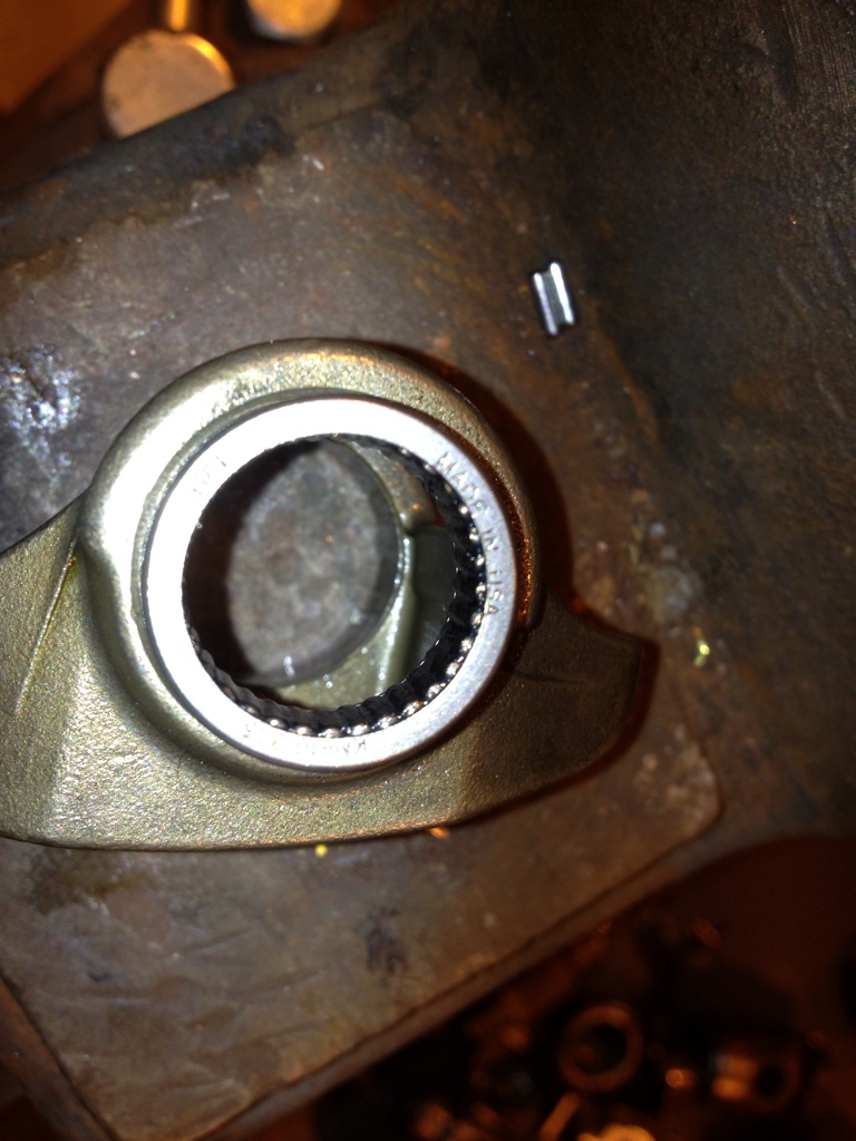

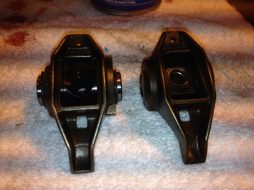

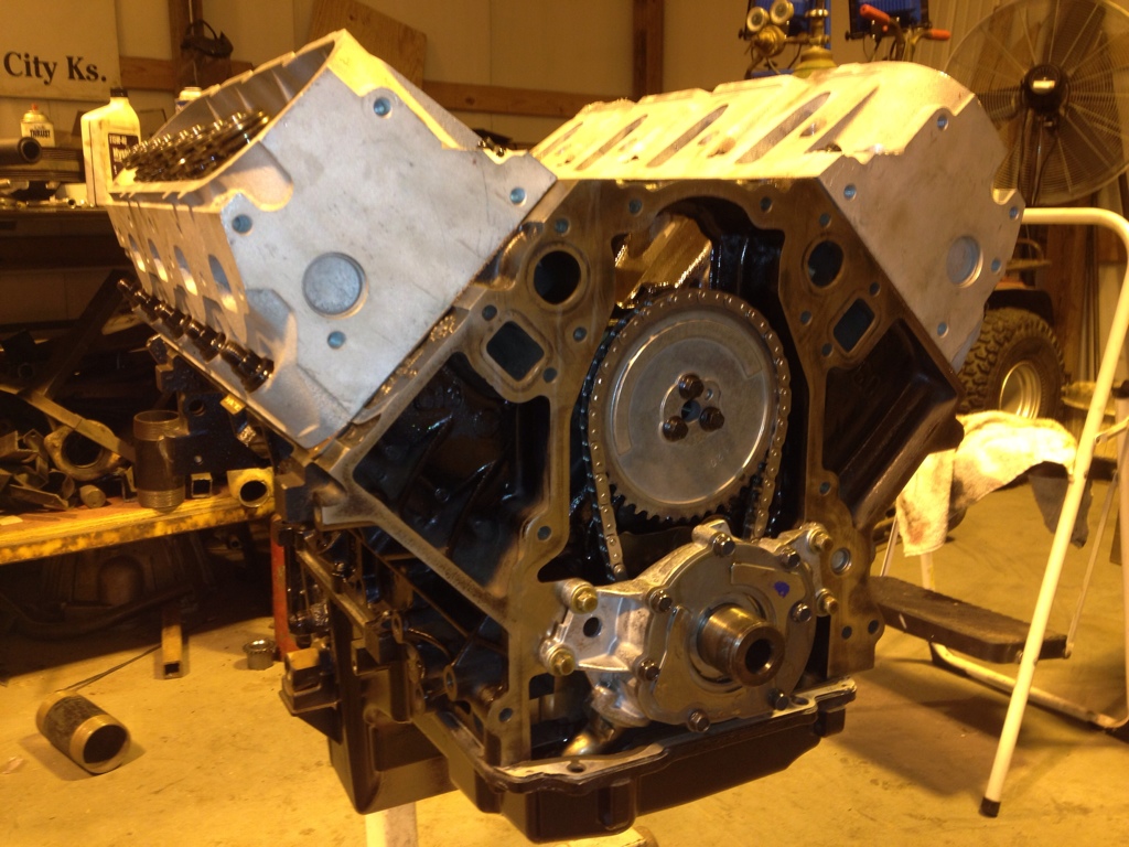

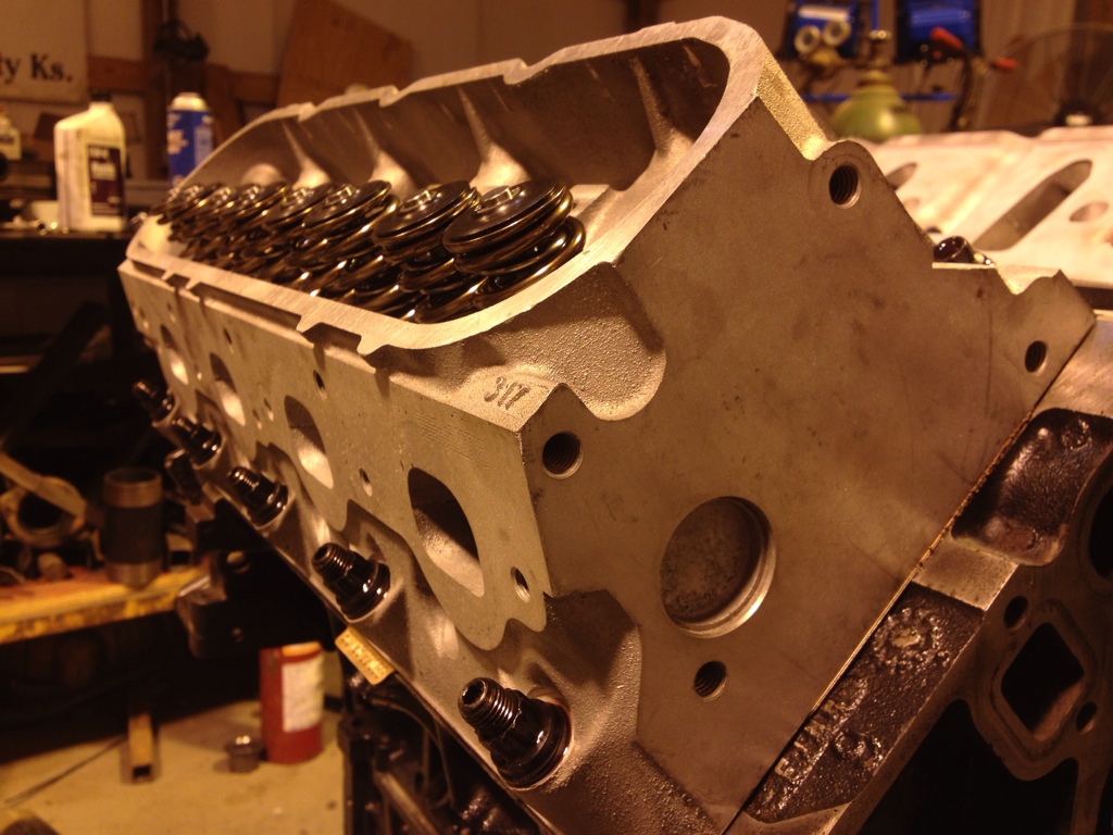

Got the heads put on the motor yesterday and measured for pushrod length. Also upgraded the trunions with the replacements from COMP. Super easy and worth the money in my opinion. Took me about an hour with a hammer, 13/16 socket, a punch and a vice.
Stock insides of the factory rockers
New bearings. MADE IN USA. 'merica
Upgrade vs. factory

Looks nice! I have done a few trunion upgrades for some customers, seems to be a good upgrade for the money! I prefer stock rockers so a bearing upgrade makes them even better lol

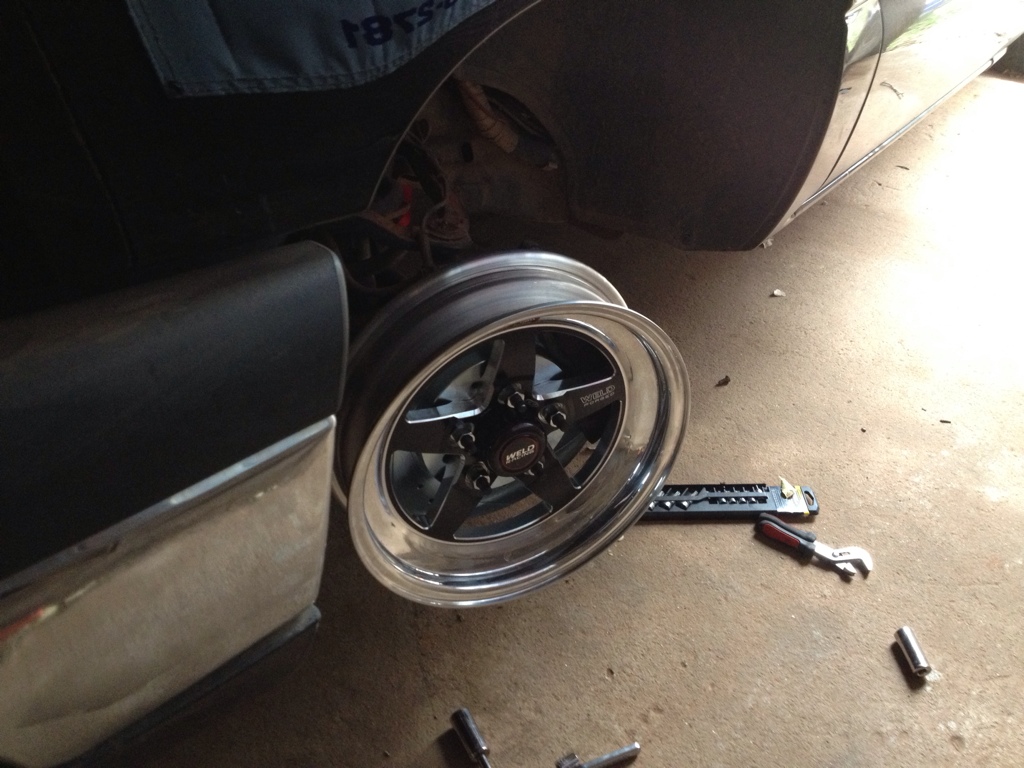

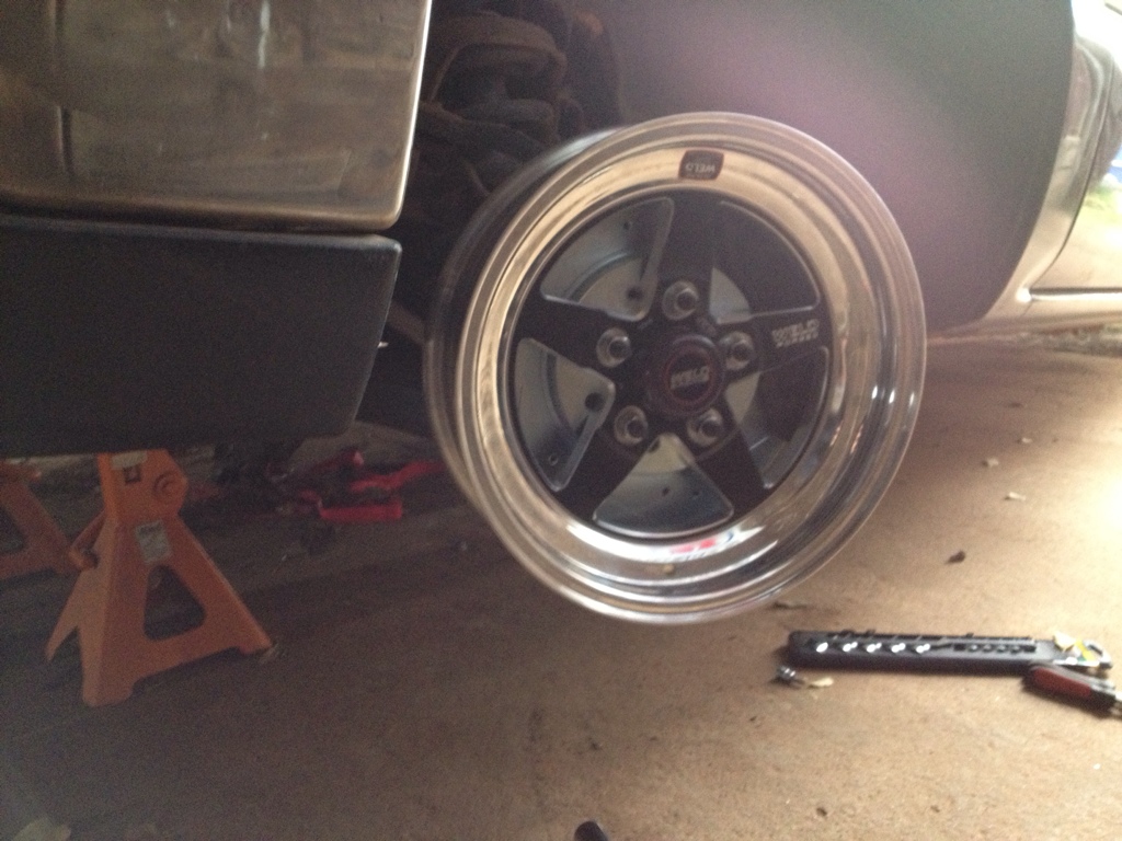

Test fit the new front wheels this mornings. They fit!

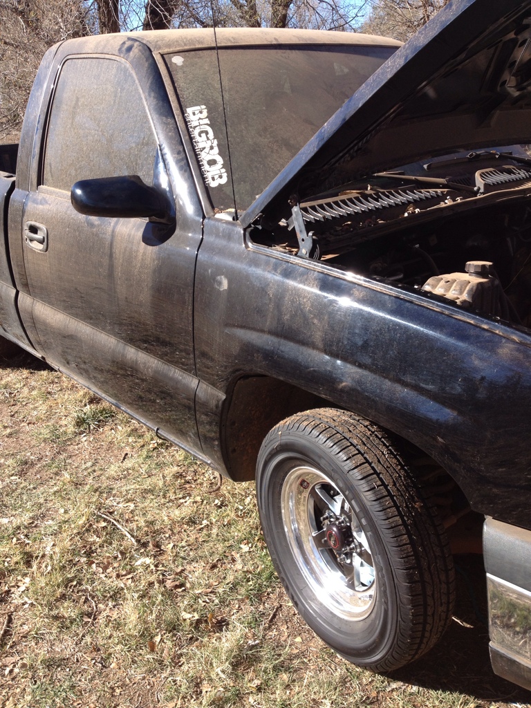

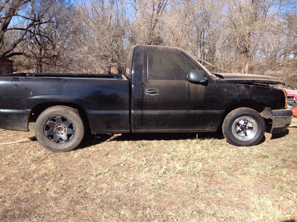

Finally got the front wheels on and was able to push the truck outside for the first time since July.
She's a dirty girl

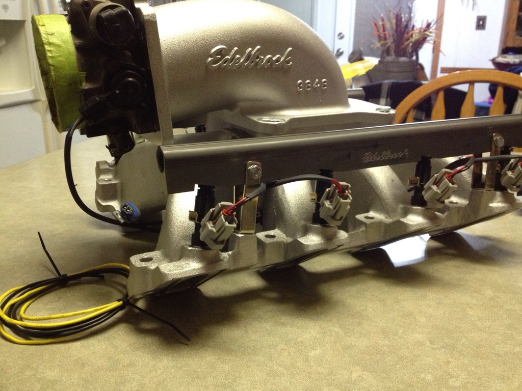

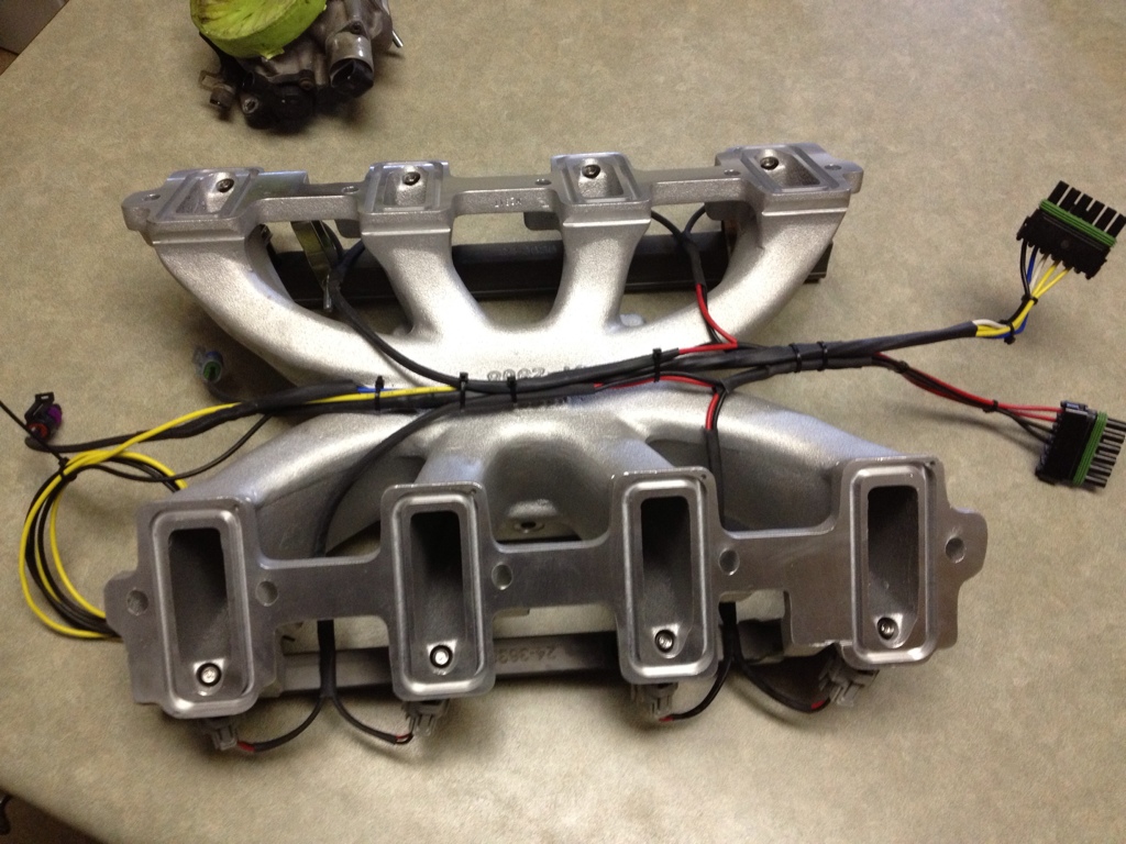

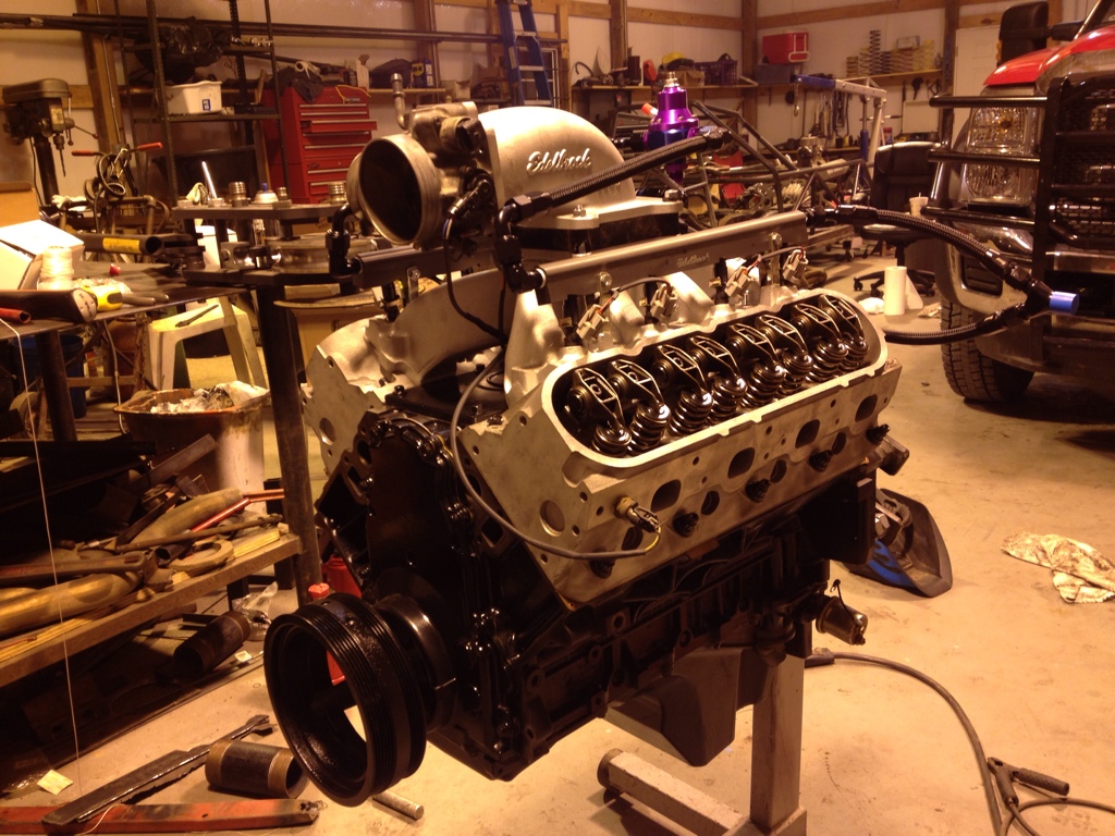

Also got the wiring harness done for the fuel injection. Injectors, TPS, IAT, ECT

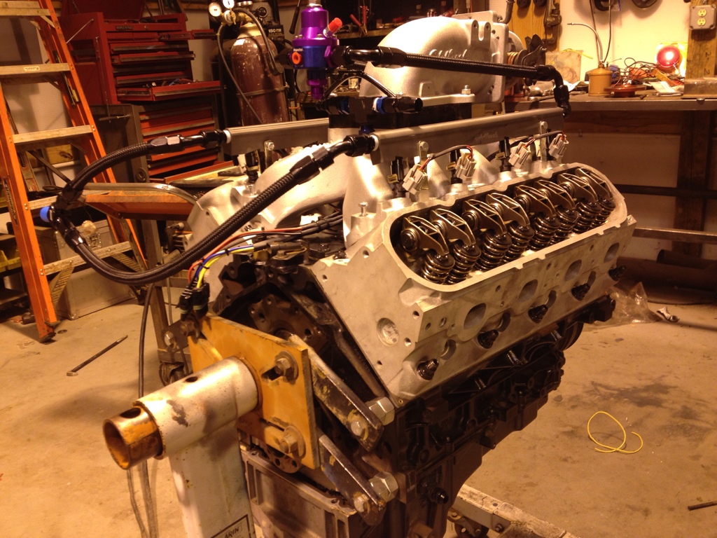

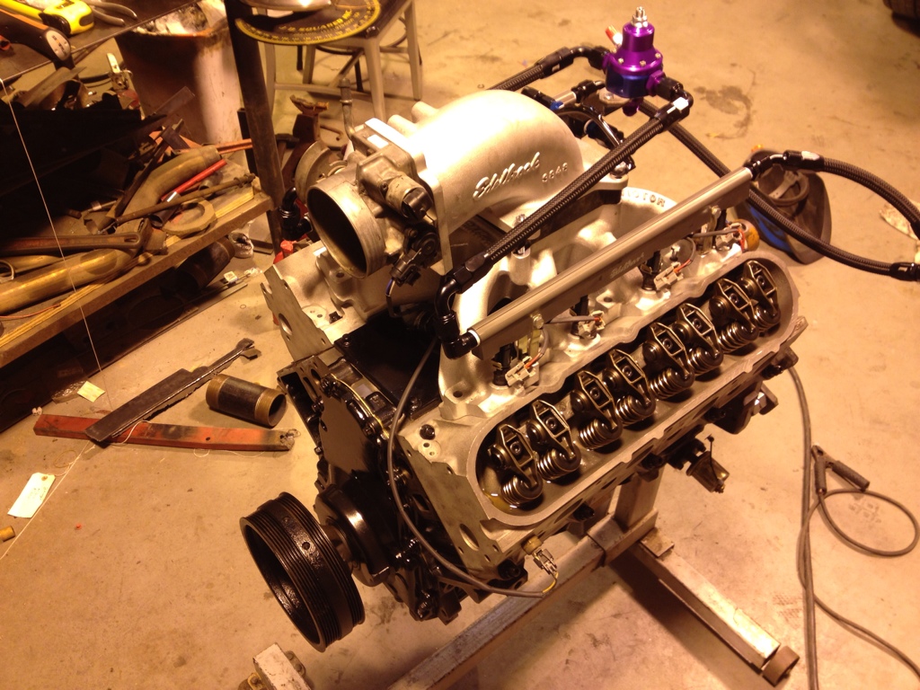

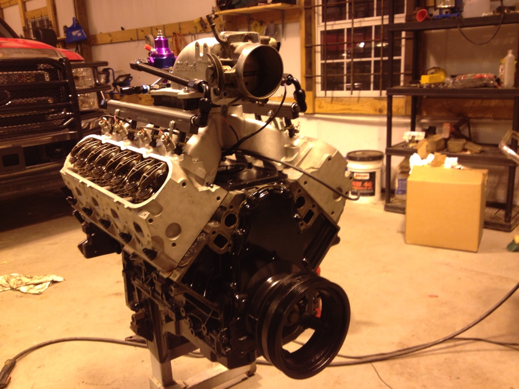

Injector harness, IAT, ECT and TPS harness done. dirt_track_racer_81 made me a custom fuel pressure regulator mount and I got the fuel lines for the intake done. Hope to drop this thing in the truck tomorrow or the next day and be tuning by this weekend!
