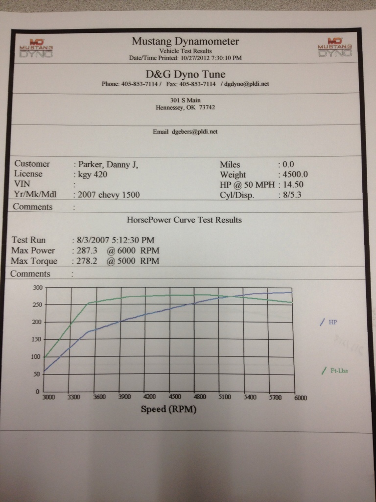

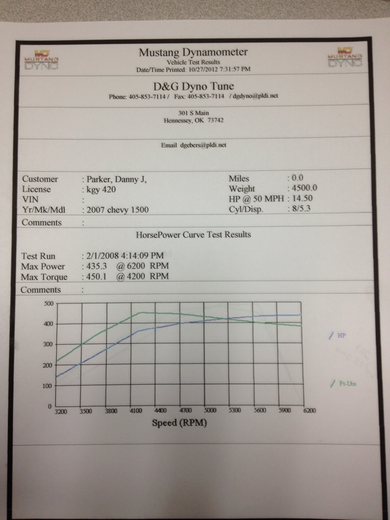

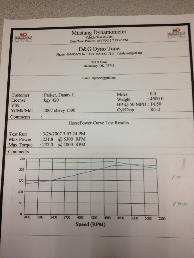

Was standing around waiting for Tyler's truck to cool off the other night so we could change plugs and started looking my own past dyno sheets. Pretty neat to see its progression(or there lack of lol)
Very first dyno ever. Bone stock, straight from the dealership to the dyno
After Tyler tuned it

5.3, 02 LS6 cam ground with 112LSA, home made turbo kit with little turbo and 10-12#

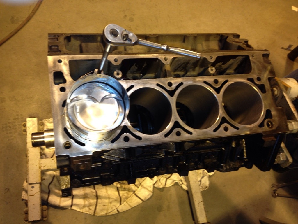

Got started putting the engine together last weekend. Special thanks again to Scruggs Fabrication and Engine Works
