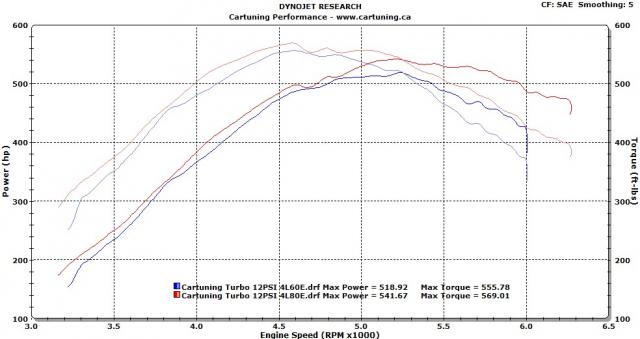

Alright, went to the dyno yesterday, what we did since the last dyno (blue line) was a 4L80E Swap, tuned it further increasing timing, the Alky works now (realized it hadn't been working for a while) and the boost is roughly the same. I say Roughly because last time at 45% duty cycle on the AEM TruBoost gave me 12PSI this time it was 11PSI at that Boost level so I changed it to 50% duty cycle and it went back up to 12PSI. Good peak gain but at 6000RPM it's up 60whp compared to before.
All in all we're VERY impressed by the numbers, was expecting loss in power with the 80E but looks like all the extra street tuning over the past few months have worked out. Not bad for a bone stock 5.3L (only have valve springs in there). We're going to hit the track then I'm going to throw in a Cam and see if we can't get her up to 600whp.
Blue Line - 4L60E, 12PSI
Red Line - 4L80E, 12PSI

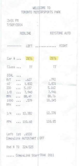

Little update, went to the track on Sunday, it was Mopar day with T&T but was only able to get 3 runs in so hard to make changes etc. but my last 2 runs were very close. I'm pretty happy with the results, this was on a 6Ply 275/70/17 tire with 30psi launching in 4x4 and full street weight, I didn't even take the tools out nothing.
We're gonna go back in the fall when it's a bit cooler to see if I can improve on this time. I have a video just have to upload it but I think i was pushing through the converter on the launch we were seeing a lot of converter slip and on the video the truck doesn't really leave very fast at all.
