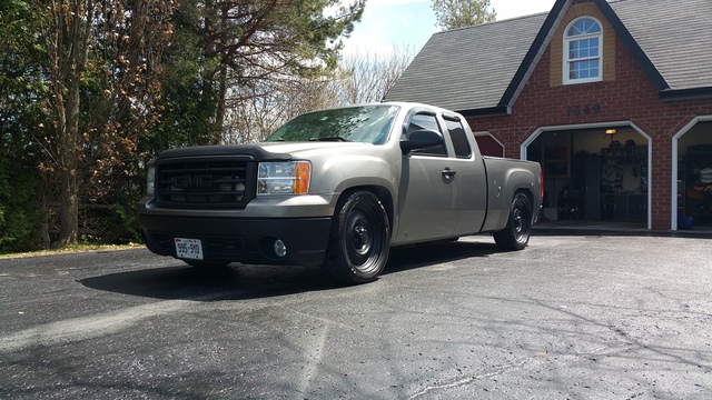

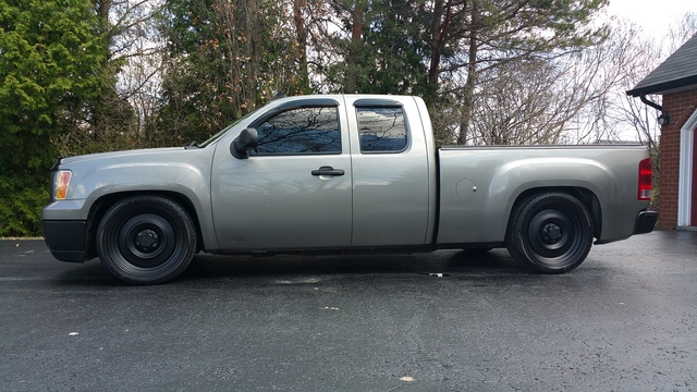

Update on the truck, haven't really done too much, I had it parked for the winter but back to driving her daily now, I lowered it a bit more to 4/6, got some 22" transit Steelies and had them powder coated matte black and added some 285/40/22 Falken STZ-05's. these wheels are HEAVY lol I'm getting some helper bags in this week so will install those shortly so I can actually use the box to carry stuff. I also got in a TruCool 40k that I haven't installed yet but will be doing that at the same time as the bags.
I wanted to do a Cam this summer but looks like that will have to wait till next year, all my mod money is going to having my basement waterproofed
