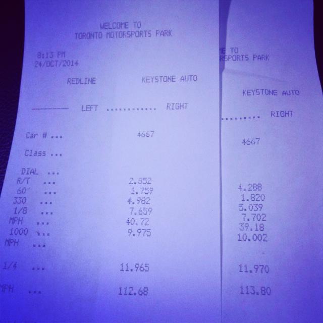

Update time!!!
On Friday night it was cool and not busy so was a perfect night. I showed up and did a 12.006, then my next run was 11.965, I was very happy but I knew I needed to back that up with another sub 12sec run so I did a few more runs and hit another 11.97, SWEET, even the guy handing out time slips was rooting for me.
That run also had a worse 60ft time + right at the end of the track I felt the truck lose power a bit then pick back up so she has more in her for sure. Might need to change out that stock Flex Fuel Pump I'm thinking. I did about 6 runs and had no knock at all, overall a great night.
Here's the slips and a video, sadly didn't have the best camera for night time shooting but you get the picture

Bad *** man lovin it!

Congrats!!

Need to update that E/T & MPH in your sig!! Good job.

Thats awesome for a stock 5.3!
Was that in 4WD like previous runs?

Thanks all, yeah it was in 4WD and I kept it in 4WD the whole way down, I thought of trying to switch it into 2wd after it shifted into 2nd but didn't want to risk it (is there even risk to doing this, I don't know?)
I will update my sig now
