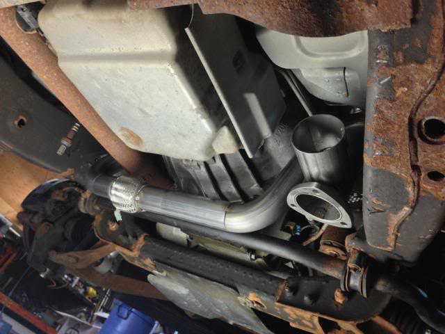

Crossover and downpipe, also see where the cutout will be. There will be a vband here and then there will be a cat pipe from here to the exhaust flange so the cutout will be right before the cat, which is what you want of course.

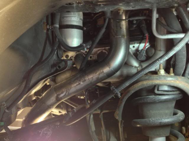

With this turbo placement makes for a pretty easy charge pipe

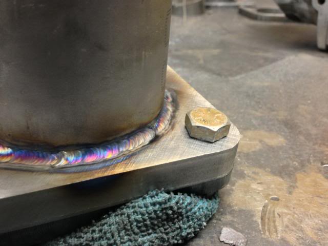

Weld sexyness

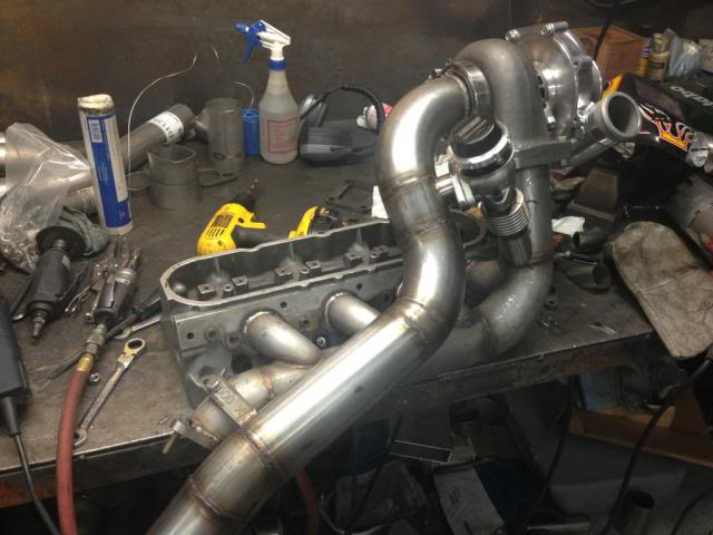

Turbo placement
Only thing not in the pics is the wastegate which will be just before the turbo and vented back into the downpipe.

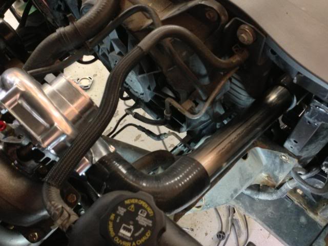

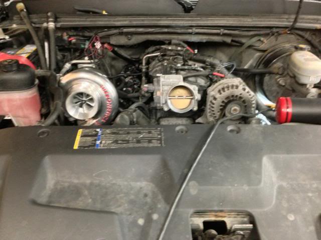

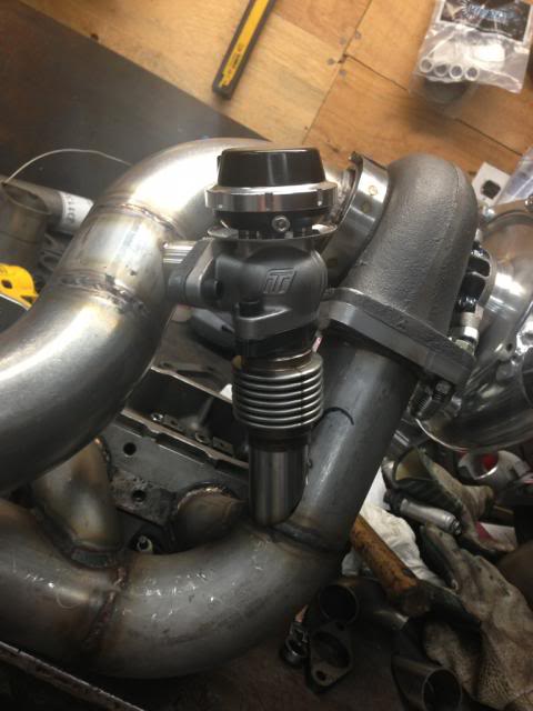

Here's some pics of the assembly with the wastegate:
