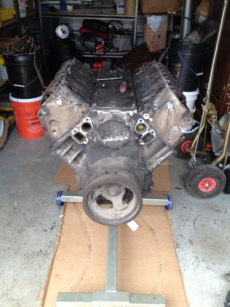

I was able to drill the bolt and remove it with a easy out.

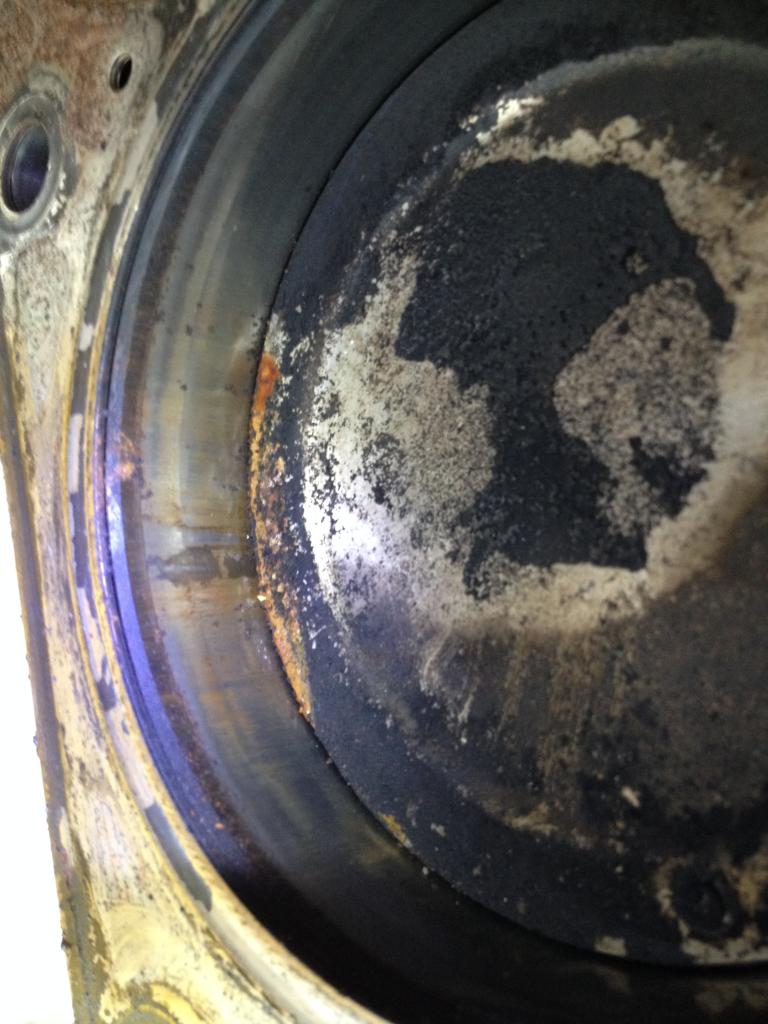

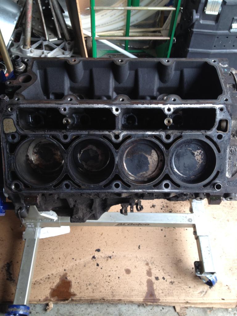

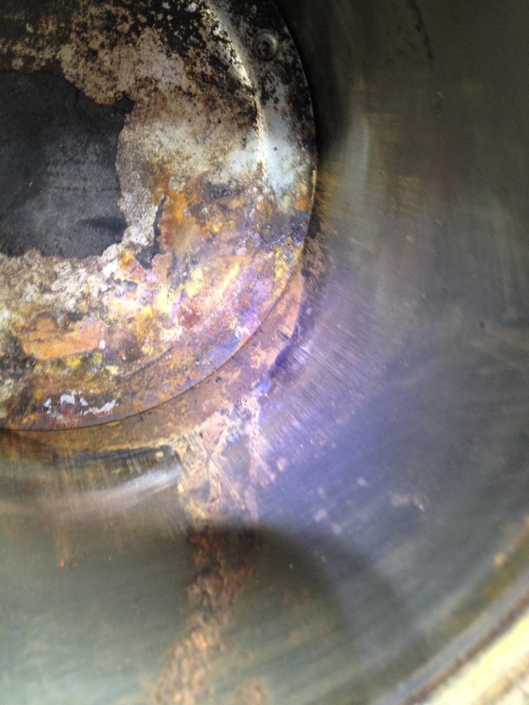

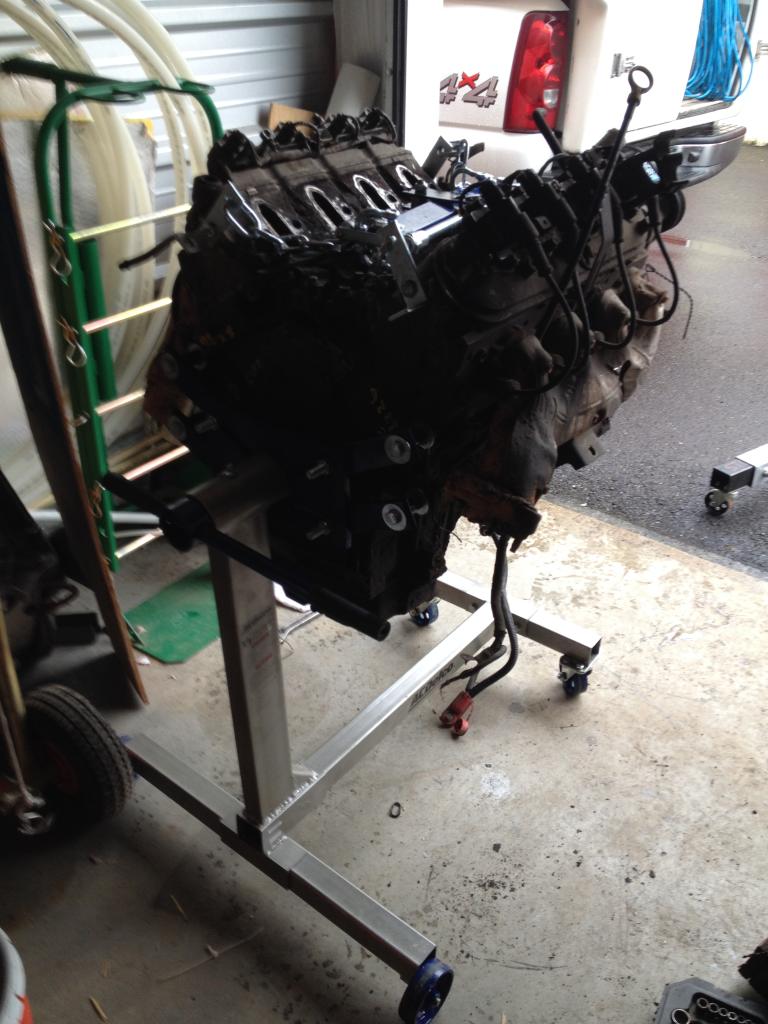

Made some progress on tearing down the engine today, it looks like there was some water sitting in the number 6 and 8 cylinders.

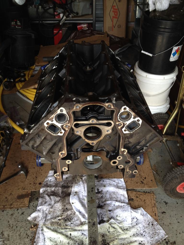

made a little progress, the block is ready to go to the machine shop.
