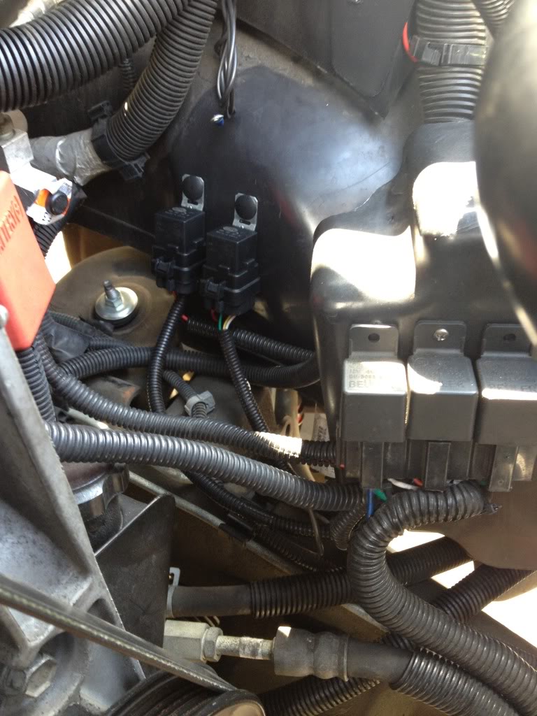

Made a lot of progress yesterday
Modified the cooler lines and got them routed and secured.

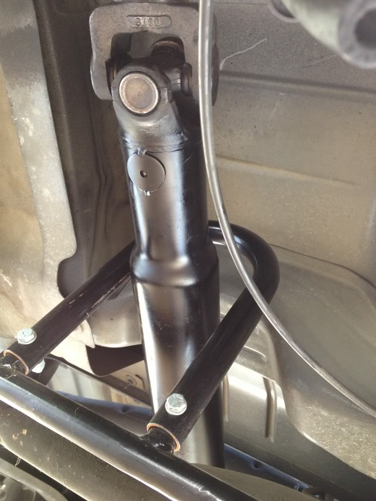

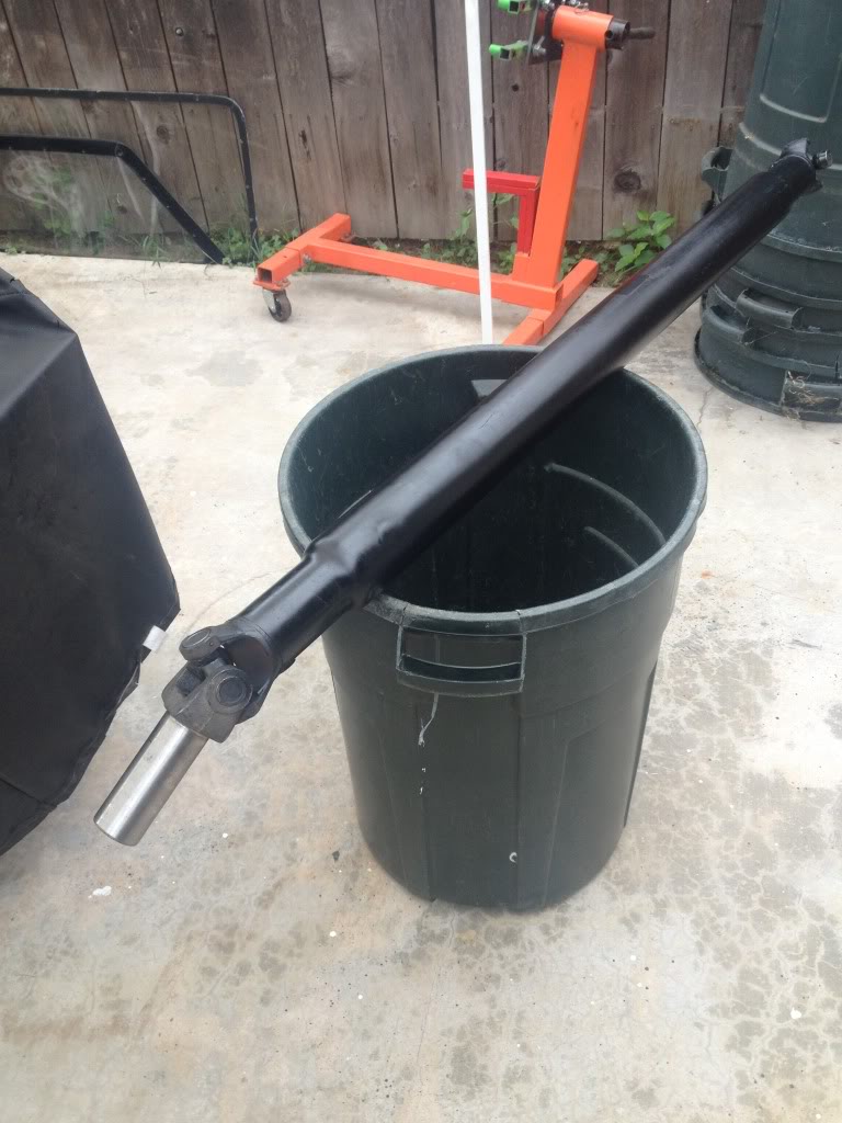

Picked up the driveshaft yesterday morning and got it installed. Had the shop swap the yoke to the 4L80e piece, New U-Joints were installed and it was high speed balanced.
Driveshaft loop is back in.

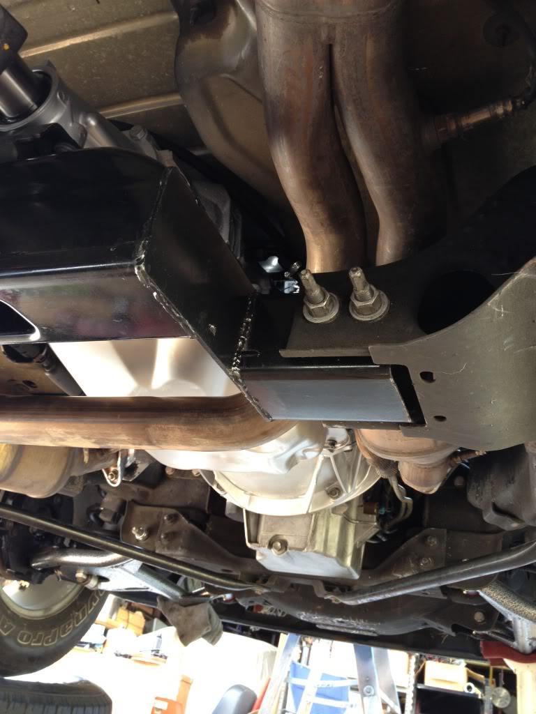

Got the Bassani Headers back in, Y-Pipe and exhaust bolted up behind them.
Misc little things done under the hood. Modified the EVAP hoses to work with the NBS purge solenoid (Cause I didn't want to shell out $13 for the nnbs one )
Plugs, wires, Part of the intake tube, etc.

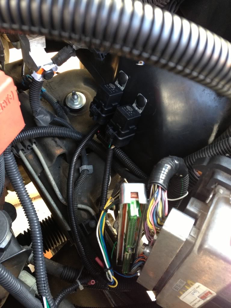

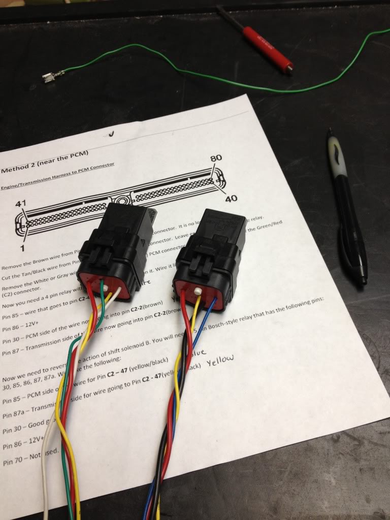

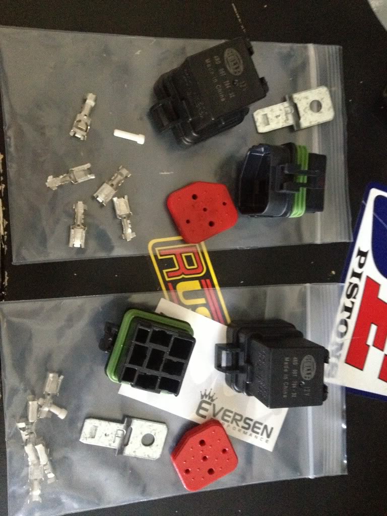

And began the 80e wiring. I am not going to be doing a segment swap. i'm going to run the trans on the modified 60e segment and relays.
Found some nice 5 pin weather pack relays on ebay and made my own harnesses for them.
Got them mounted and made my connections.
All that I have left is get my x link installed and work on the tune and she'll be ready for an alignment and the 'break in procedure'

Just finished up the relays. Now I'm just waiting on ups tomorrow and i'll be able to fire her up. Now to do a serious detail job. This thing is absolutely filthy.
