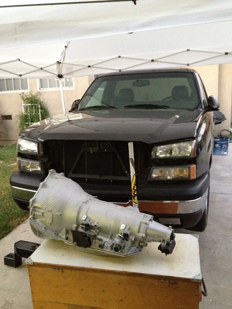

At this point I was undecided weather or not to rebuild or upgrade. But I finally decided to go the 4L80e route. Sold the Circle D Converter and Picked up a core 80e a few days later. Then it was time to tear into it
Luckily there wasn't much damage in the trans besides a lot of clutch material. Ordered up a full rebuild kit and manual.

Trans all finished up and ready to go back in.
