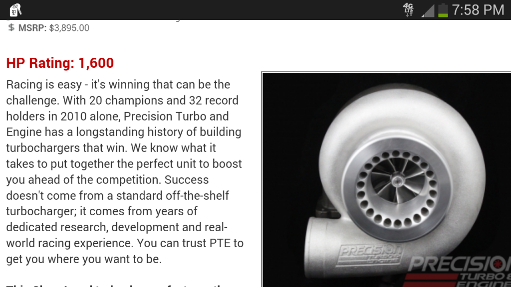

Startrd getting more progress done got rid of my old turbo decided to upgrade to this one

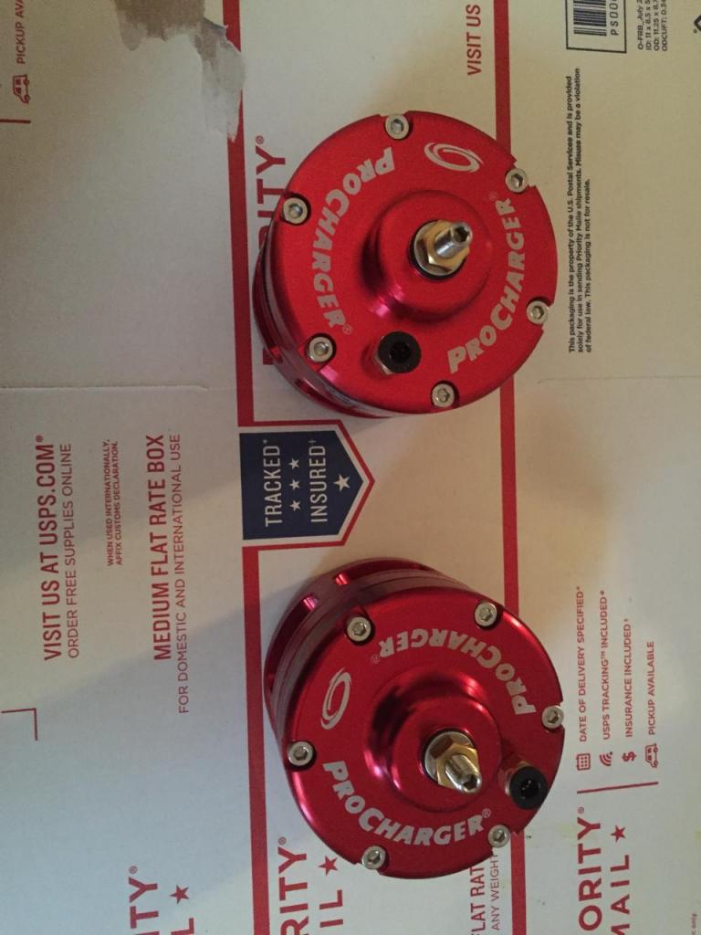

since I ditched alot of my old turbo parts picked up two procharger race series bov

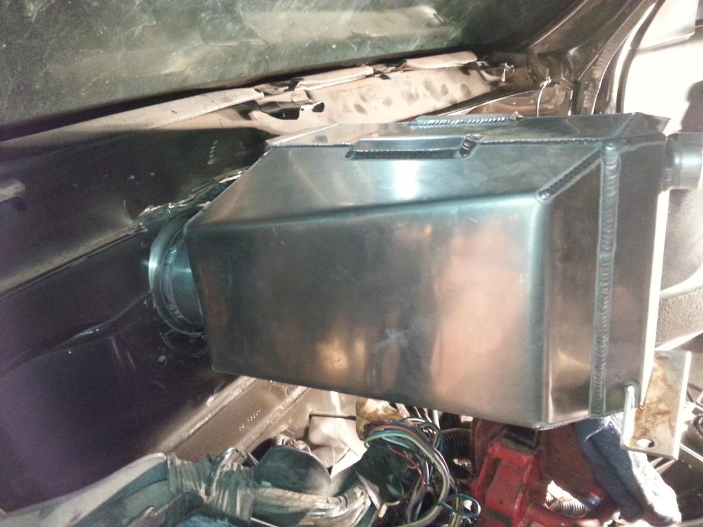

started to mock up the ice tank along with the chiseld intercooler

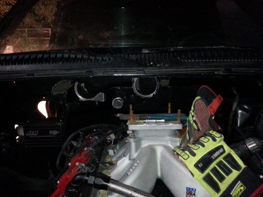

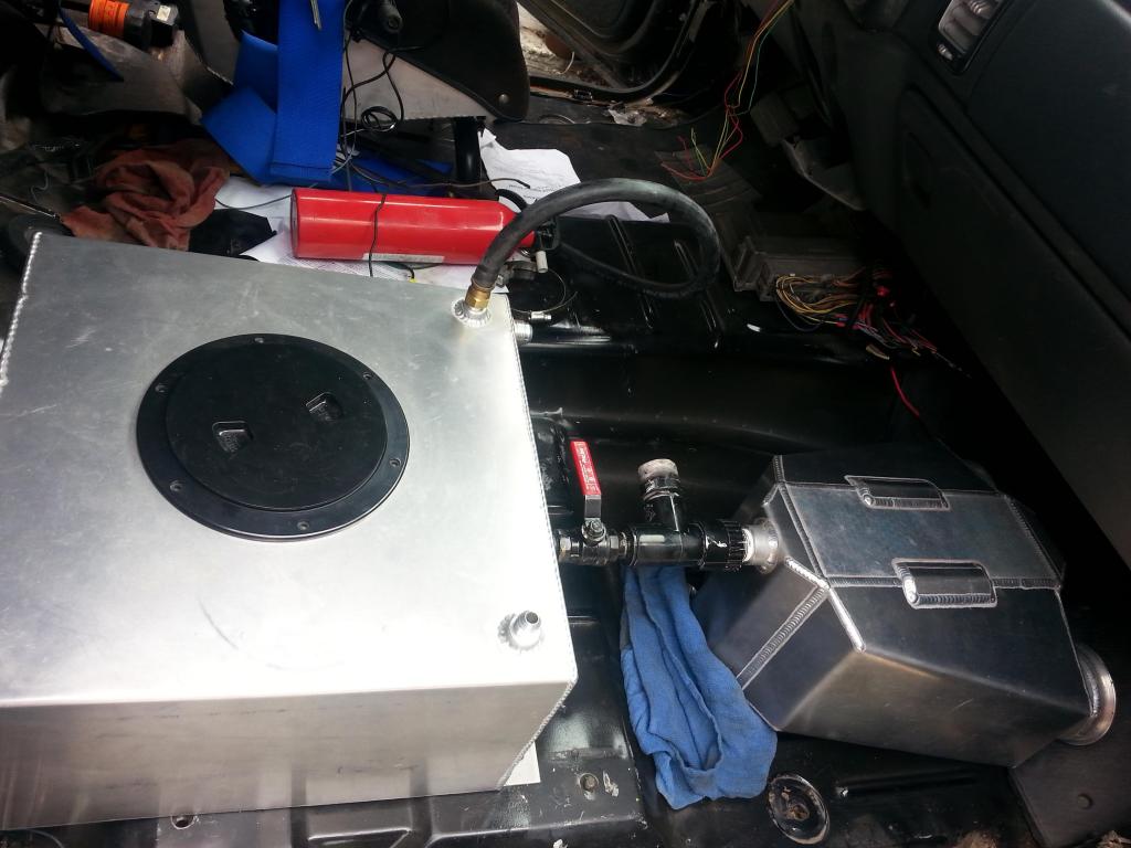

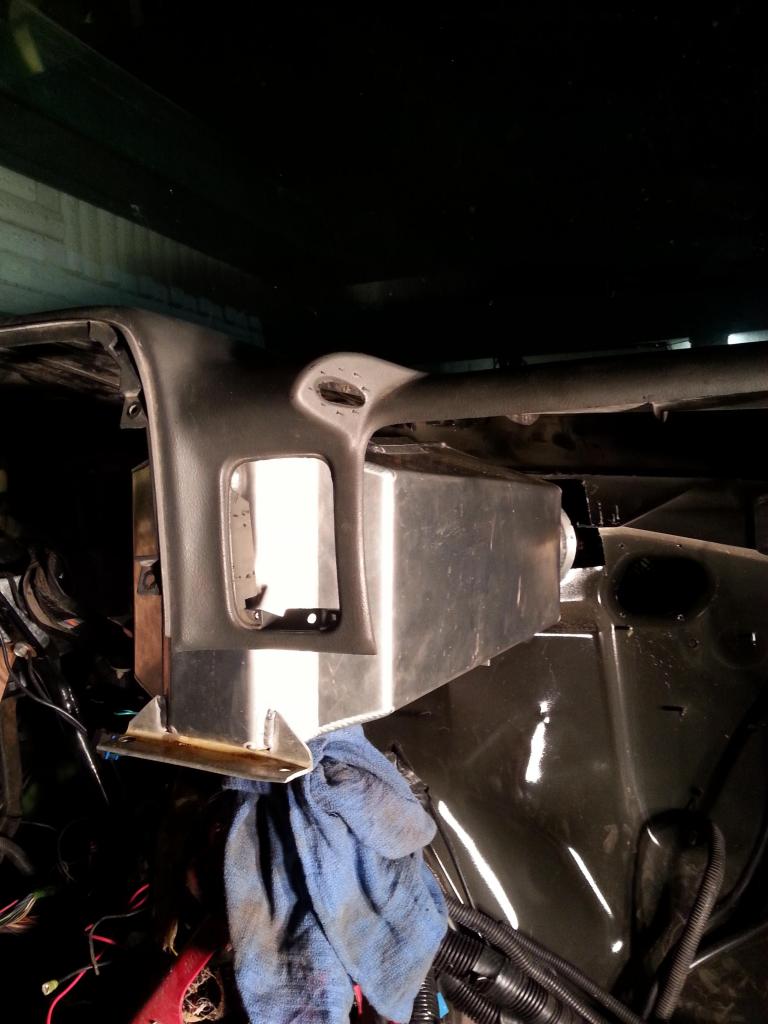

decided to change plans and run the cooler behind the dash and undecided if to run ice box in cab or bed here are some rough pics
will be updating as I go cant wait to finish this setup..
