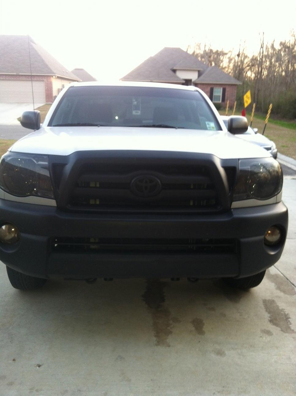

Im currently still in college, sooo this build might be kind of slow. I started about 3 months ago, soo this is to catch everyone up.

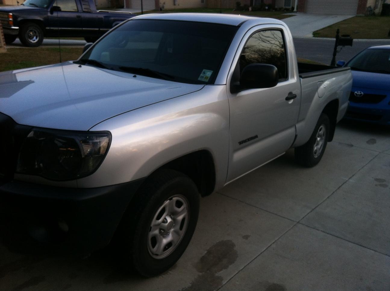

The truck is a 2007 Toyota Tacoma, 2.7L with 5spd manual.
In the attempt to make the truck look less
I had my windows tinted, tinted the lights, painted emblems and badges matte black.
Attached Thumbnails JZzzNmyTaco Build!!-truck-side.jpg   JZzzNmyTaco Build!!-truck-front.jpg

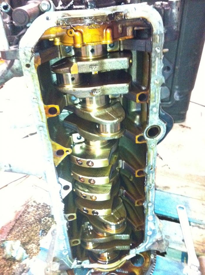

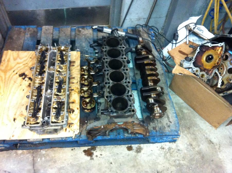

Since I was going to tear down the motor and rebuild it, I decided to buy a 3.0L 2JZ-ge from a 2002 Lexus IS300.
Picked one up for $400 and began to tear it down.
Attached Thumbnails JZzzNmyTaco Build!!-pic3.jpg   JZzzNmyTaco Build!!-pic2.jpg   JZzzNmyTaco Build!!-engine-tore-down.jpg

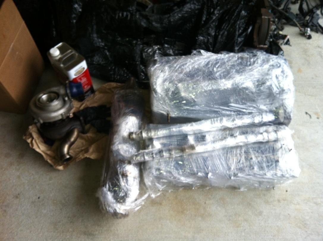

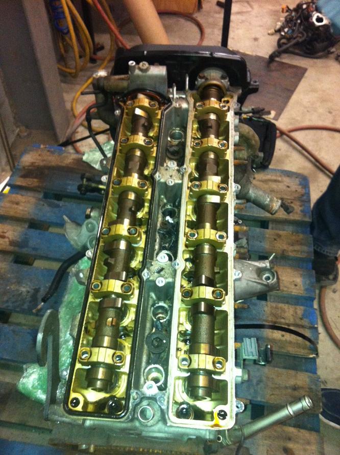

Alright so engine is wrapped up and im waiting on performance parts to get here so it can be shipped to the engine builder. My pistons and rods should be in early next week.
Just a short run down on the setup.
Bottom end:
2JZ-ge block
Stock crank
JE pistons 8.5 compression
Brian Crower 1400hp capable rods
Titan Motorsports billet mains
MVP Upgraded oil squirters
ACL Race bearings (main, rod, and thrust)
All ARP fasteners
Top End:
2JZ-GTE head
Port and polished
ARP head stud kit
Brian Crower oversized titanium valves
Brian Crower retainers
Brian Crower Springs
HKS Cams
HKS adjustable cam gears
