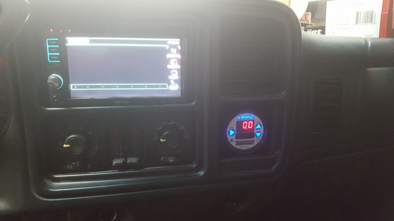

Just wrapping up the finishing touches. Took the truck out for a short drive the other day it rode smooth but noticed it had a mean chevy lean. The driver side was an inch higher than passenger side. I got the chevy lean spacer on it and it's all within 1/4" all around. I also installed the eboost2. Pretty happy with the install!

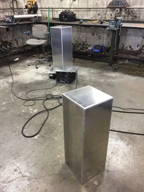

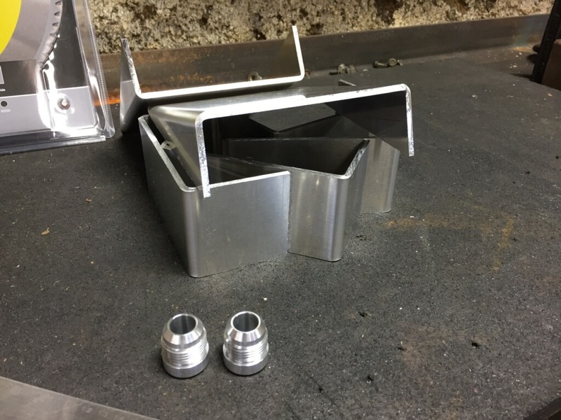

Should be getting my db rods cell this week. Planning on going -12 from sump to pre-filter and pump then -8 to rails and -8 return. Also ordered my magnafuel 4303 today
