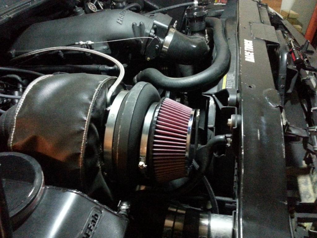

Looks like I am back to street truck status!

Old Jul 29, 2014 | 08:46 PM
  #439
oakley6575's Avatar
Joined: Dec 2010
Posts: 5,235
From: Las Vegas, NV
But it isn't black
Old Jul 29, 2014 | 08:48 PM
  #440
Atomic's Avatar
I have a gauge for that
Posts: 16,282
Likes: 438
Yea I dunno if I want to spray paint the filter....thought about it though
