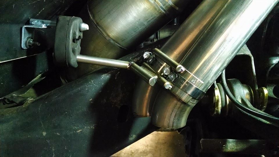

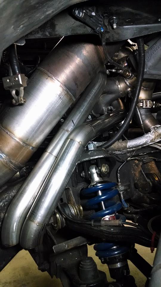

Please explain the dual gates... Is it for more accurate boost control or multiple stages?

With one gate the least amount of boost I could run was 20psi even with the gate wide open. I wanted 2 gates so I could turn down the boost.
