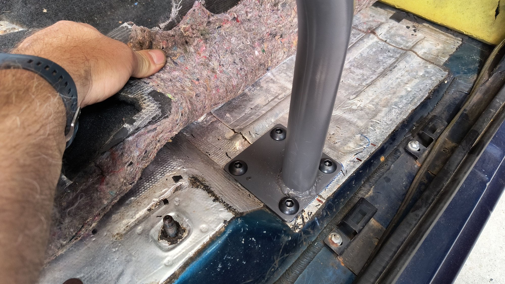

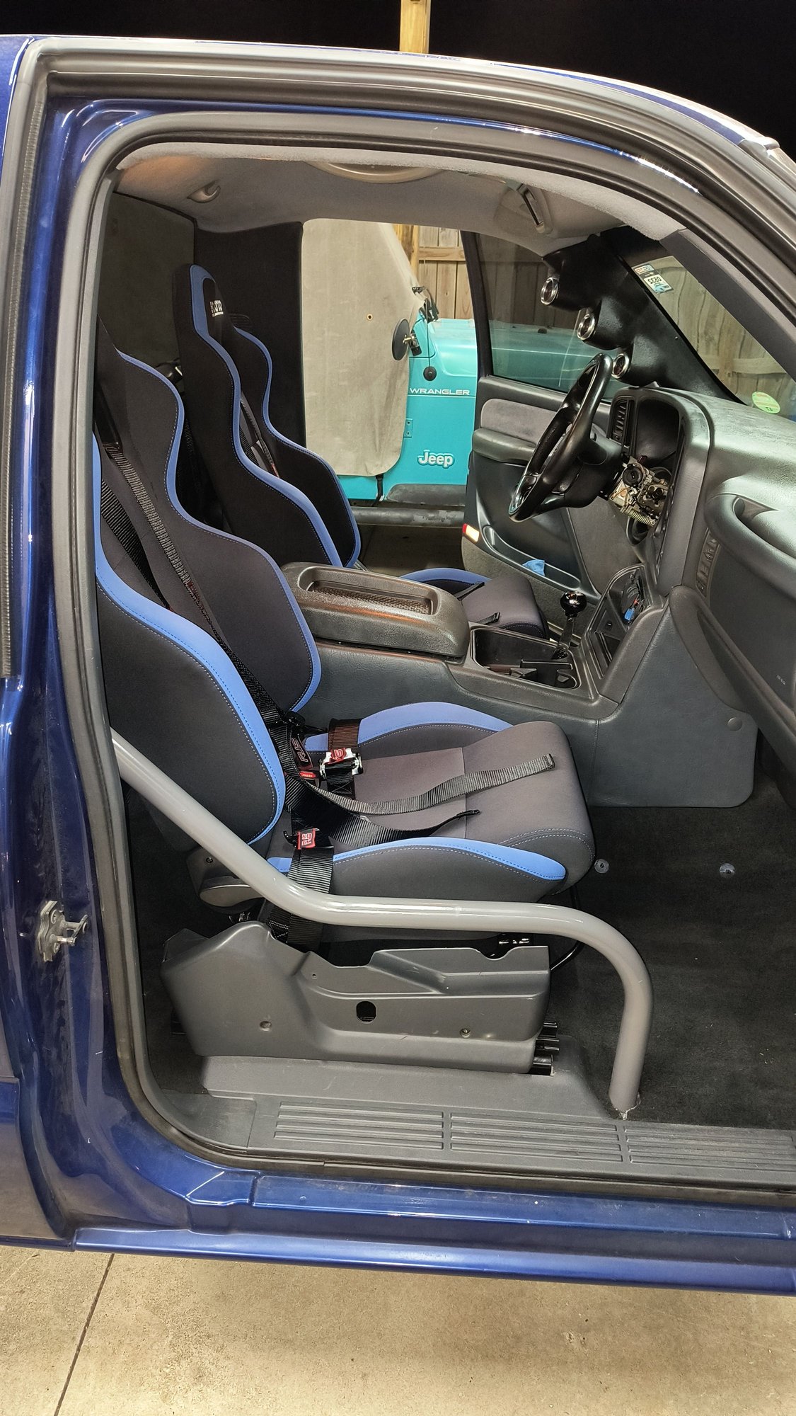

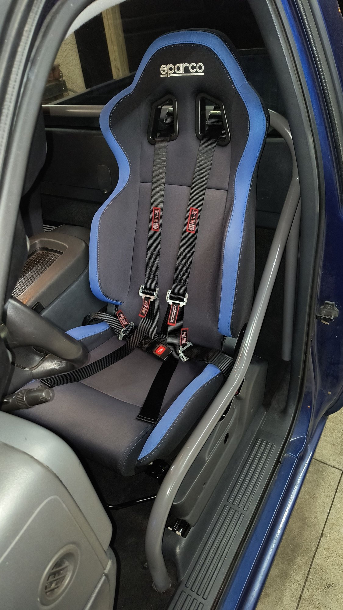

Harness bar is complete and installed. It was a lot of work, trial and error getting it to fit the way I wanted but I am pleased with the results for my first attempt. Well, except for the paint color. The cap was an exact match to the interior trim but dried significantly lighter. I do plan to get some vinyl to wrap the door bars, as I can already tell the buckles are going to chip it up if not super careful, so can do some color correction there.
Final fitment before seats...

How did you attach it to the cab and or frame?
Old Feb 12, 2025 | 12:51 PM
  #257
BigKID's Avatar
Joined: Dec 2001
Posts: 4,947
Likes: 242
From: Panama City, Fl
Currently bolted to cab floor only with 4x4x3/16 plate and 4-1/2" bolts at each attachment point. One race I do every year, rules would put me in a different class if attached to frame. I am not sure how much stiffer it would make the frame at those four points anyway. Solid cab mounts would likely work as well and not break the rules. I am confident this is as strong or stronger than the seat integrated restraints in the event of a crash. However, I am considering reinforcing the underside of the cab floor at the attachment points.

A backing plate would help a ton.
I agree. Next time I break out the fab tools for the pending rear suspension work, I plan to cut out some backing plates.
