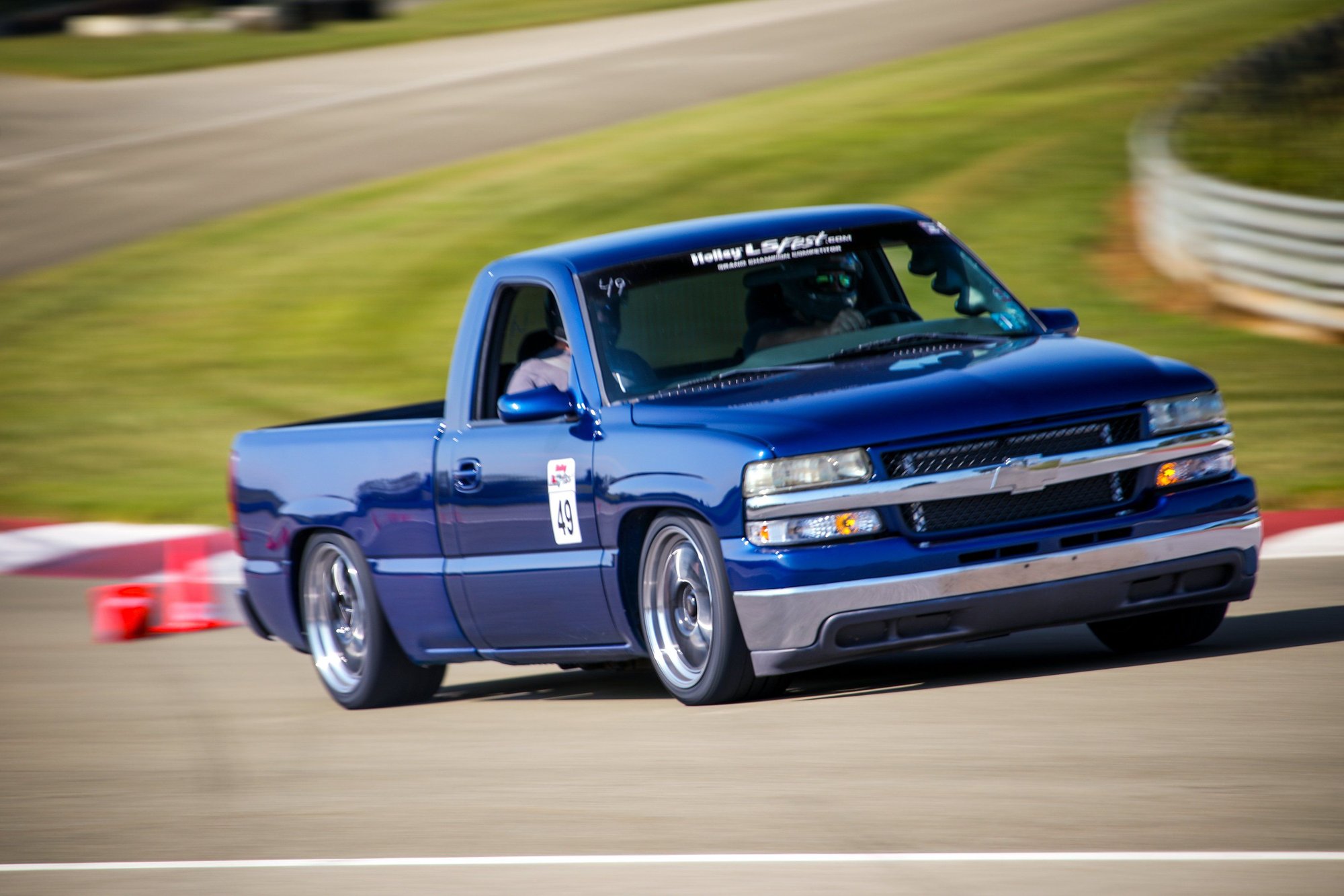

Next event was LS Fest in Bowling Green. The front end changes made the truck much more responsive and easier to push into the curves with confidence. I felt I did better on the curvy driving but straight line traction was still lacking thus doing poorer in the drag and 3s portions that I wanted.
However, I did get one of my favorite action pics on the TrackX portion at NCM...
