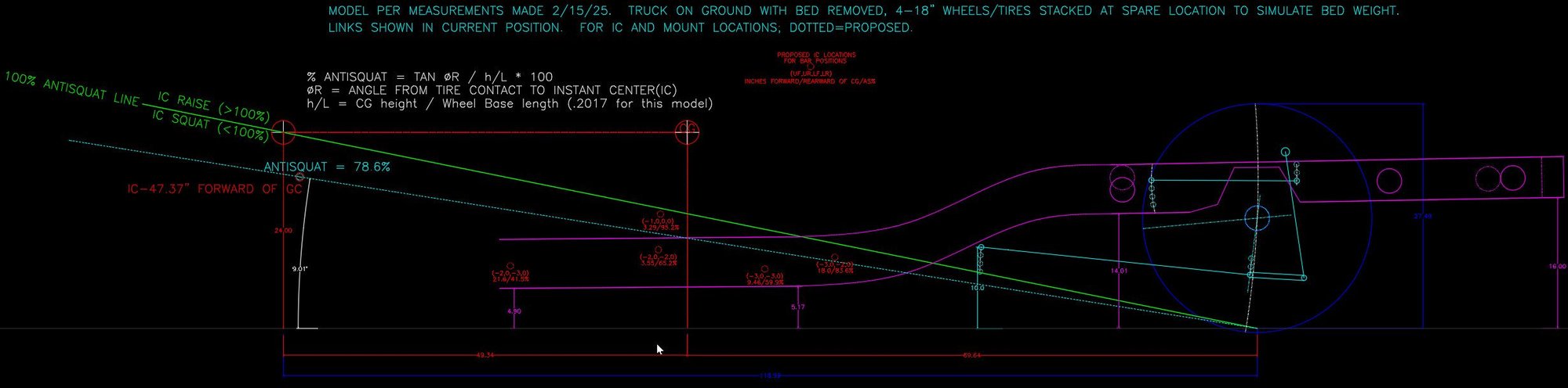

Had my first event with the new seats and harness at the Pro-Touring Truck Shootout at Beech Bend Raceway last weekend. I like the extra containment, however due to environmental conditions and truck issues, I was not able to push hard G's for a really good feel. Friday was cold and rainy so very poor track conditions coupled with done tires makes for some slippery runs. I went one-n-done in the shootout Saturday so didn't get much seat time in the nice weather.
I have also been working on a new rear suspension design. Hopefully next event will be on new suspension and tires. Looking forward to some extra grip.
Just a preview of the suspension mapping. Converting the wishbone to an adjustable offset 3-link will provide better IC positioning (ie anti-squat/grip) and a much lower rear roll center with the panhard bar providing more lateral weight transfer and grip and reducing rear oversteer.
Wishbone to adjustable 3-link model

I got the 3-link conversion done just before going to LSFestTX a few weeks ago along with a new set of Falken 660+ tires. The truck seemed to turn in better (more tires than suspension?) but the big improvement was in corner exit. I will take more power coming out of a turn and also seems to hold sweepers better at speed. Straight line acceleration from a stop didn't seem much different when testing with the old Goodyears considering the IC was moved quite a bit rearward and AS raised to 99%. This is where the 660+ improved instantly, even more once scrubbed in. I can't wait to get more seat time to get confident in the new setup then start making adjustments to see what changes.
Model of new geometry...

After a few more events, the new rear suspension is working well. Went to a local SCCA event and took 1st in CAM-T. At LSFest East the truck did really well despite rain one day and managed 8th out of 42 overall in the truck class. Straight line traction from a dig is still a bit lacking but worlds better than it was. The big difference is in rear corner grip, especially on exit. Before when pushed to the limit, it would snap oversteer. Now, when it starts to step out, I can throttle steer and recover it without getting out of shape.
