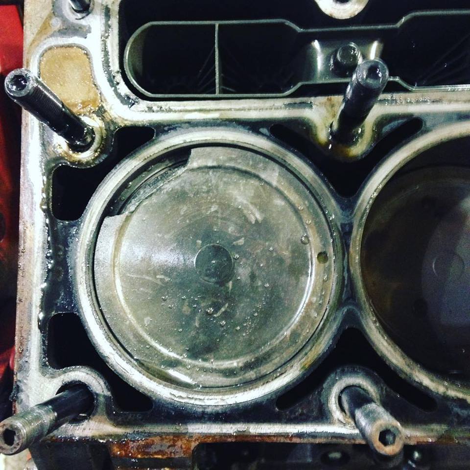

broke a piston like i kinda figured luckily my cylinder heads are ok

way less destruction than I predicted when I heard "rapping like tupac"

Meth keeps them pistons looking clean!
I want to see the scoring on the cyl wall too.

yeah its not to bad only thing that sucks is the cylinder got scored pretty badly so its gonna need to be bored

That looks like the rings popped the piston. Did u have the gaps opened up? Ive never broke a piston but ive bent plenty of rods tho.
Totally!
You could eat off that damn thing.
The ring gaps were stock. Meth didn't come on, throttle stayed buried, and that's exactly what happened.

Looks like water was in that hole
