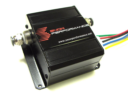

Don't you people use flow sensors with your meth setups? I ran one for a long time on my turbo car. I set things up so that if flow stops then I was limited to wastegate pressure.
Safe Injection Unit

Problem is there is no wastegate in the same sense with a blower...
Ohhh. You can tell I'm stuck in my ricer turbo days!
I guess with a centrifugal, or any type that doesn't mount to the heads you can easily use an electric valve/bypass/BOV to dump to atmosphere when flow stops?
This guy did it.
Innovate Stg1 Supercharger with W/M injection - Scion FR-S Forum | Subaru BRZ Forum | Toyota 86 GT 86 Forum | AS1 Forum - FT86CLUB
Just a thought.
