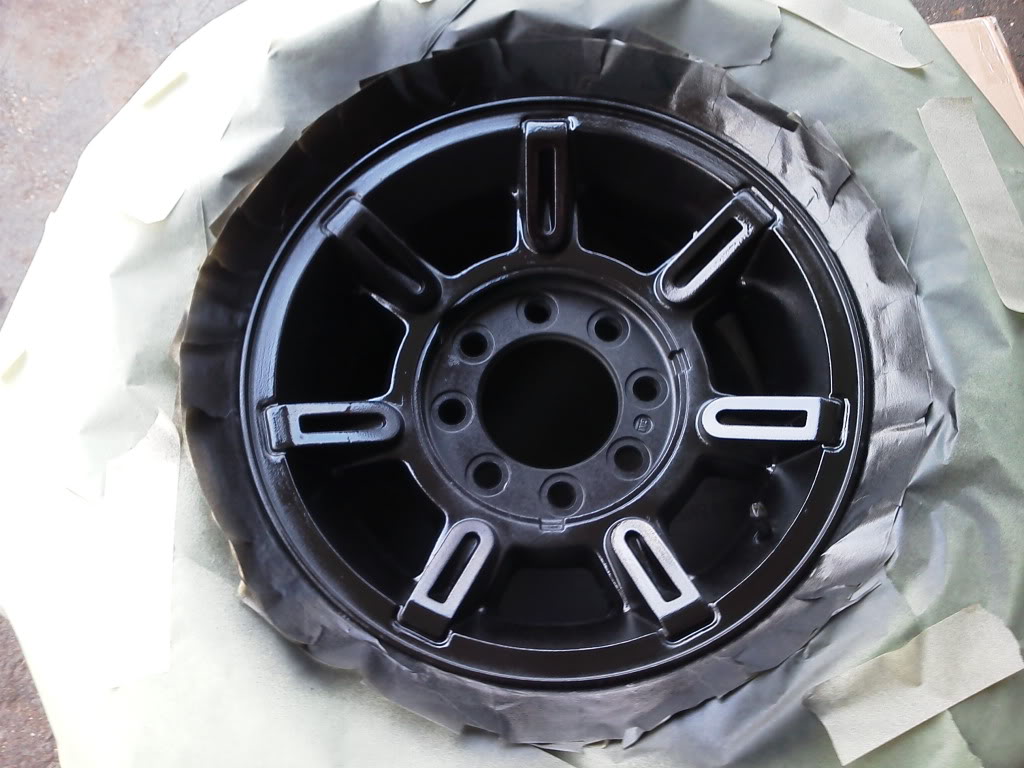

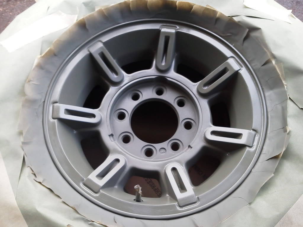

Sprayed one rim today just to see how it would work out. Not perfect but more than good enough for my daily beater.
Primered
Still wet with two coats of Rustoleum bedliner
More to come next weekend
Primered
jk you dont have to put it up if you dont want too
