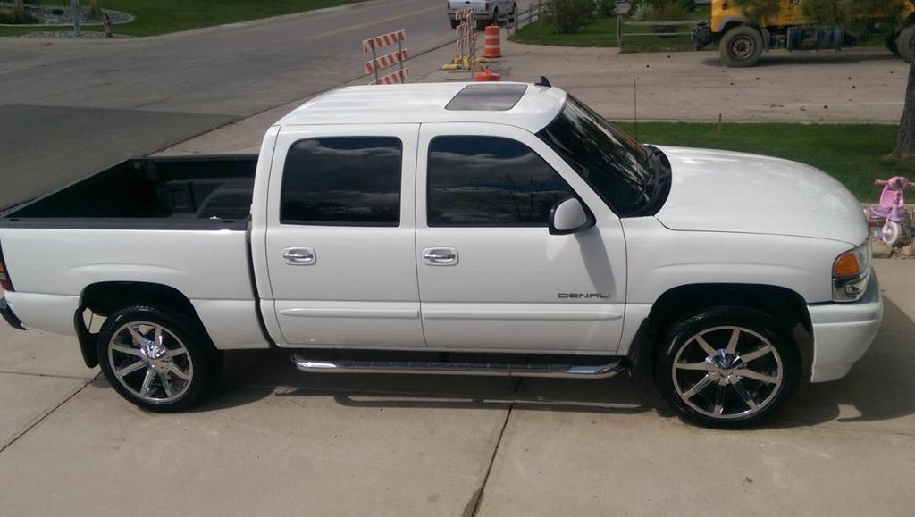

Pic of truck:

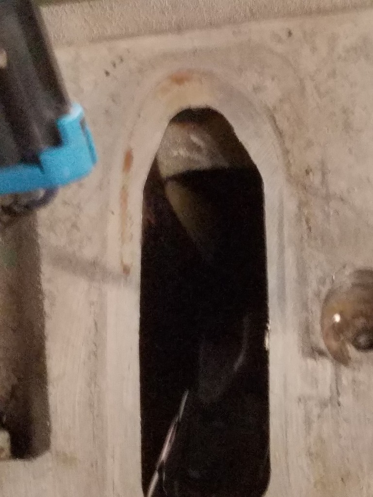

Only one carnage pic until it's out lol, yes that cylinder is full of oil. Not counting the 10 Oz I dumped out of catch can, and the other quart I dumped from my fast lsxr-t

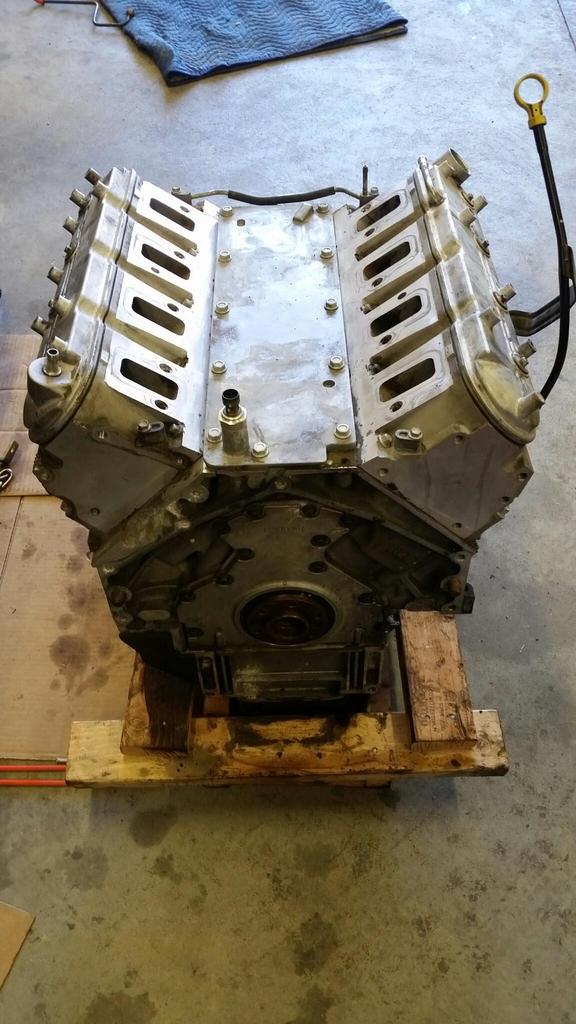

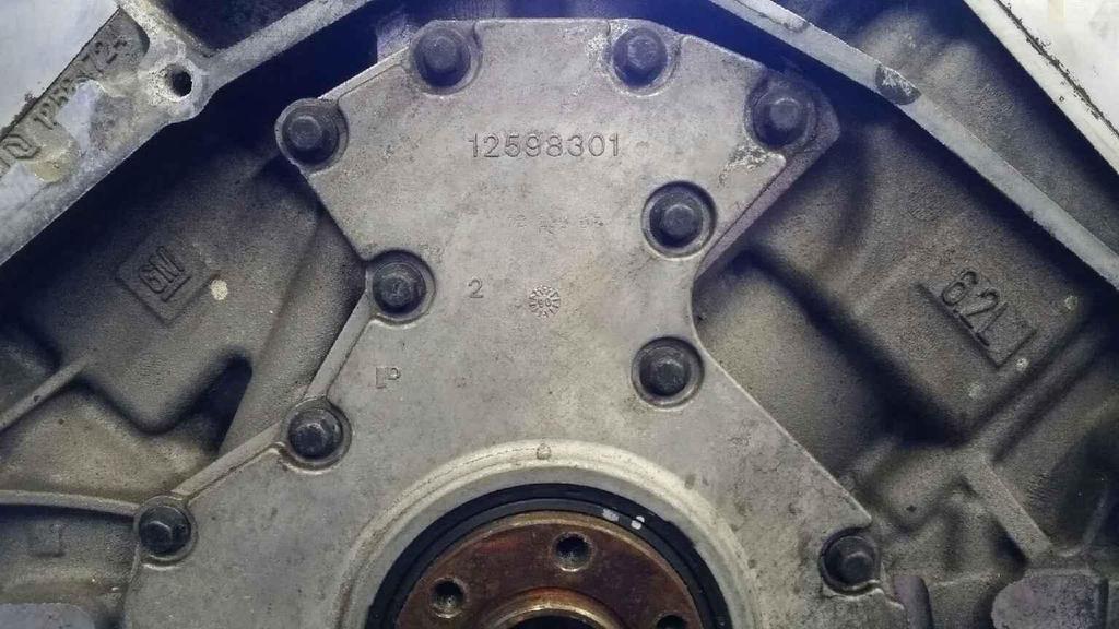

New motor, pics of it before clean up, cam swap etc.

He isn't going through bearings etc. Basically shortblock is being left alone. By the time a machine shop took the crank out swapped rings, then assembled it would likely more. Plus I don't know if I trust someone doing it and disturbing everything let alone making sure the rings are perfect for timing.

Catch can got full and was over glowing into my intake. After emptying my catch can I didn't think to check intake to. Well over night it drained into the cylinder and that morning I decided to fire it up. Well it was short and sweet. After pulling intake off I dumped about a quart of oil out of it and #3 cylinder was full to the top. Now I know why it happened, I just don't know what caused the catch can to fill up in under one week of installing it. Yes it was hooked up correctly, I triple checked it. Catch can was mighty mouse.
