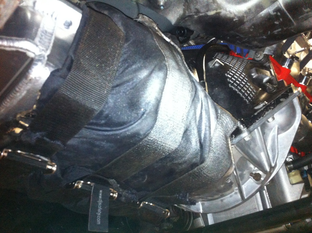

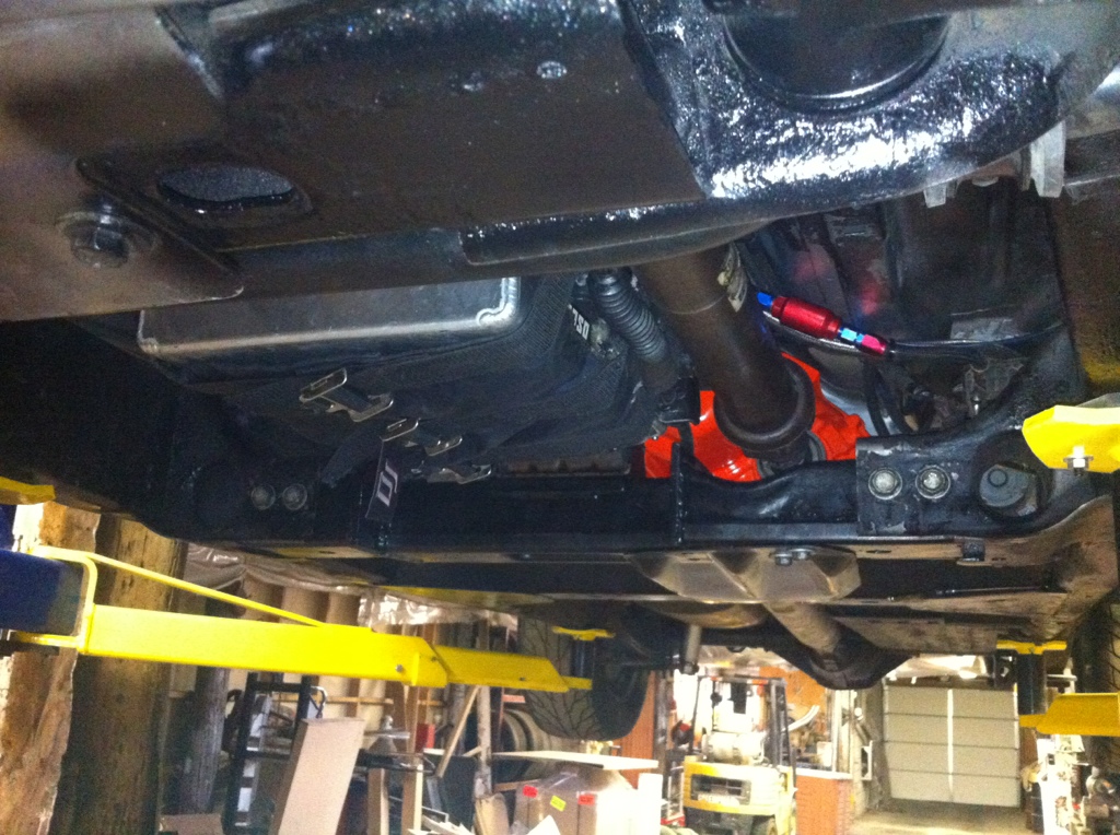

So after a trip to Dallas, I now have my freshened 4L80E with *hopefully* a perfectly good working transbrake. Everything got bolted together and installed. Here it is:

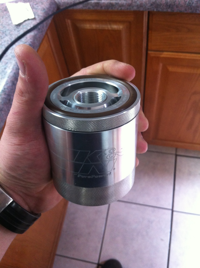

Also I'm very proud of this washable/reusable Oil filter.

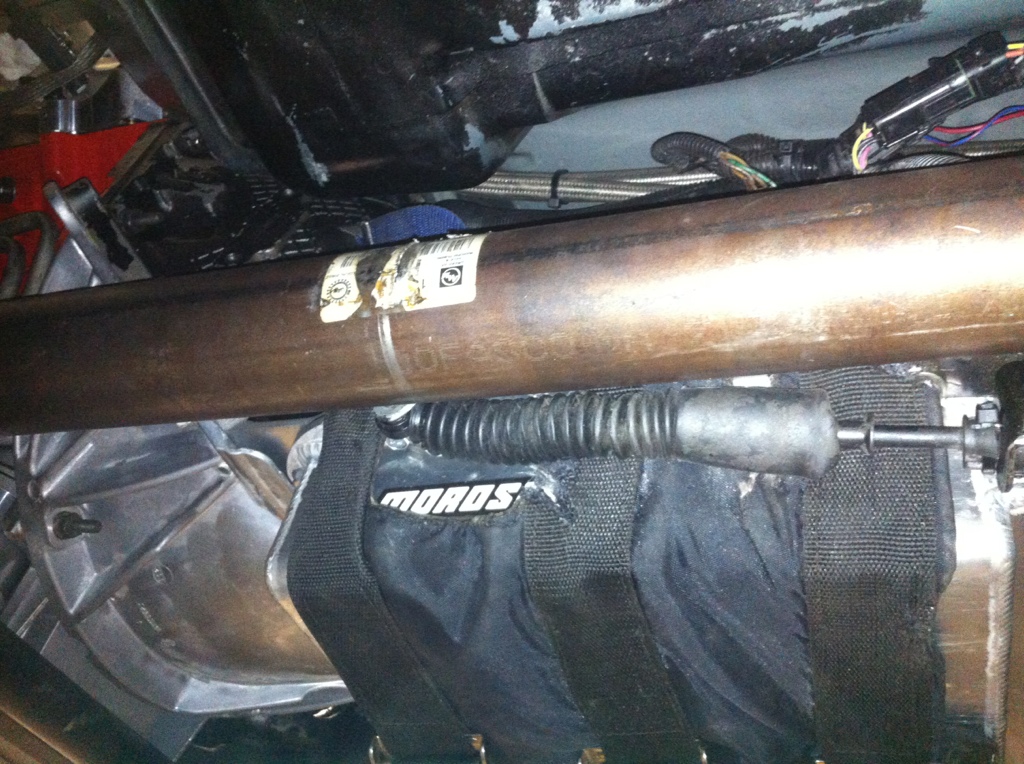

Old Jun 10, 2013 | 01:56 AM
  #242
smokeshow's Avatar
Mod with training wheels
Joined: Feb 2009
Posts: 7,741
Likes: 207
From: Detroit
Now that is a transmission.
Old Jun 10, 2013 | 10:04 AM
  #243
Atomic's Avatar
I have a gauge for that
Posts: 16,282
Likes: 438
Gilbert talked you into one of those trans diapers eh
Old Jun 10, 2013 | 10:17 AM
  #244
Gray Ghost Silverado's Avatar
Joined: Oct 2011
Posts: 389
Actually I requested one.
Old Jun 10, 2013 | 10:38 AM
  #245
Atomic's Avatar
Posts: 16,282
Likes: 438
got a part number?
Old Jun 10, 2013 | 10:57 AM
  #246
Joined: Oct 2011
Posts: 389
DJ-80101. It's actually for a TH400, notice my blanket has little sections cut out in places to clear things like dipstick, cooler ports, and additional motion of the shift lever if you were to drop it down into manual low.

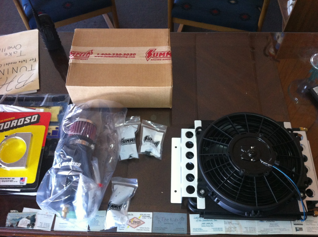

UPS just showed up again and brought me some more goodies. All the hardware I need for crankcase ventilation and new transmission cooler.

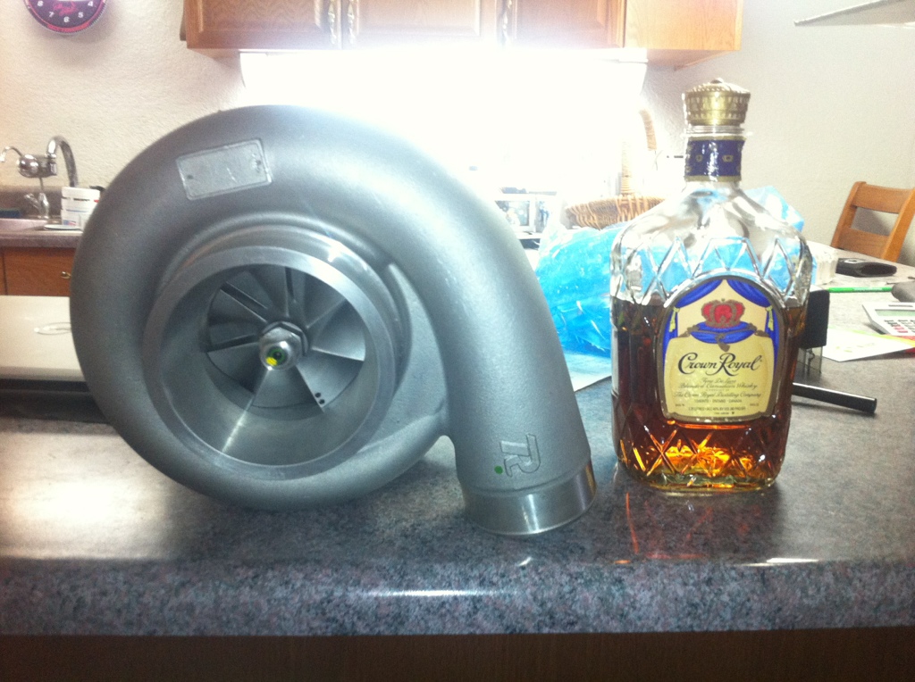

Continuing on now, it's getting closer!
New turbo is here: Name:  B81444BB-85A1-47EE-BFD9-C0B06A8480F3-3113-000002DDF0BB81A7.jpg
GT91/97 on the left, GT98 on the right.

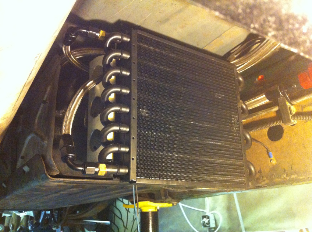

Trans cooler mounted, just gotta run the wiring and install the thermostat for the fan:

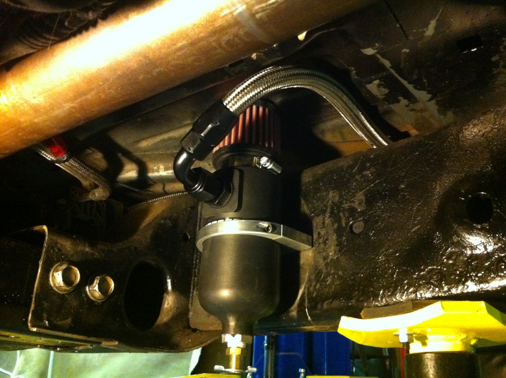

And breather tank is mounted, which consists of a single, baffled -10 vent directly out of the valley pan:
